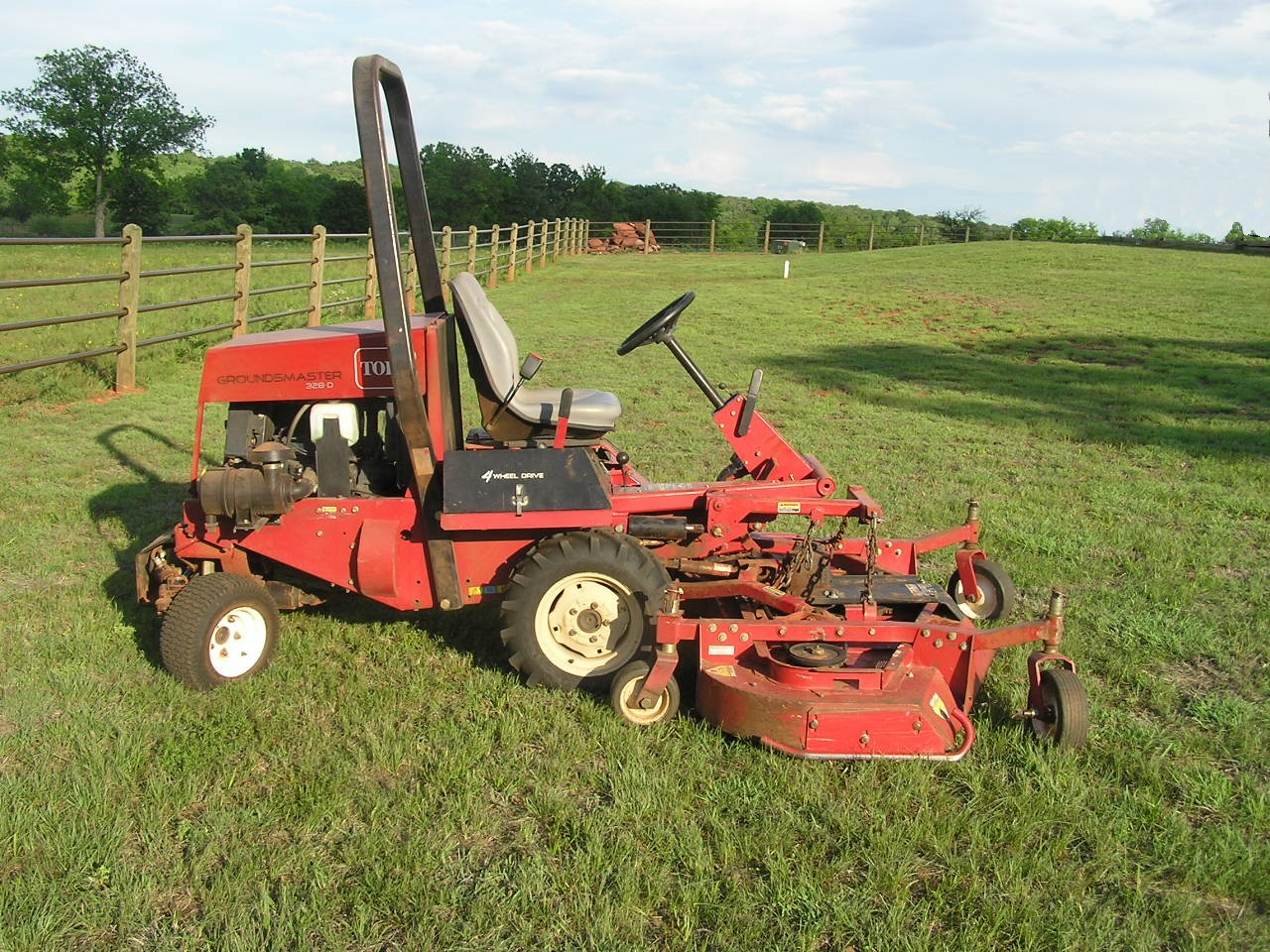

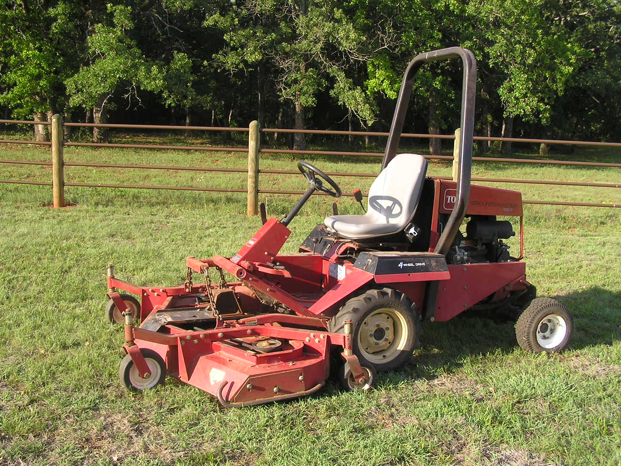

Not weird for me, but much better to use out front:
There is a huge difference between the frontal area in terms of swing on that Toro versus mounting it on a tractor. A converted rear mower put up front would stick out like crazy. Not to mention the OP would need a ballast. Assuming they have a KingKutter 72" RFM. That mower weighs about 700#. That would drag the front of that little B3200 around. Not something I'd want to do.
If you look at the Toro, it's actually 1/2 way under the machine.
Also, we use those Toro's at work, and a grounds crew rolled one on a small incline. I don't recommend using those Toro's or those 3 wheel Ferris' on rough/unstable ground.

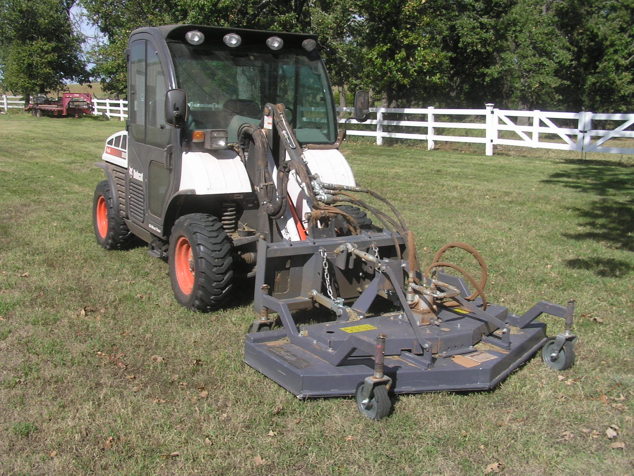

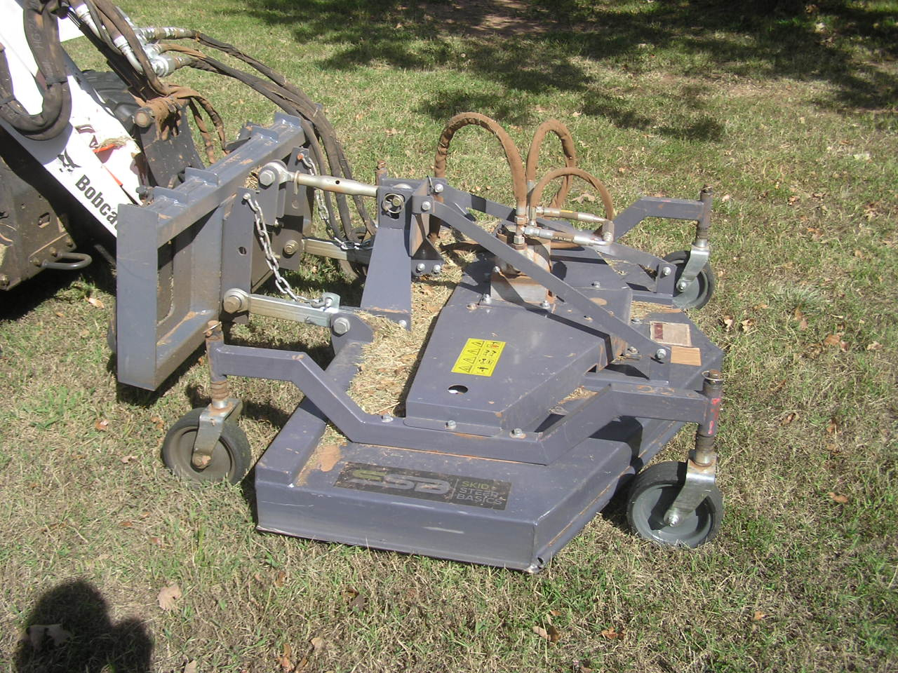

Yep, sticks out where you can see it. No problem with out front swing on a bigger machine with this 6' finish mower:
