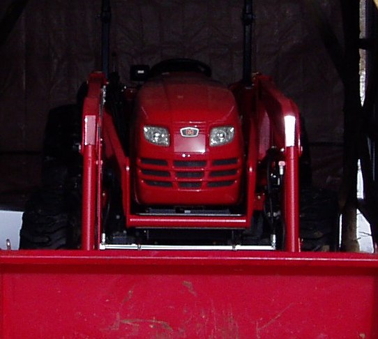

Has anyone modified the loader mount on a 4110 to add a brush guard? My grill got damaged last week when a root ball rolled over and a root snapped against the grill. I am thinking of adding three bars of 3/4" roundstock across the front of the loader frame between the two upright plates. I noticed when I measured the loader frame those plates are about 1/2" farther apart at the top than the bottom. I am wondering if I worked it hard enough to bend something. Would you build it as a seperate bolt in unit, or just weld to the loader frame? The picture is pre-damage, I just put it in for those who don't own a 4110.

You could probably weld a guard straight to the loader bracket, just make sure the hood has plenty of clearance.

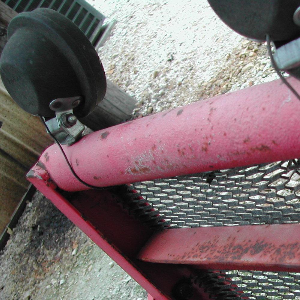

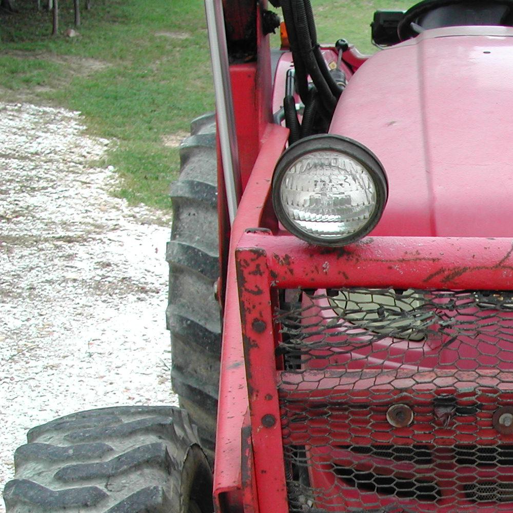

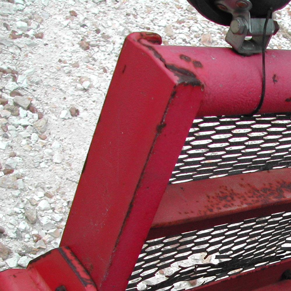

I bumped my nose on the side of my dump truck about 2 weeks after I got my tractor and cracked it, then I built a brushguard. I made my guard up with some scrap channel iron and some thickwalled round tubing I had. Made it to be a light tap-fit between the loader brackets and I drilled & tapped 2 bolt holes ( 9/16" if I remember correctly) into the loader bracket on each side and simply bolted my guard in. I used some fairly heavy expanded metal as a screen over the front of the guard. Got 2 utility lites (sealed beam in a rubber enclosure) on top of the guard to use as headlites - the stock lites are even more useless with the guard in place. The rubber fixtures allow the bulbs to pop out if hit hard, saving the lite. I've had this rig on there now for 5 years, have never taken the guard off since installing it, and have only replaced 1 lite bulb. Have had to straighten the metal screen out many times but no other problems.

Sorry it took so long to get the pics on here, you've probably already done something for your guards. Like I said, a very simple setup here but it has worked well. You want the guard out towards the front of the loader brackets so you can access your hood release. I just took my time and drilled & tapped the brackets with 9/16" NF threads. The two cross members are just scrap angle I had, along with the heavy-wall tubing at the top. A few small holes along the way to cable-tie the lite wires to. The expanded metal is attached with 1/4" bolts w/flat washers, I need to replace mine - it has been worked hard !!
