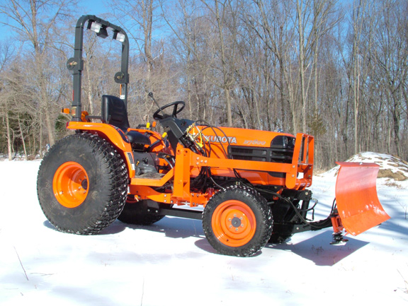

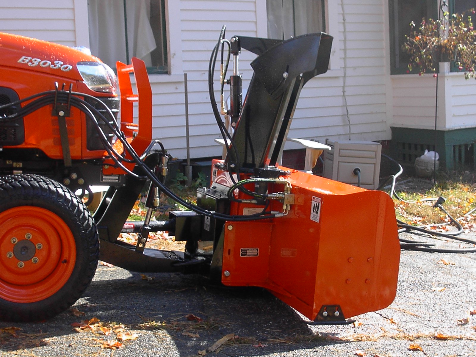

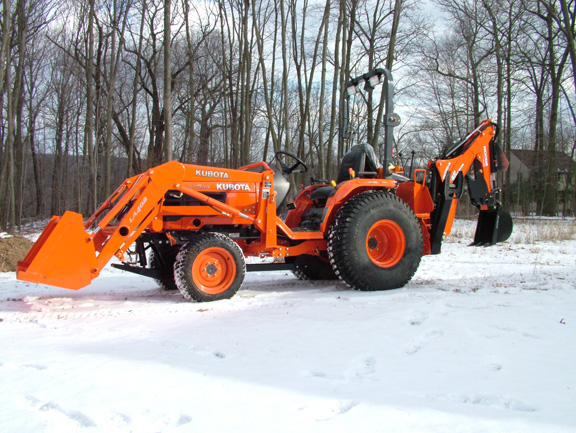

I thought it would be the 72" blade that went with the B3200, but I'm sure the 60" one wiill work fine. I'm interested in this thread too, partly just because there is a bit of frustrated dozer operator lurking in me somewhere. I have used one a little bit on a JD 3000 series in gravel, and found it to be a bit tricky to do level grading with. I think some practice would help a lot, and there certainly was no problem pushing loose gravel around. I just had a harder time making it level. On the other hand I seldom see even very experienced dozer operators going very fast until things are pretty well smoothed out.
It is my understanding that on the Kubota tractors the full loader frame can be left on while the front blade is mounted, and in use. I also understand that the front quick hitch can be left in place while the loader is mounted, and being used, but that clearances, both with the ground, and with the loader are small. Here is a picture, or two of a B7800 set up that might help you out........ thanks to the member that posted them some time ago. Oops, you said B3200...... let me take anogther look. As you can see, the sub frame is different, but the quick hitch is pretty much the same, and shouldn't cause any more issues.

Thanks for the insight and pics. They do also have a 72" blade, but for heavy use the narrower one would be better. When I am laying a finish grade regardless of the equipment I'm using I absolutely creep along. With rough excavating and grading I move along as quickly as the equipment will reasonably handle. Once I get the grade close I find it best to do the final grade in one pass (I use a laser level with a receiver I mount on the blade.)
Good to know on the subframe vs loader frame, that was something I was wondering about.
