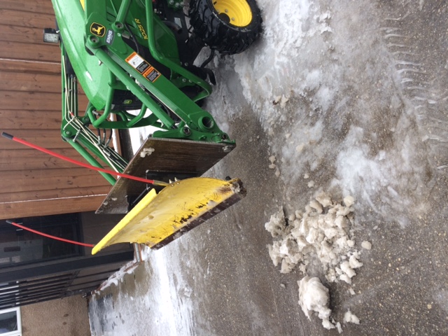

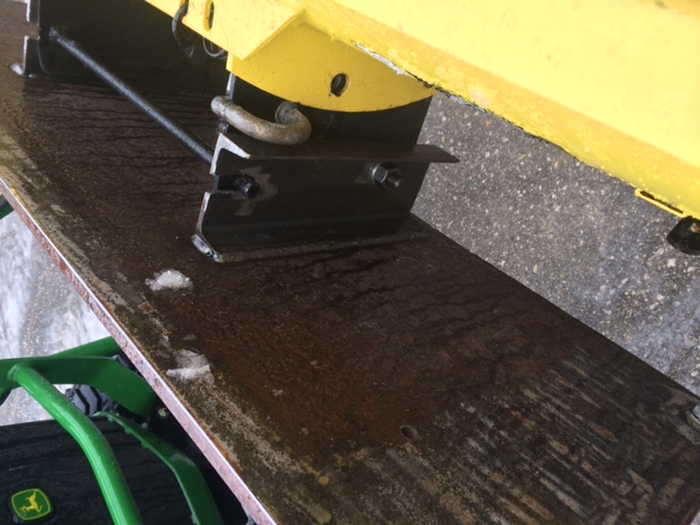

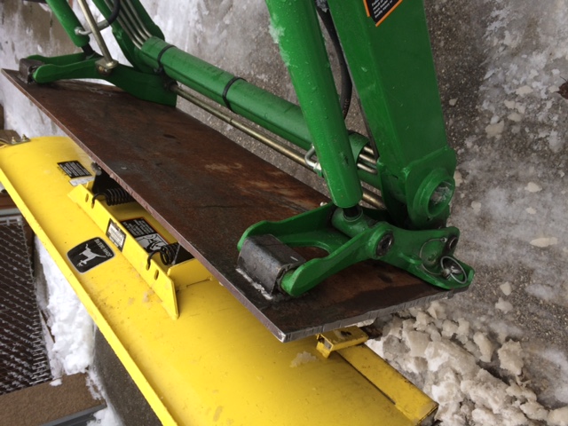

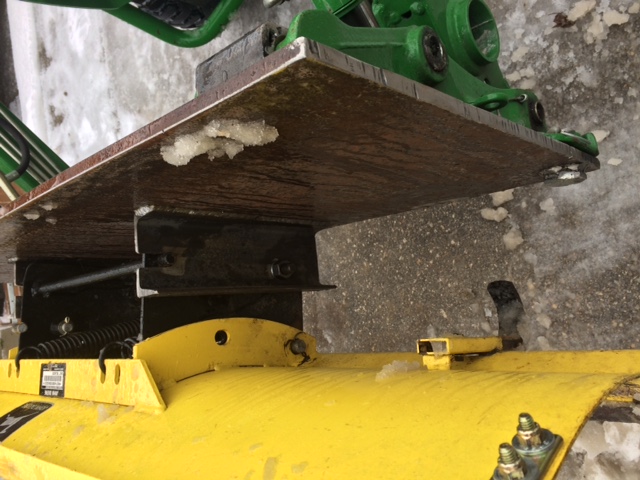

My father in law put some asphalt in a section of the parking lot of their small business. I do most of the snow removal with our big tractor (5115M) but do to my shift work, sometimes I'm not around when the snow is blowing in. I wanted to give him something that is a little more forgiving than fighting with the small bucket so I picked up a used 54" blade. I wanted to leave the springs intact so it is a little more gentle. I just used scrap we had laying around. If this works well I will probably modify it to included a manual tilt. I tested it yesterday and it held together so I will throw some paint on it.
