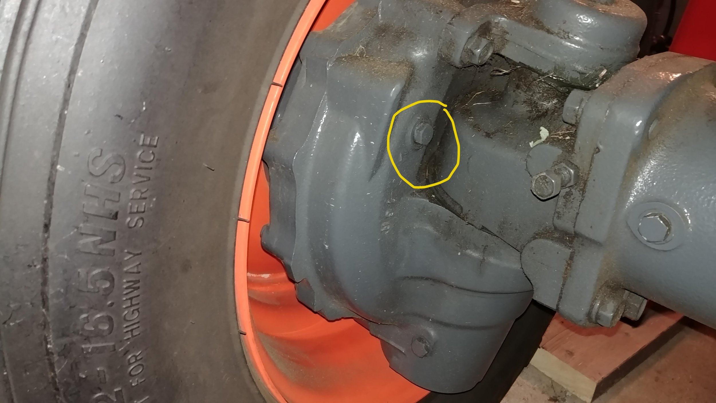

I have a Kubota MX4700 4 wheel drive. The manual says the front axle and gear cases hole 9.5 qts. I drained mine completely. Only drained about 5 qts. When I refilled, only held around 5 qts. Any one else out there ran into this. Thanks for you feed back in advance. Usually manuals are closer than this, in my experiences.

How many plugs did you pull when you drained it?
NOTE: THIS IS AN EDITED CORRECTION: Probably like mine - L4701. Good Point - There in only one drain plug on the right side no fill or check plug., but all three (drain, fill, and check) plugs on the left side. The right side has only a drain plug. The fill and check plug should be removed first to permit air flow. I orginally thought both sides were the same. I was mistaken. I am beginning to think the bottom doesn't drain. The drain plug is about 3" above the bottom of the container.

Yeah for those models without the two on the bottom there is a bit less, but not 3+ quarts worth. For there to be that much not to be called for sounds like one of the bottom plugs was not pulled.
If all three plugs were pulled, then I'd run the numbers to see if it was a conversion. Fairly sure that most kubota manuals quote metric[Standard], but it seems possible imperial standard versions might be out there. Off the cuff, 3.5 seems too large for a conversion error.

I let it drain until there was nothing coming out. I left it draining for an hour and a half.
Did mine not too long ago and it took about 9 litres. There are 2 more level check plugs to take out on the inside of the hubs near the top to let some air out that gets trapped there. I will try and post a picture when I get the chance to.
I have attached a picture of the inside front left hub. I have circled the level plug on the hub that needs to be removed when refilling. There is another one on the right hub as well. All in all three level check plugs including the one on the axle case. Open all three of the level check plugs when refilling to let the air out of the top of the hubs. Once all three have shown some fluid to flow out you are at the right level.
I hope this helps!!
