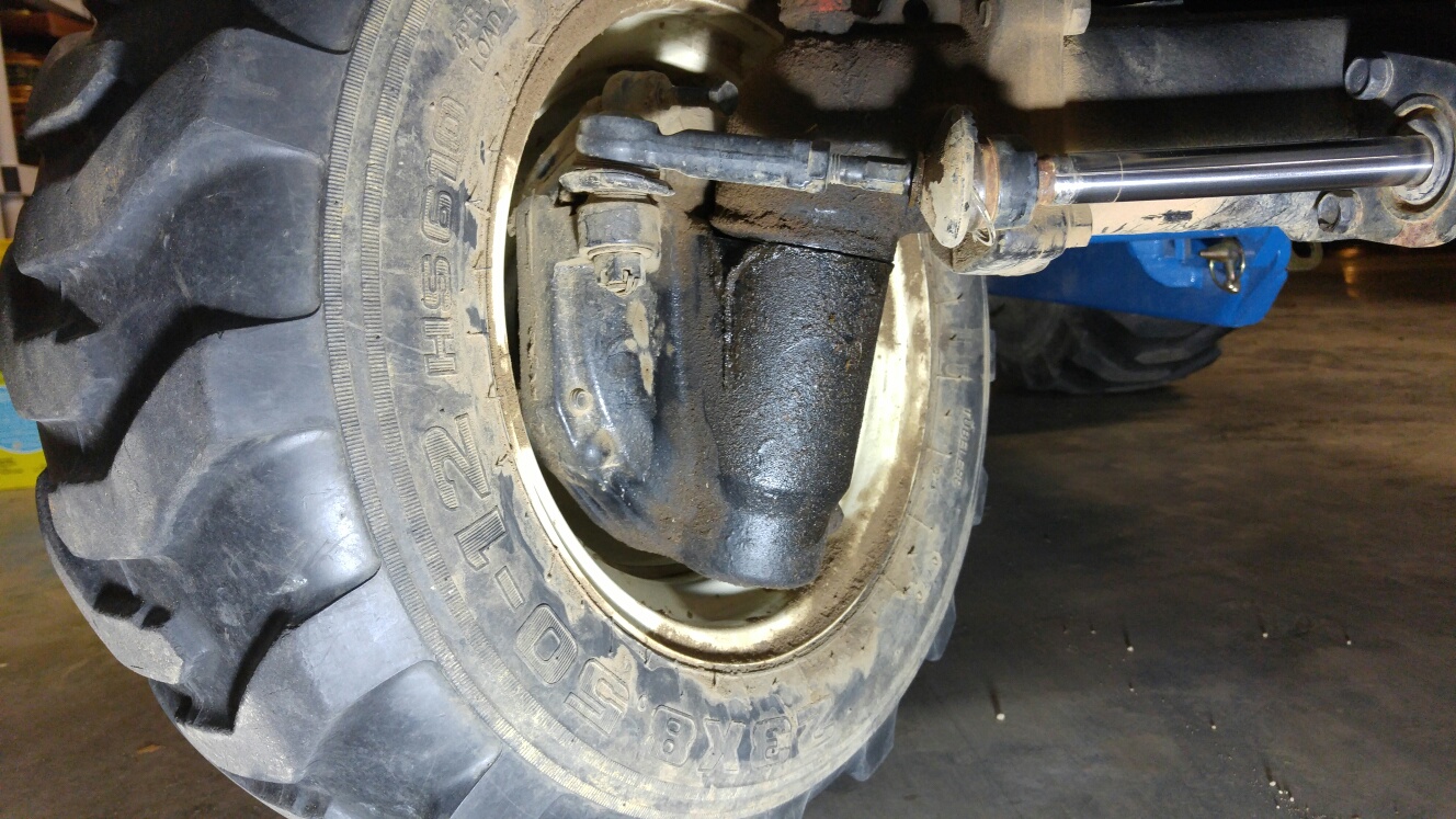

Both left and right front axle seals are leaking (the right much worse than the left). Tractor is 4 years old but only 140 hours on it (new to me). Is this common? Seems to me that 140 hours is a short life. How often do you have to fix these seals. Or even Do you fix them or just keep adding gear oil and not worry about them??
Opinions greatly appreciated.

Thanks for the advice one the seals. I'm definitely leaning toward fixing them ........ I hate machinery that leaks. I was just trying to get an idea of how often you have to do that sort of thing.

Check that there's not play in the wheels any time I had a seal go the bearings were on their way out.

I have had mine replaced already at 100hrs, and am fixing to take it back to the dealer again for the same problem ( about 130hrs). When they had it the first time they said they do not know why it happened but they also replaced the bearings. I called a few weeks ago to tell them I was comeing back with the same problem , they were going to call the factory and see if they had any ideas.Thank goodness for warranty, but I dont want to go through this forever...

Please let me know if they tell you of any specific problem that causes this. I plan on doing the work myself and can use a heads up as to what else to repair.

My tractor does the same thing, but worse. It is bad enough to leave puddles on the floor after a few days. My tractor has 710 hours and mostly loader work.

both my front bearings were replaced under warranty with larger updated bearings.Leaked bad.7040 ls tractor though.

I spoke with my dealer and he talked to the manufacturer, and he said that LS has come out with a new design improvement on the axle seals. Apparently LS has reconized there is a problem. Hope this helps...

Thanks for the feedback. I decided to let the dealer do the seals since it still has about 5 months of warranty left. My plan was to watch the dealer mechanic do the disassemble for my own education for future use. I told the dealer this and he said it would be Monday before he got to it (this past Monday). I called him Monday and he said he was sorry but his mechanic came in on Saturday and did the breakdown. ......so much for my education and future reference. Hopefully the manufacturer sends the new seals out on all new orders. I'll guess I'll just have to figure the whole thing out for myself in the future.
