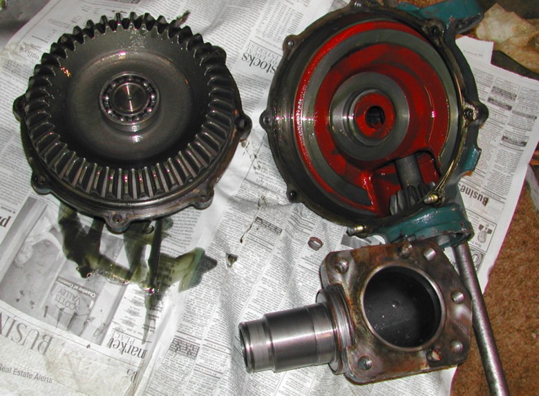

If it is like the one I recently did on an L2550, then it is quite an
easy job. You DO have to have a snap ring pliers with a 90-degree
bend.
Kubota had an upgrade for the seal for this tractor, and it is supposed
to exclude mud better. I really appreciated the use of O-rings instead of
gaskets, unlike the JDs (Yanmars) I have done.

Dfkrug,
How did you begin the dissassembly,
From the bottom, or seperating the axel at the vertical joint?
Were your bearings okay?
I had to replace the front left side wheel bearings a while back and wondering what to expect.
Ken
   / Front axel seals on L2900 #8
Kenonf said:
Dfkrug,
Ken
Remove the hub w/ ring gear first if everything is clean. Or you
can remove the whole assy from the axle housing. Do the latter if
you did not wash all the dirt off first. I like to pressure-wash
the whole area before any dissassembly. This is not always
practical if the tractor is already on stands in a garage or barn.
Separating the king pin from the rest of the hub is the only part
requiring snap ring pliers.
My bearings were fine. If they are not, you can buy standard ball
bearings like the one visible in my photo from a bearing supplier like
VXB.com.
