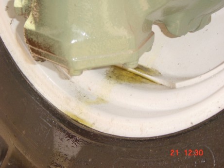

Hi,
Need some help from you buddies. I´m loosing oil on my front axel gear, on the wheel side. It drops a plenty on the drag-rod end´s side. What could it be?
Rgds
Jose

Jose, sounds like outer seal.
Remove and replace.

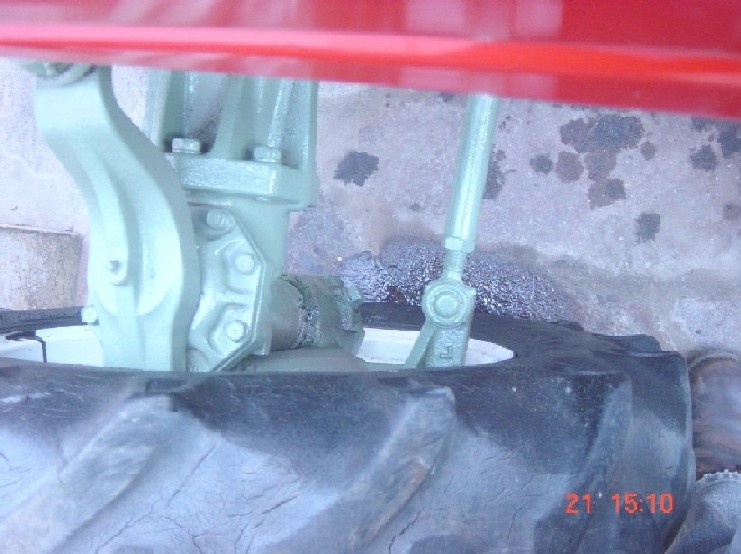

Hi,
Just a question: it looks like it is not tied up. Is that possible? The right side it looks very tied…

Yes Mark, you’re almost there. Let me add only that may be is one in 80.000, since all this machine was a old offer from Japan and during the war everything was burn or disappear. We import everything from South-Africa, our neighbor, and I’m now trying to open a farm, but I know few about tractors. I’ve a Yanmar 3110D, which becomes very complicate to fix little things, such oil filter (I’m looking around to find a cross reference to FRAM), and it’s a hard job. Now to finished the fix, I need to know how to repair (I’m doing my self, and I’m a Telecommunication engineer), the front axel gear that are leaking a plenty (see photos in attach). I appreciate if you could help me with your experience. Just remember that most of the parts we make (when possible), locally.

O.K. Jose.
I think I see your problem(s). It appears that the outer most axle seal may be leaking as well as the upper knuckle seal?
If it were me, and I had no parts readily abilable, I would jack up and block tractor safely and remove front wheel, disassemble steering linkage, remove large upper nut on knuckle (probably a few thin shim washers too) put nut back on threaded shaft and gently tap knuckle assembly apart.
(see if your model has a square key, and remove)
You should then be able to see identifing part numbers or sizes (example only: 45mm X 90mm X 20mm. I would clean up everything make notes of sizes and reassemble the front end. This way you can continue to use your tractor while looking for parts. You may be able to add on additional shim to that side which will compress the knuckle slightly more, but it may also make your steering (at the steering wheel) a little harder. Hopefully this will help.
