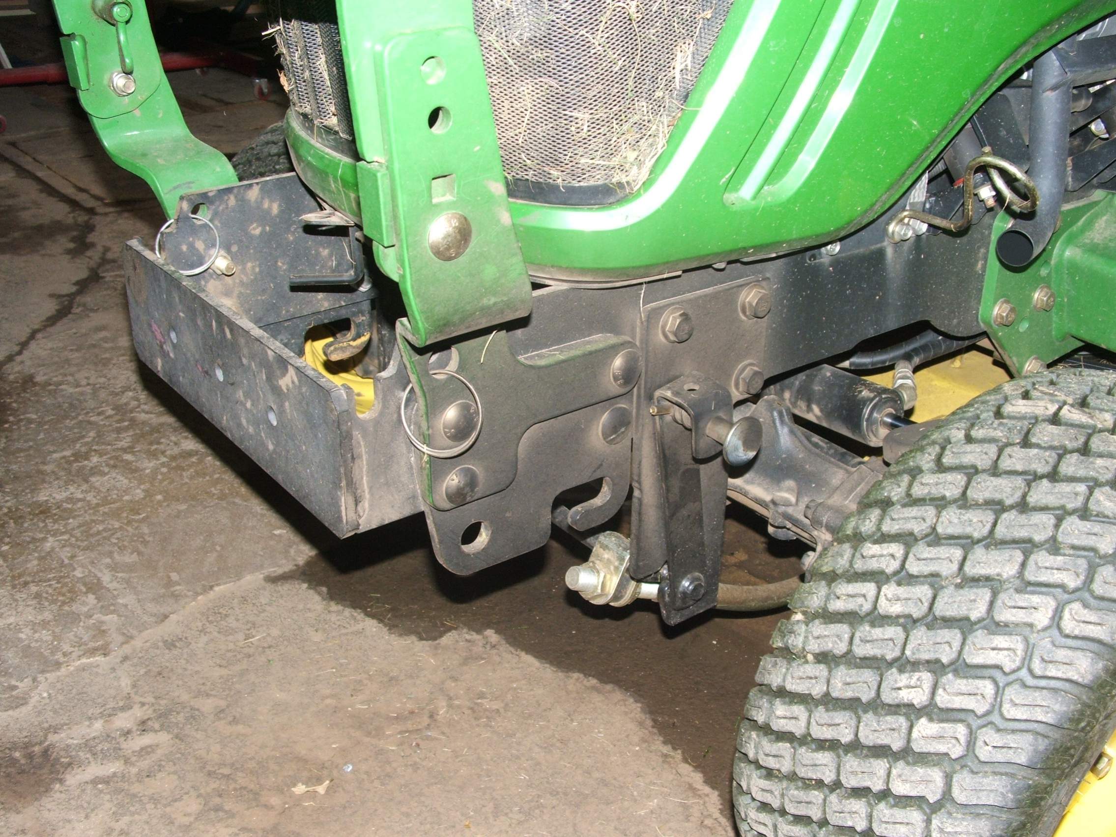

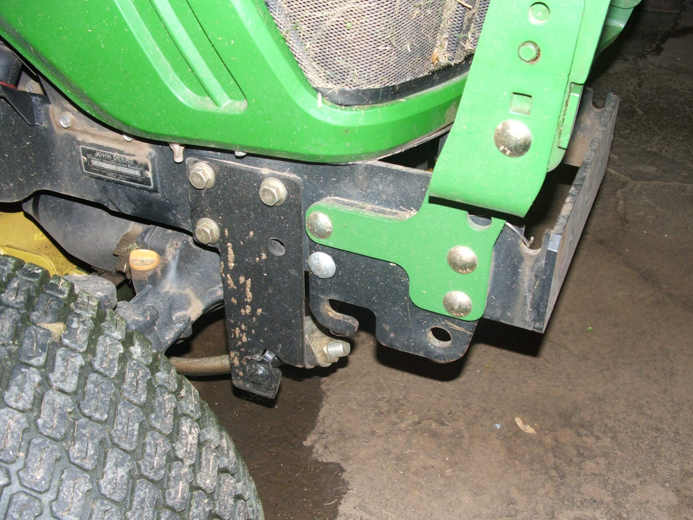

   / Front attachment support and 62D front bracket at same time? #4
Probably look something like this. This is for the 2305.
   / Front attachment support and 62D front bracket at same time? #5
No, there is no universal bracket. They do sell what is called the too less changeover kit. It allows you to change brackets pulling one rod out and changing from the lawn mower hard ware to the front hitch bracket. I like it, although it does add one extra step but no involving. I will try to get pictures while I can
Hi Guys-The part number for the front hitch/MMM combo bracket needed for 2520/2720 tractors is LVB 24899. It is described as the "tooless changeover kit. It is $125, and JD does not give you a credit for the brand new mmm bracket they supplied with the new tractor. It looks identical to the supplied bracket, but appears to be angled a little bit to permit access to the front attachment support. Why JD doesn't do things right and supply the combination bracket with all CUT MMM's is beyond me. I would think that it is reasonably anticipated that most CUT purchasers ordering a mid mount mower and front implement Qucktatch kits would need the combo bracket for efficient use of the machine. It is a little disconcerting that JD would not provide the correct part and then market the correct one as an "upgrade". Sorry to vent, but I am a bit upset that I find out after purchase about what should have been supplied at the point of sale.
