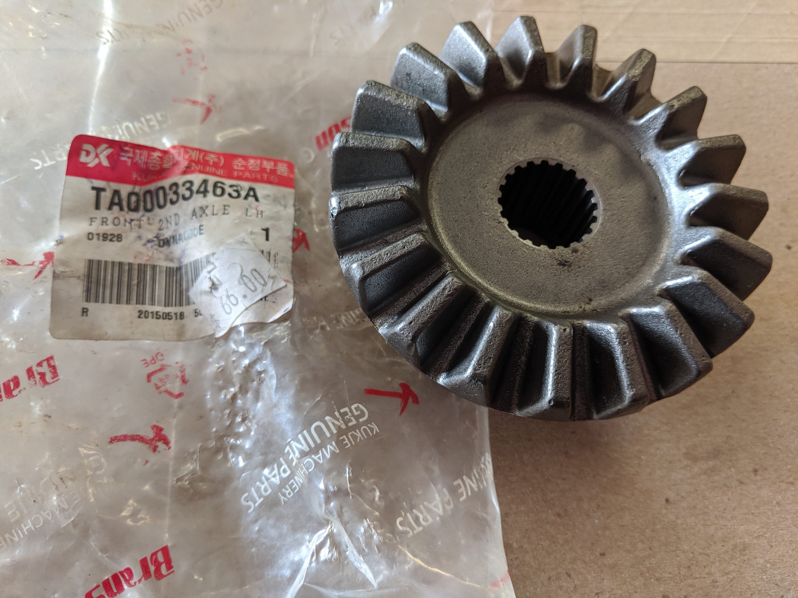

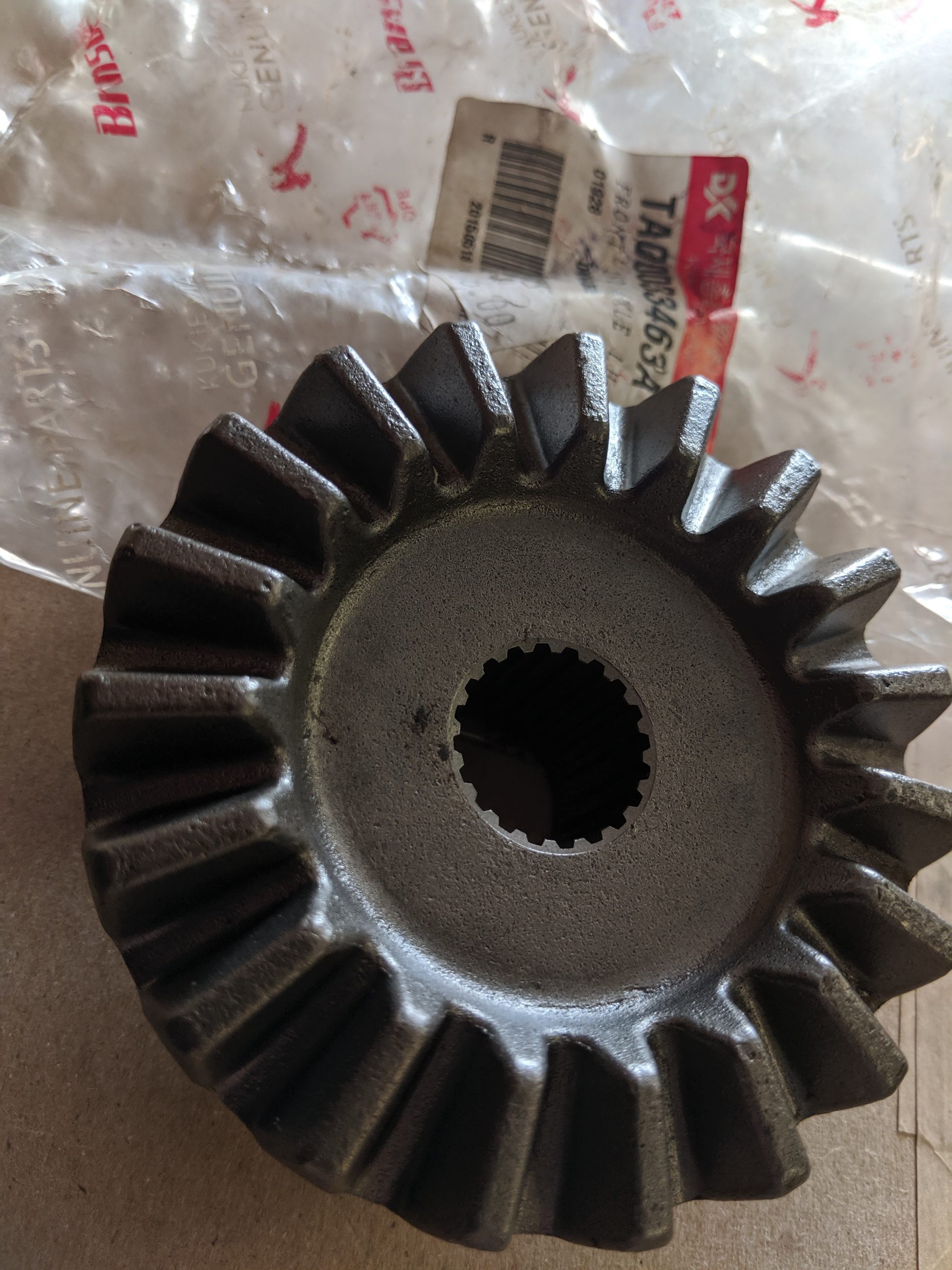

I've seen this gear and the one it mates with break many, many times. It appears to me they didn't do the final machining on the gear surface. Even when new the two gears don't "ride" fully seated into each other.
When this gear breaks the teeth are smashed/deformed not shattered/snapped like a properly hardened gear. I've spoke with Branson about this many times over the last 8yrs but the new gears keep coming with the same crappy finish.
It is used in most of the 15, 20 and 25 series tractors.

Looks more like a cr@ppy chinesium sand casting where they use the as-cast part as the pattern for the next mold.
Id be interested in seeing some examples of famous brands supplying finished gears like this.

After looking close at the pictures the OP provided, if that gear is a powder metal product, who ever made it, is not very good at it. It looks like a plain sand casting to me.
