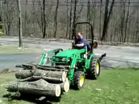

With just a little bit of time to spare before Easter chow today, I thought I'd start tackling an 8-10" oak needing to be removed on a precarious hillside. With the 2520, the 46 hoe, my trusty Stihl saw and the good old loader forks, the job was complete in one hour flat. Most of the time was spent finding workable positions for clawing away at the stubborn stump.
That 2520 is a great machine and a welcome addition. The 46 hoe is nice and fast. I'm finding a few concerns but nothing I can't live with or improve myself. For example, the stabilizer feet are way too small. They sink right in after working the hoe for mere seconds. It's really odd to me that JD would have them as such.
All in all, I'm amazed at how fast the job was completed.

Job (s) well done. :) (I like my forks a LOT too ;) )
Can you make some pads of wood blocks to fit onto the existing "stabilizer feet" ?
This time of year around here would take a good size pad to stay on top.

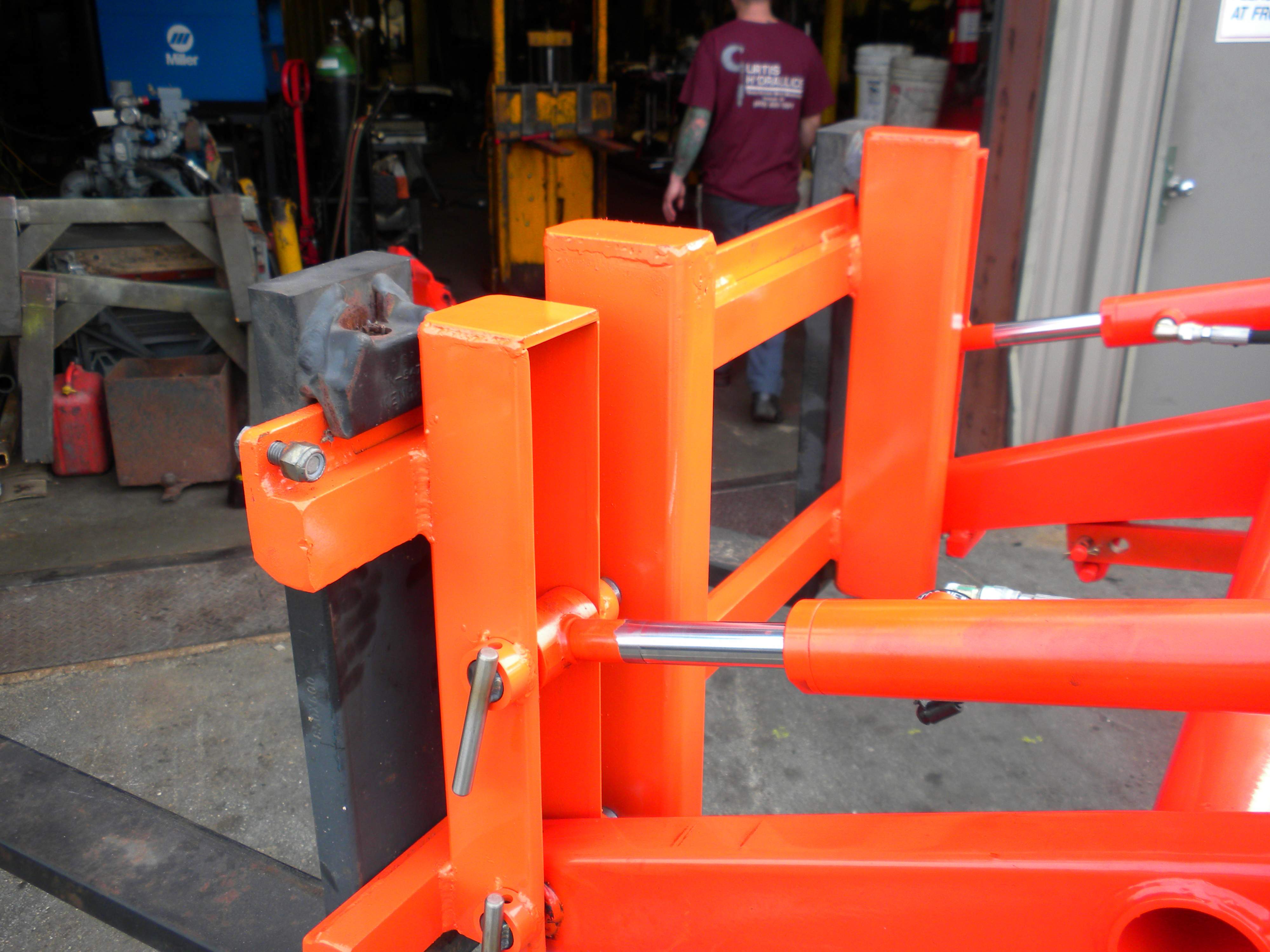

Hi wd, thanks. Isn't your loader a pin on style bucket? How do you swap out to your forks?
   / From Saw to Stump in 1 hr with new 2520 and 46 hoe #8
I have to do it the ole fashioned way.....No quick attach here.....4 pins and VOILA..!!
