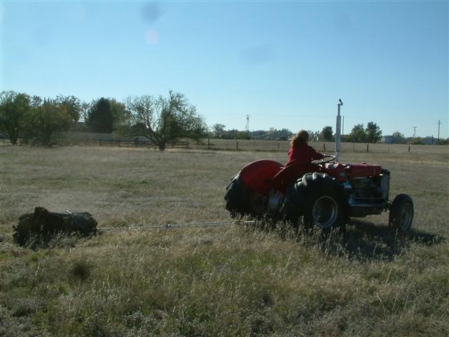

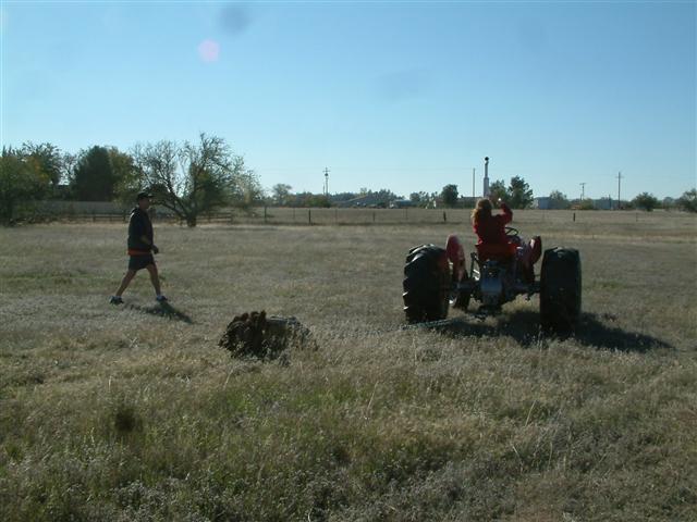

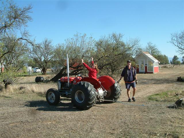

Unless you really, really want a used 1950-70s era Ford tractor, I'd advise widening your search. There are many Massey Ferguson and Farmall tractors that would work for you on your 13-acre spread. For example, I have a 1964 MF135 diesel deluxe tractor (no FEL, 45 hp engine, 37 hp pto, 2WD, power-assist steering, 12F/6R gear tranny) that cost me $3600 in July06. The 135 has the Perkins diesel which is a very reliable, fuel efficient engine. You can get parts from MF dealers and from second sources on the Web.
BTW: my 135 is a field tractor that has been modified (lowered) to work in the olive orchards around here. The 28" dia rear rims normally found on field tractors were replaced by 16" dia rims carrying Goodrich 6ply 18.4-16A rubber and the front axle spindles were shortened to keep the tractor level. Lowering the CG stablizes the tractor so it can be used safely to mow steep slopes (not a problem for me since my 10 acres is flat pasture) and those wide rears provide high flotation to keep tire rutting to a minimum.
