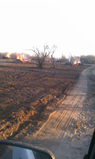

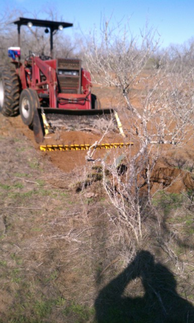

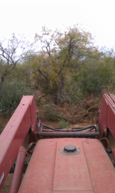

Looking for some advice. Currently clearing brush,discing and came back and spray. then disc again. I am using the ratchet rake which removes alot roots and all, but I cant get it all. I wonder if plowing would help any, getting in deeper and turning it up more? My end goal is to plant seed for grazing. pics to show what I am doing.

Can't tell where you are from your profile.
Looks like South Texas to me...is that a mesquite in the middle of raked ground in last photo?
If so, need to take it out...else the beans will continue to fall, sprout and cause continual problems.
Am amazed you got that much done without plowing, yes, that will turn up more roots and result in greater brush kill/control. A chisel plow will do a great job of ripping up roots. With the ground work you've already done, residual grass seed is minimal, so, yes, reseeding is your path to grass.

Yes south of San Antonio about 50 miles. Mesquite brush and others various species. This area in the pics I did last year, have had some new growth. Sprayed and have disced again. I scrape everything and push into brush piles. New growth seems to come from what I can get out of the ground. What size chisel plow should I look at for a 53Hp 2 wd?
