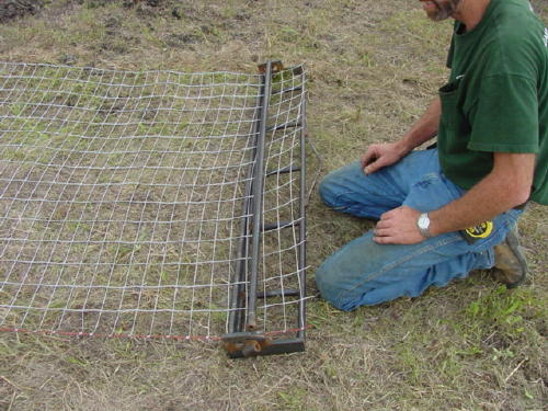

We put up six hundred foot of five foot nonclimb yesterday for a quickie fence. Bud just picked up eight acres and needs a corral to hold the ponies (eighteen hands) and goats while he builds his fence.
We dug eighteen inch holes six to seven feet deep and put in telephone poles for corners, gates, ends, and splice points for the wire. Then we put in the t posts.
For stretching I pulled out one of my friction grip stretchers.

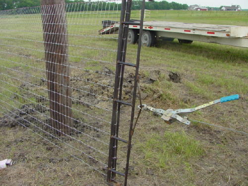

After you pull it through once you fold the fabric over like so.

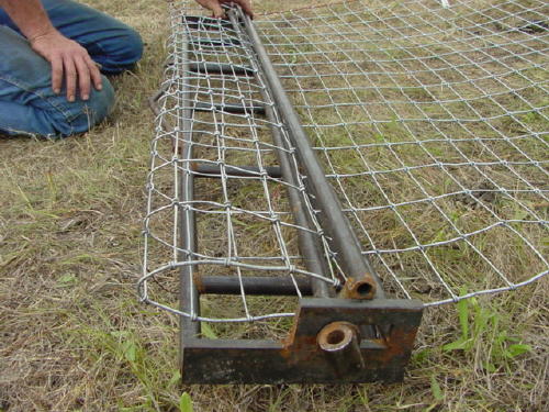

Pull out the slack

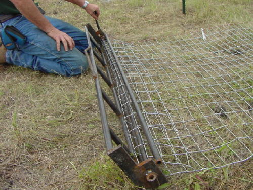

Hookem' up and pull'em tight

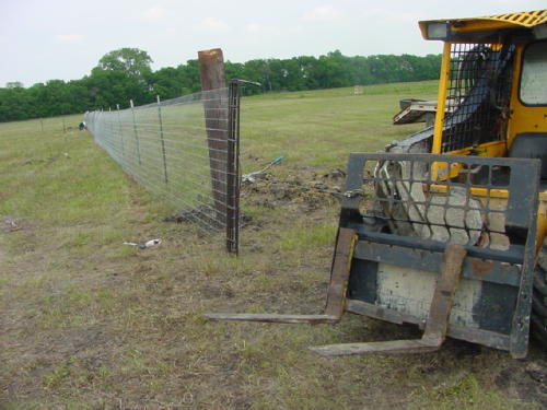

Another angle of the dangle.

how about more closeups of the mechanisms. I want tobuild one but needmore detail.
