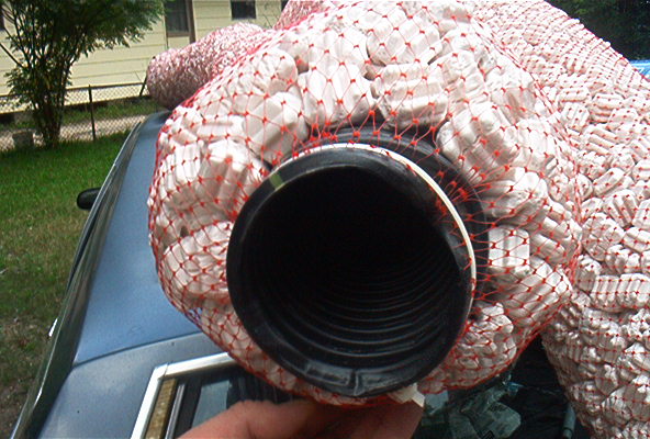

One of my rent houses is lower than the rest of the lot. I decided I needed to drain the lake so we have tunneled under the house and replaced the sewer and we're going to put in a french drain to try and keep it at least semi- dry. Have any of y'all used this stuff? I think it will save me a ton of labor compared to getting recalcitrant helpers to trolley gravel under the house.

It comes in ten foot lengths, $22 and change at Lowe's.

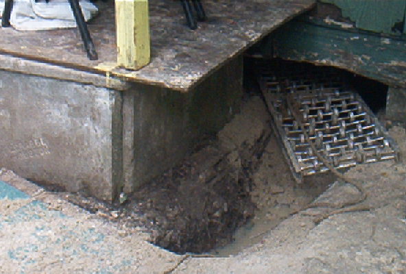

This is how we're, or they're /w3tcompact/icons/grin.gif, getting the sand we're using for fill under the house. I found this section of roller conveyor at the dump.

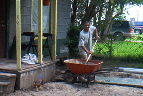

This is one of my other tenant's kids, Nick. Nick is smiling because he just got out of jail AND found a few days work to make some partying money for the holiday! Life is good! Nick's little brother is the one under the house. That's because Nick is bigger then him.

Brad,
The drain material you have looks like the same thing they call “Easy Lay” and is used for septic systems down this way. I don’t know if that is the product name or a slang name used by the locals. It gets good reviews from those I have talked to.
MarkV
   / French drain #8
One thing that comes to mind is that, over time, silt and or other materials could get between the plastic "peanuts" and plug the works. In similar applications I have used Tyvec sleeving over the perforated drain pipe burried in gravel but better yet is some geotextile over the whole thing to keep stuff from getting in over time and ruining the drainage capability.
Another possibility where gravel is too much work is to use recycled tires (ground up i big gravel sizes) as a substitute. Works fine in leach fields, french drains, and similar applications but is much much less labor to move around.
Best of luck to you,
Patrick
