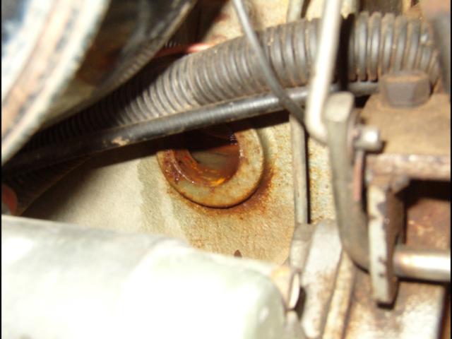

Mar 4, 2005 / Freeze plugs #1 C CAT1 New member Joined Jul 3, 2004 Messages 12 Location Oxford, MS Tractor 1980 JD 950 I have blown out a freeze plug and need to know if it is an item I can buy at an auto parts house. My manual shows it to be a taper plug, but no dimensions are given. Can I use a "cup" style, like on a regular motor? Attachments 597502-IM000844a.jpg 35 KB · Views: 236

Mar 4, 2005 / Freeze plugs #2 B bruce1966us Platinum Member Joined Mar 14, 2002 Messages 516 Location Tennessee You can use a cup type plug. The standard sizes for Yanmar are 25mm, 30mm, and 50mm.
Mar 4, 2005 / Freeze plugs #3 YanmarFever Elite Member Joined Mar 10, 2002 Messages 3,371 Location Eating a melon.. Tractor Mahindra 5010C- Branson 4520r- 5520C- Yanmar FX235-D - Bad Boy rogue mower Buy a rubber one at any auto parts store & they are adjustable. they cost 2.99 (cheap) I believe its a 1 1/8 size Ern.
