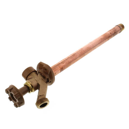

This is what I have installed in the past for garden hose spigot to outside. Once installed insulate rim joist with foam then fiberglass to inside to prevent cold transfer down pipe. faucet.jpg
   / Freeze/frost proof outdoor faucets - what's good, what's bad? #5
Woodford 10"...also install at a slight upward angle into building so it drains completely when valve is closed...slope to outside.

This is what I have installed in the past for garden hose spigot to outside. Once installed insulate rim joist with foam then fiberglass to inside to prevent cold transfer down pipe.View attachment 574217
Thanks!
/edit - That looks like a model 17, found one on Amazon for $619!! Amazon.com: Buying Choices: Model 17 12" Length, 1/2" FPT x 3/4" MPT Inlet Anti-Siphon Wall Faucet w/ Metal Handle
Found many other Woodford Model 17's for about $40 or less :)
