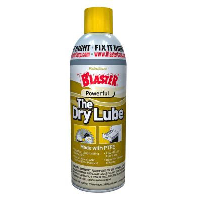

Fluid Film has been my go-to lube for a couple of years. Also use the dry lube on padlocks, etc. I do want to try the ATF & acetone mix though. Thanks to Walt for sharing test results. Sent from my iPad using TractorByNet
Dry lube by PB Blaster.
