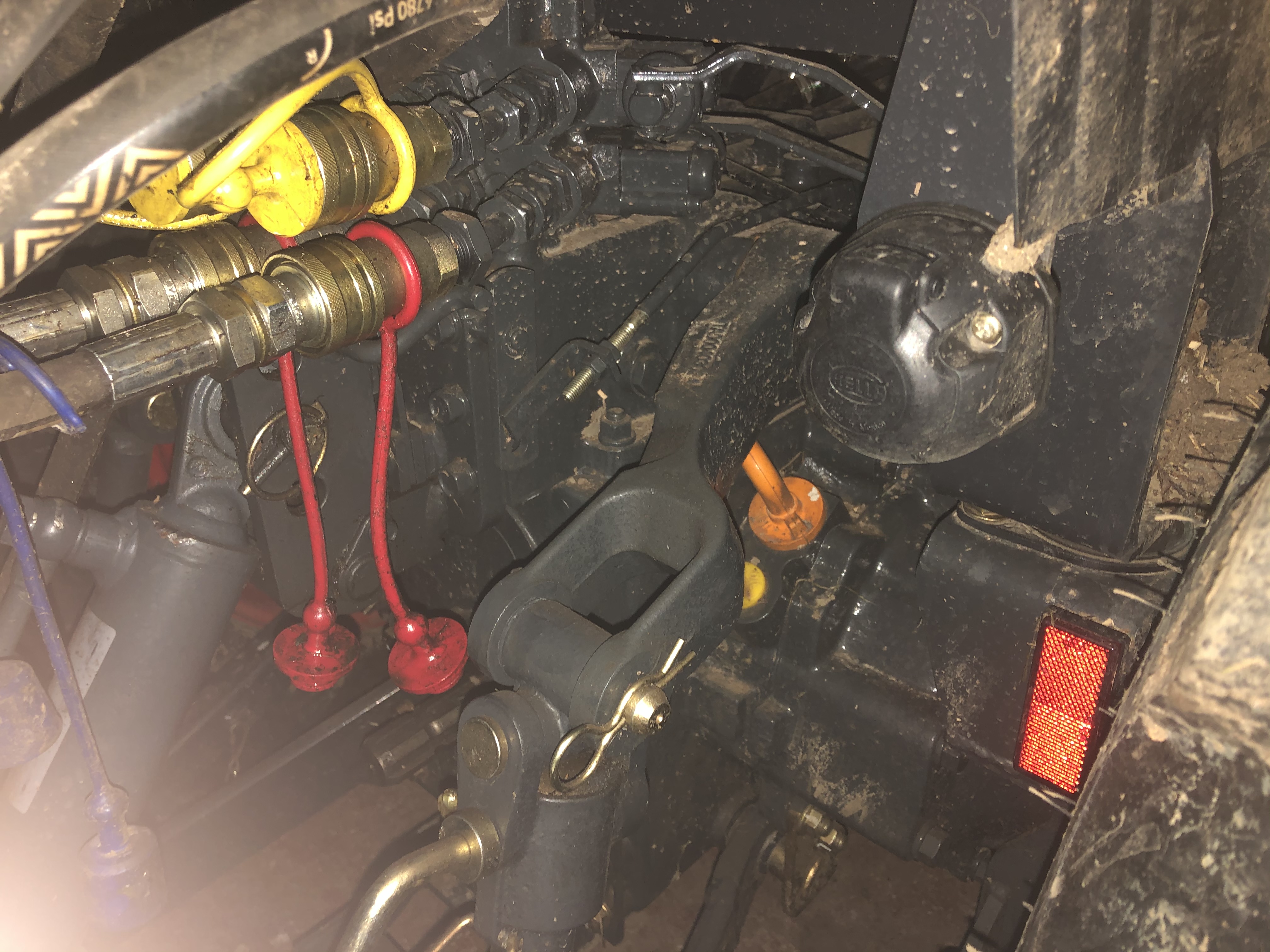

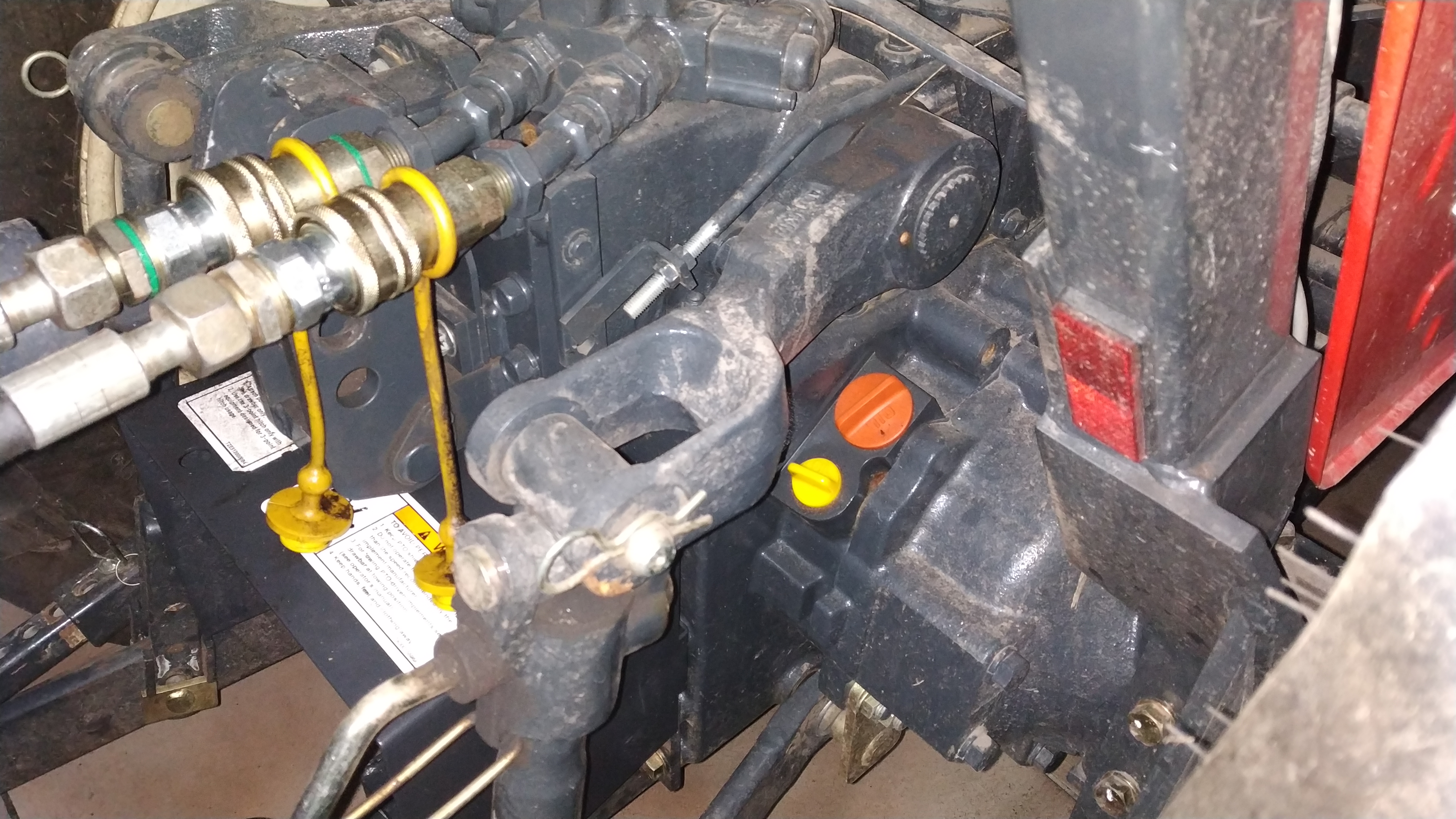

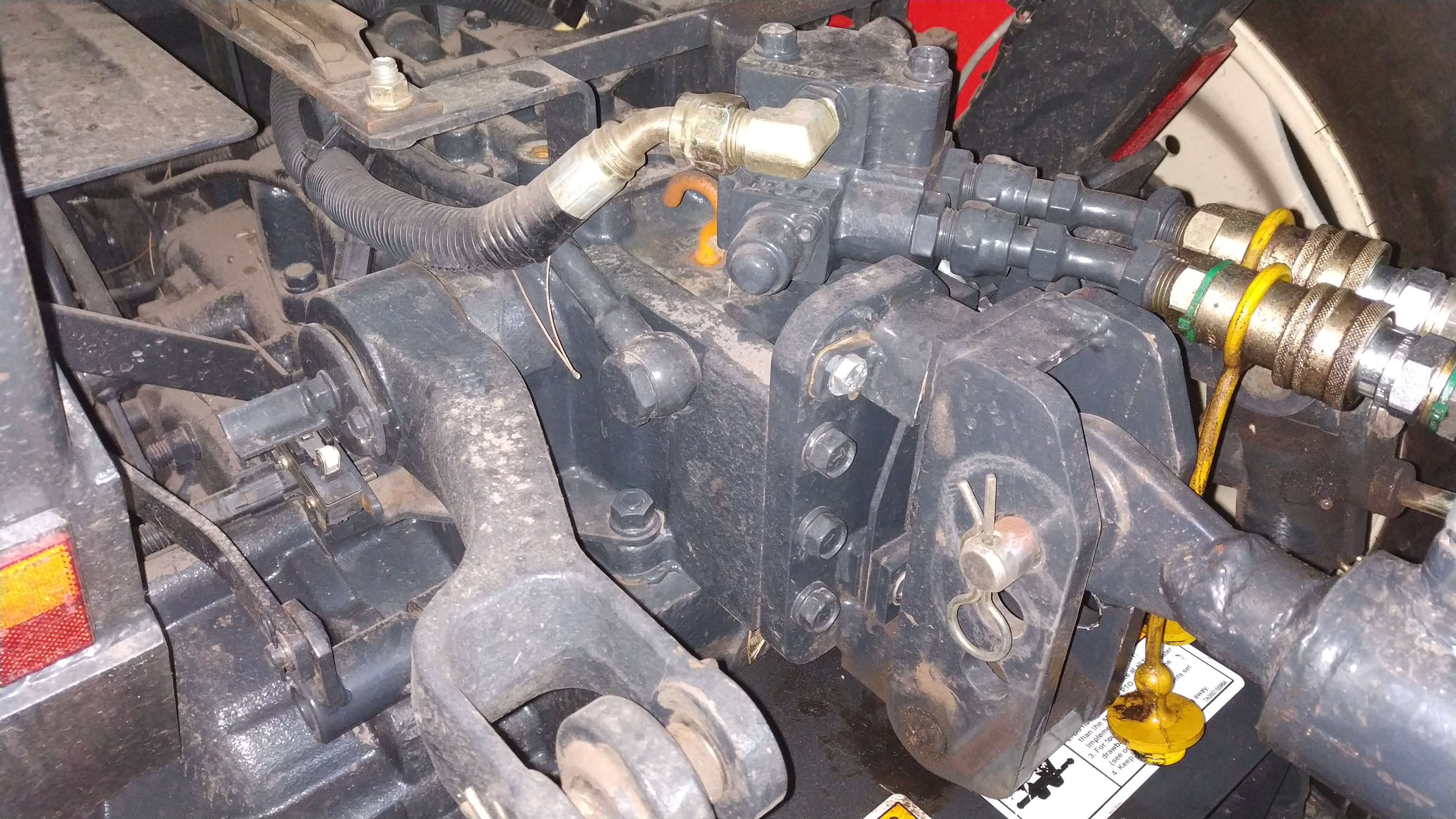

I did check my tractor and haven't found an obvious unused plug for that other than the fill or dip stick ports. There is a plug hidden behind the right rock-shaft arm but I'm pretty sure that's the safety relief valve.
Took a couple pictures for others to see how it's setup:

Thanks for information I will have a look, I have put a pic on of my setup
Michael

Thanks for the ideas, I have put a photo on of my setup
Michael
