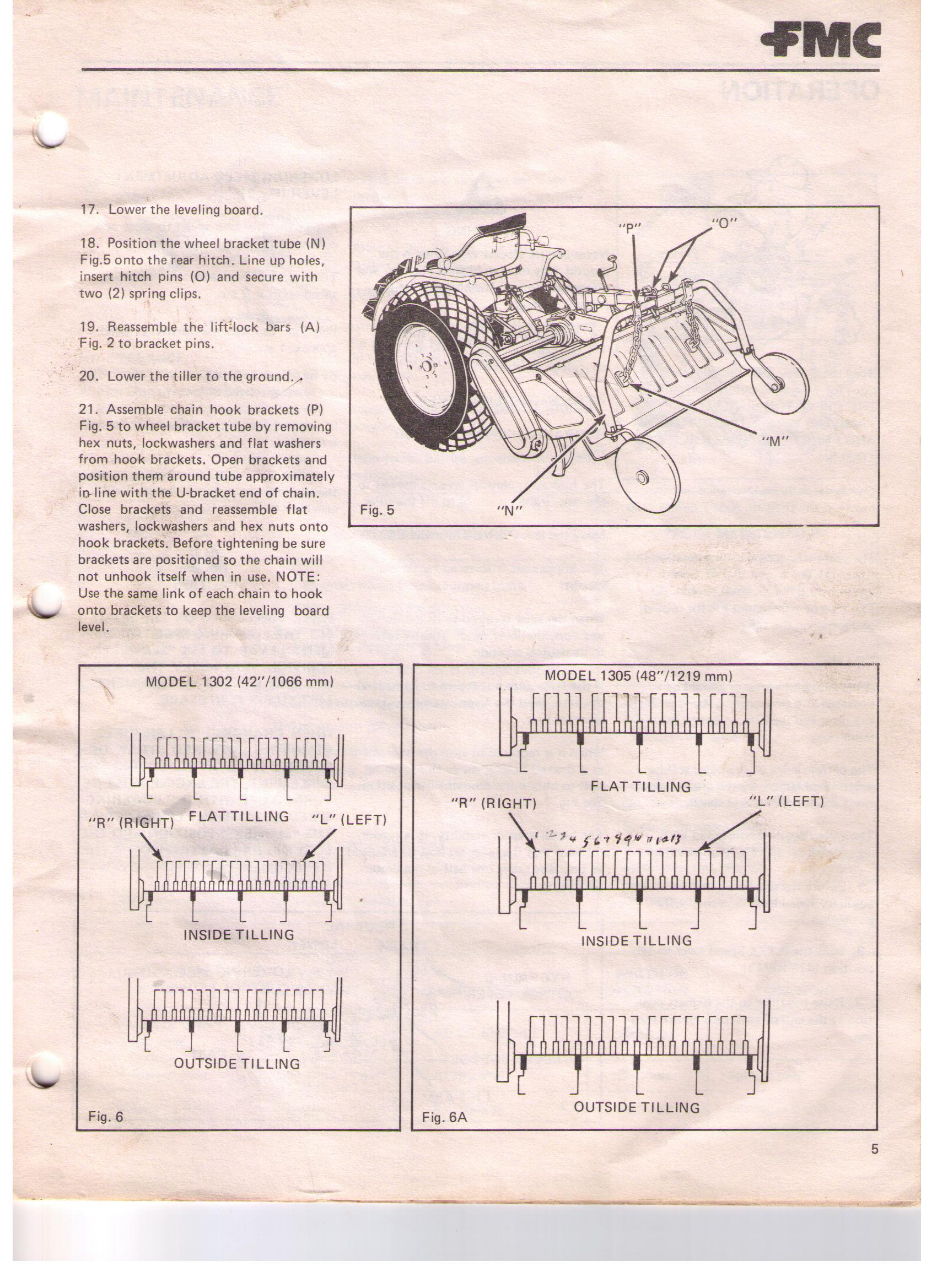

Free Bolens Tiller Manual
   / Free Bolens Tiller Manual #1
johneic
Jan 4, 2010
228
Paducah (West) Kentucky
JD 3038e, Bolens-Iseki G174 2 Cylinder (early), Kubota B7200E 2WD belly mower
Enjoy!
#2
I had them all numbered right, the numbering got changed in the upload, sorry. The real page numbers can be read at the bottom.
