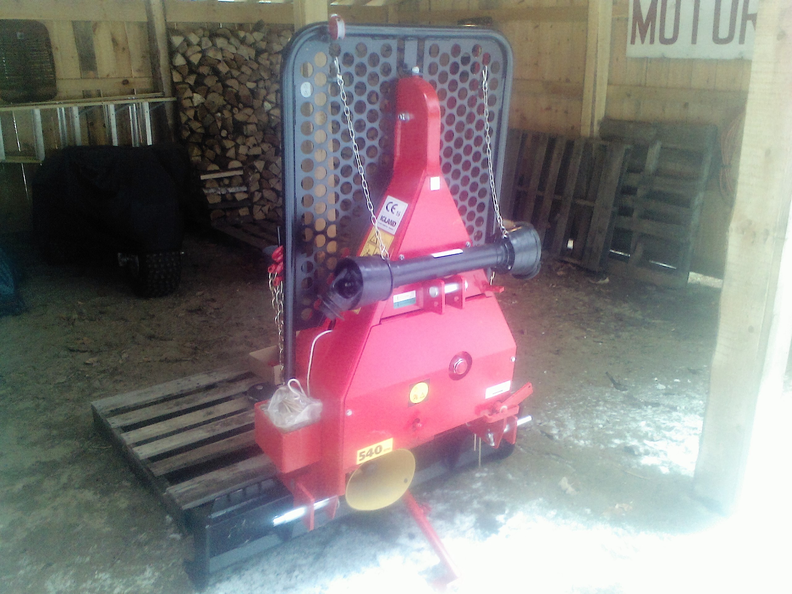

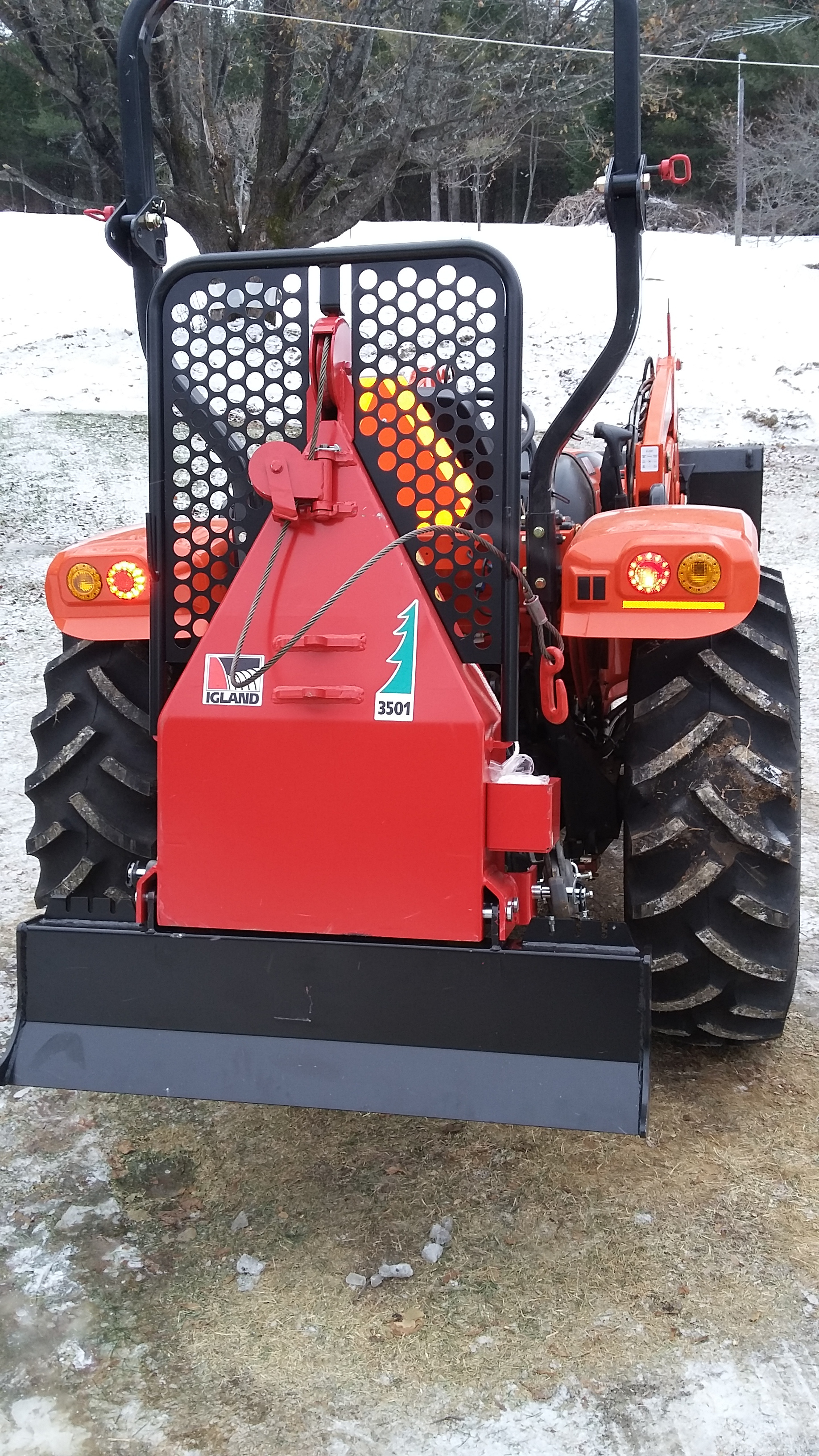

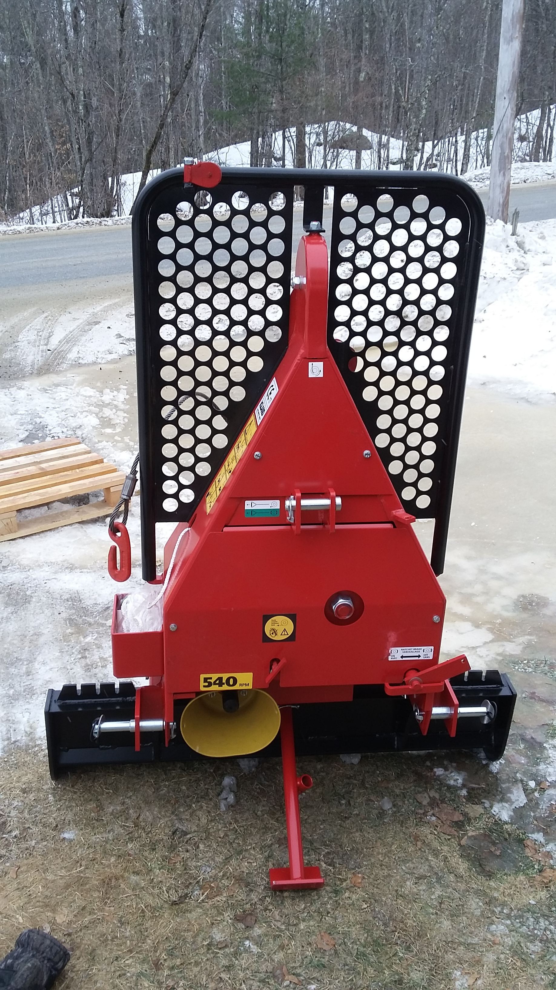

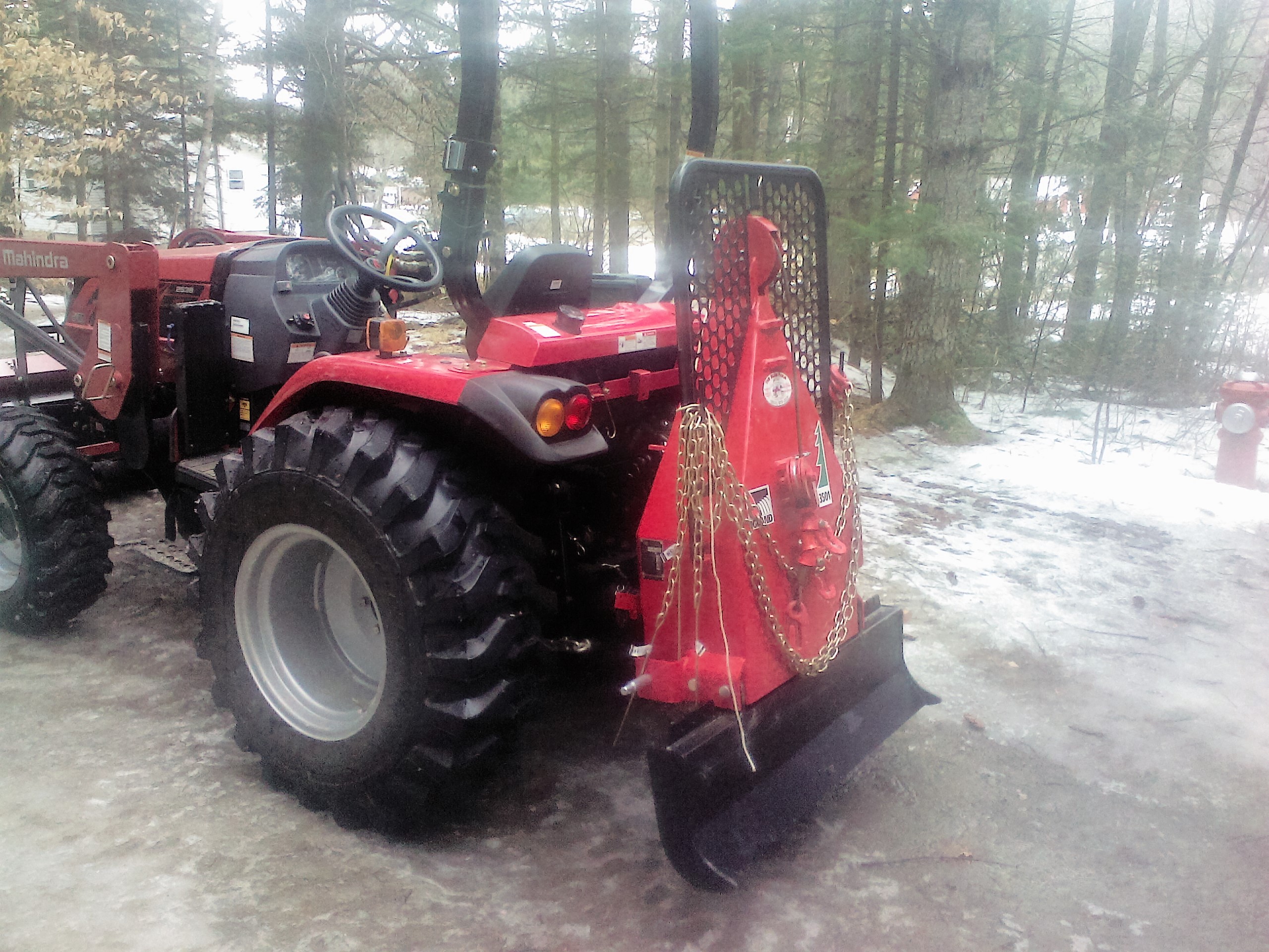

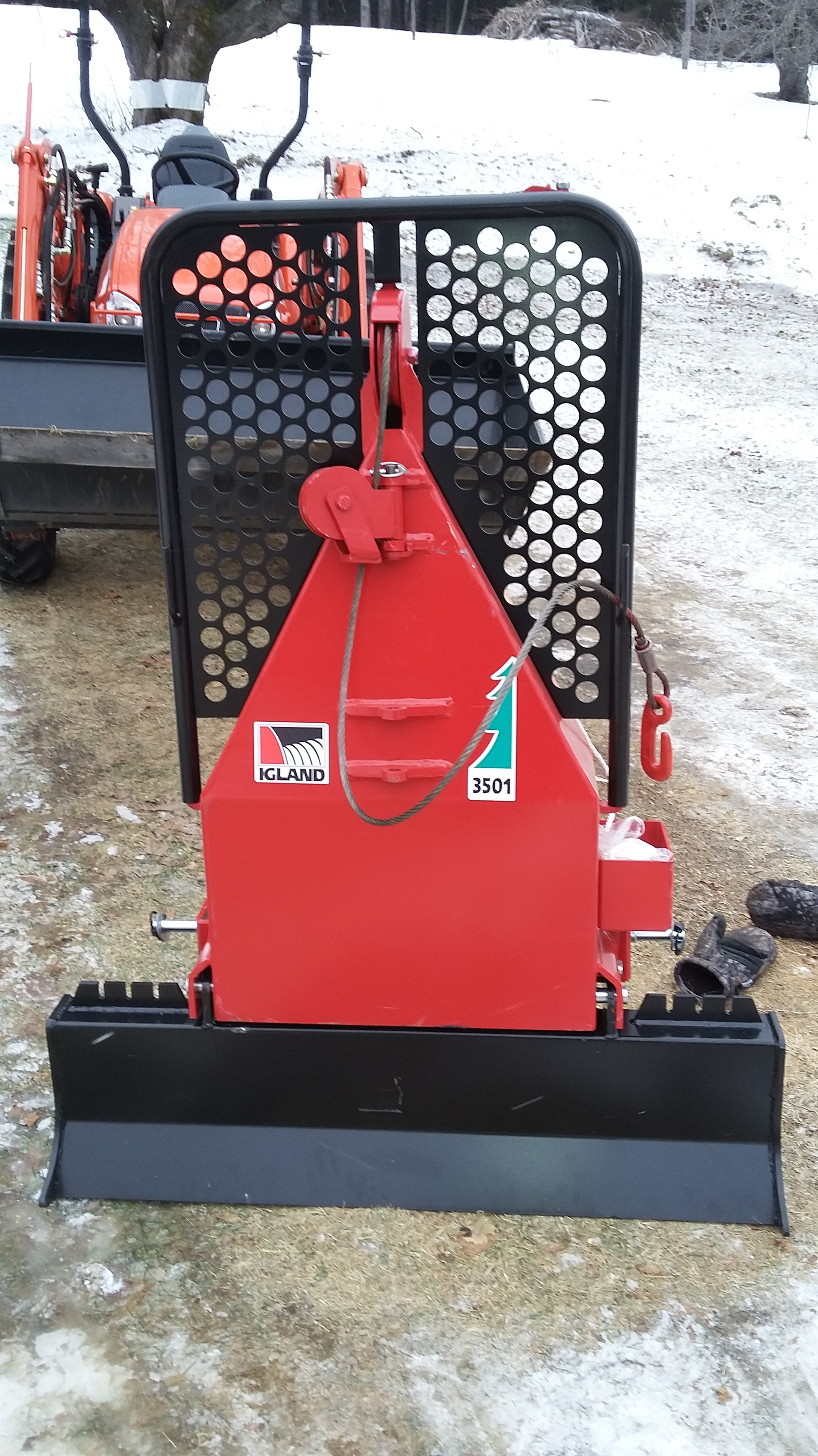

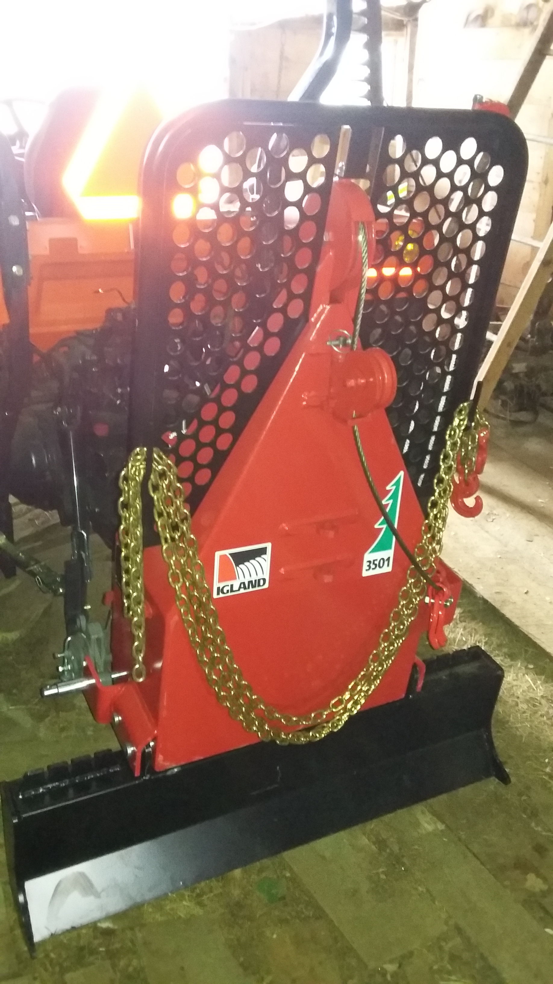

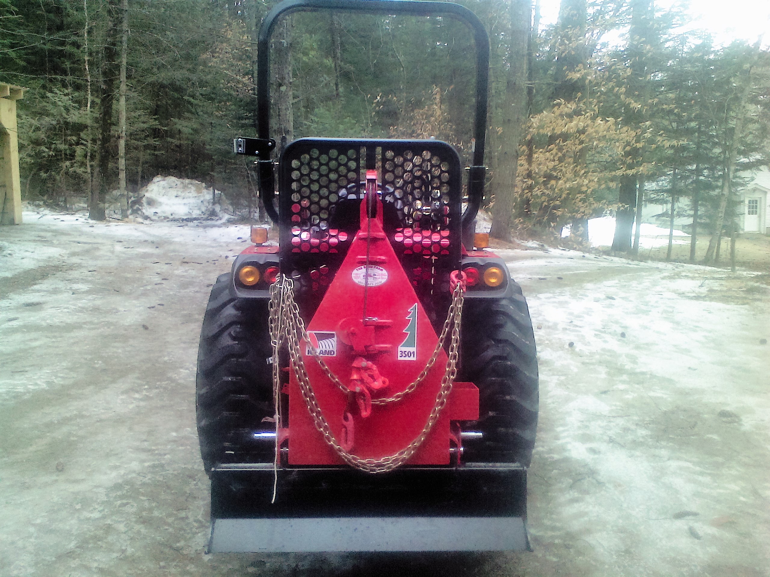

Yesterday I bought the Igland 3501 it pulls 1100 more pounds, weights more, came with 3 free chokers and 3 free slides. The dealer actually matched the price of a ad I brought with me and I ended up getting it for $2425.00. The Fransgaurd was off sale Wednesday and that was going to be $2750.00. I also liked the hinged blade aspect. But probably the main reason I went with Igland was it was totally enclosed. The Fransgaurd was all open in the back and I have a habit of getting branches everywhere there not suppose to be. Got it all installed today with help from my brother and buddy. Cutting the PTO shaft, adjusting the height, winding the cable, and putting a stop on my PTO lever so it don't hit the back of the tractor when lifted all the way up. Can't wait till the snow goes so I can put it to the test. Ryan
   / FRANSGARD VS IGLAND LOGGING WINCHS #10
Id love to see a photo of it attached to your tractor, Ive got a 45 hp tractor and trying to decide on the 3501 or 4501 igland winch.
