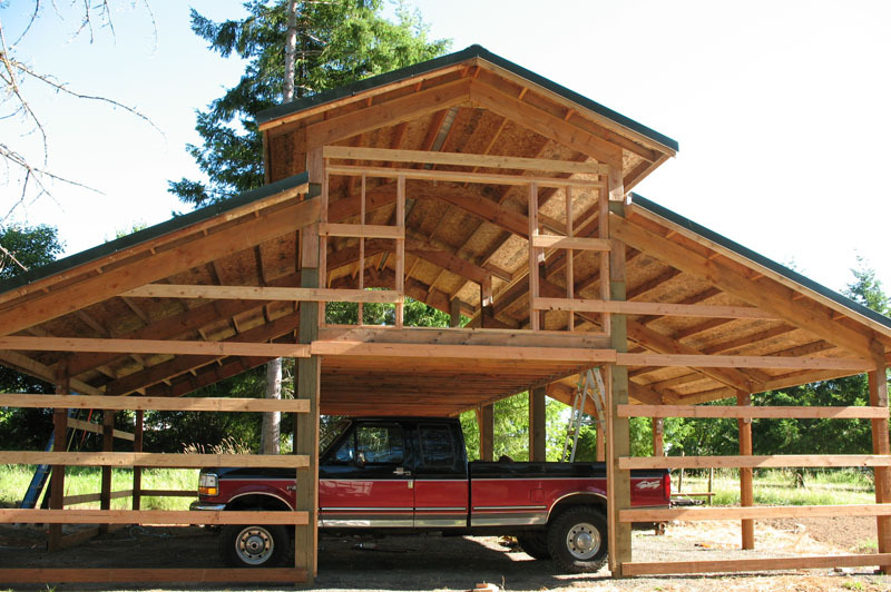

I'm planning on building a 36'x48' monitor style pole barn using standard 12' spacing and I need some help figuring out how to frame the loft floor. Basically the loft floor will be a deck, but instead of sitting on top of posts it will hang between them.
Here's a picture I stole from another thread that illustrates what I'm trying to build:
My specific question has to do with the ledger boards that the joists will nail into; floor joist span tables are all over the place, but I can't find any guidance on how big the ledger boards need to be. As I mentioned in another thread, the loft will be used as a bunk house. I did find a porch beam table that said I would need (3) 2x12's glued and nailed for a 12' span, but then found another table that only called for (2) 2x12's- and to compound my confusion I'm not even sure if beam sizing corresponds directly to ledger sizing.

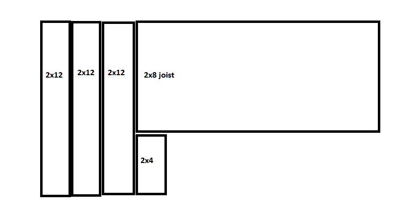

Try this
http://www.southernpine.com/pdf/ref207.pdf
Page 17 and 18 I think applys to your situation.
It calls out for 2 2x12's of #1 grade or 3 2x10's of #2 grade.
#1 grade stuff is usually a bit pricier. I think 3 common #2 2x12's like you were planning would be fine.
On a side note, If it were mine and because it wouldnt add much $$$ but WOULD add much more peice of mind, Use the 3 2x12's, but on the bottom part of the face of the ledger, add a 2x4. This will assist the joist hangers in the vertical load.
