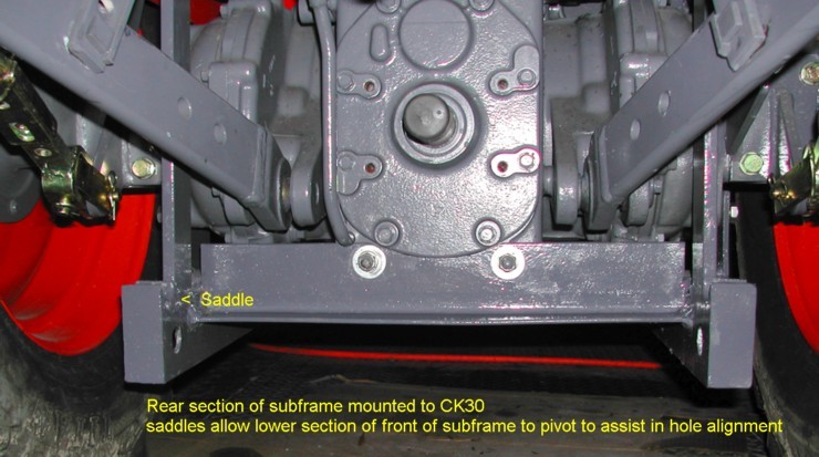

I am wondering if any one has seen a solution to keeping the 3pt hitch arms on with the frame mount back hoe? My back hoe uses the same attachment points as the lower arms.

Thats just it, it takes me longer to put the arms on and off than the hoe, so basically it's just a time saver.
Can anyone add a pick of how theirs allows both at the same time? I have a few ideas but nothing final yet.
Thanks Bob
I am not sure how your Branson subframe is made, but maybe you can
make a different rear mount that does not interfere with the 3-pt hitch
lower are pivots. Maybe that is is impractical.
Early Kubota subframes from Woods did it that way, which is very
inconvenient. It was a lot of work to remove the rear subframe bracket
before you could even put the 3-pt arms back on.
Here is a photo of a subframe I made that avoided any interference with
the 3-pt arms, which I leave on (but folded up) while the hoe is on.
