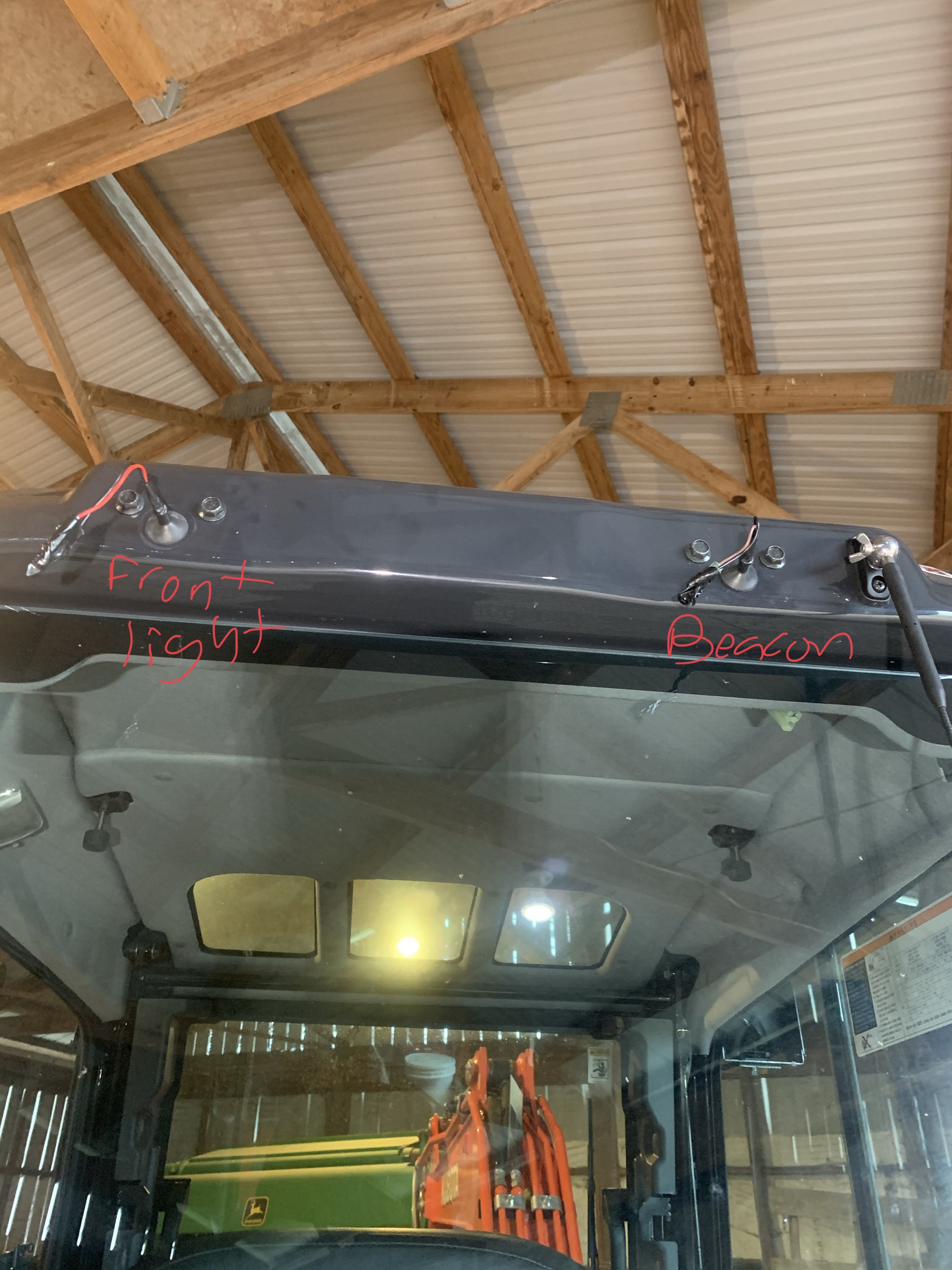

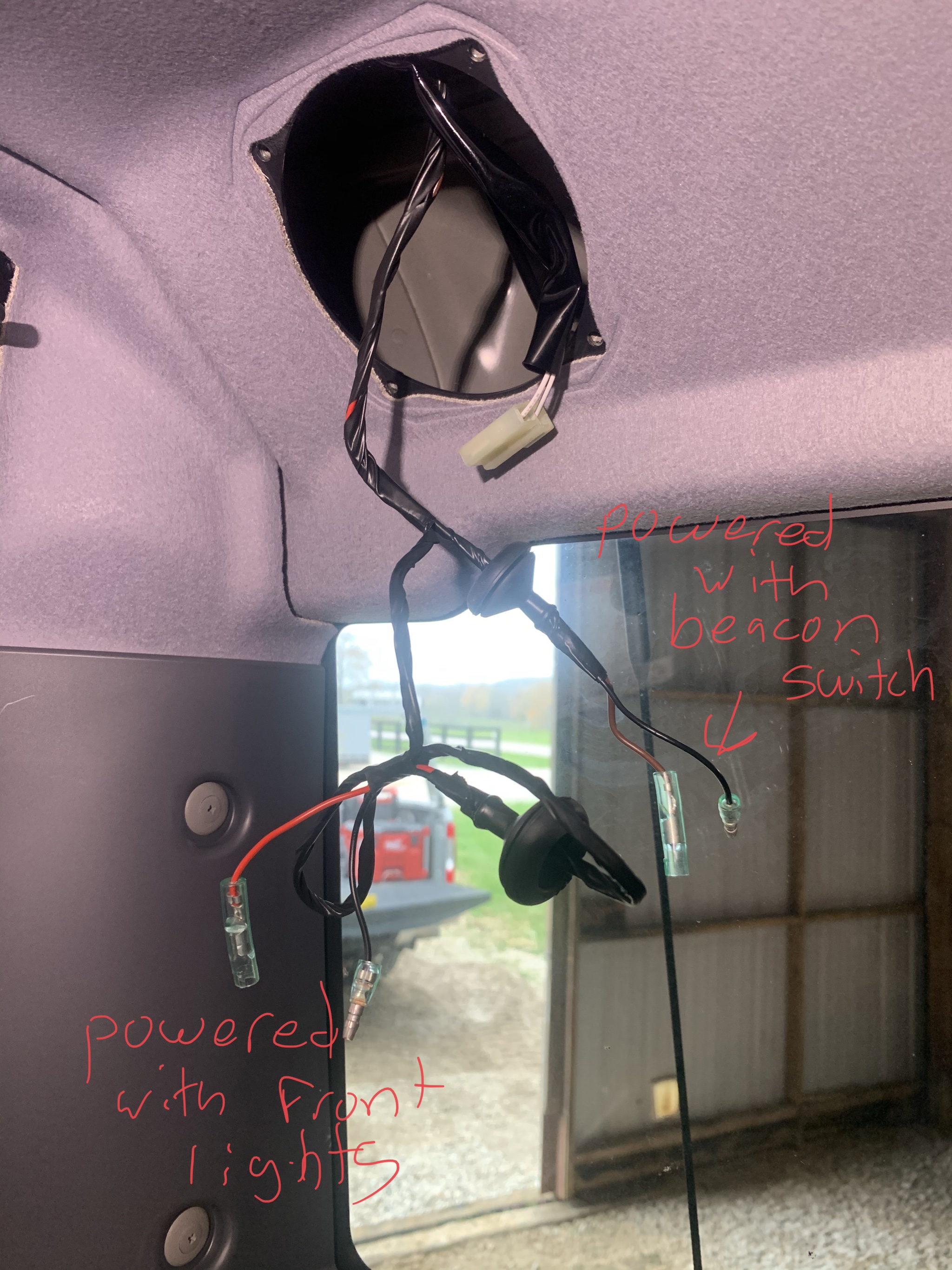

Found the wires in kx040 for rear light and beacon light.
   / Found the wires in kx040 for rear light and beacon light. #1
Hersheyfarm
Veteran Member
Sep 13, 2009
1,077
NE ky
I assume this will be the same for the different models. Mine came with a beacon switch, no light. If you look behind the passenger side speaker you will find the wires. They are attached to the grommet closest to the antenna. Pop out old grommets and push these through and your good to go. One(red wire) is powered with front lights and the other(brown wire) is powered with the beacon switch. I am going to add a light that comes on with with the front, but may use the beacon to put in a better inside cab light. Not sure yet.
