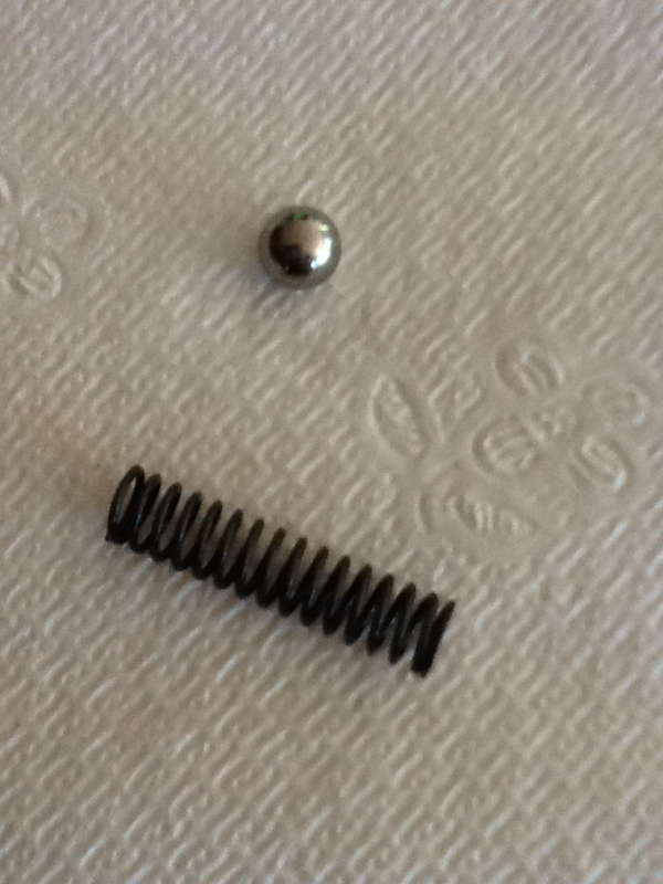

I completed changing my hydraulic fluid on my B3200. In the waste fluid I found a spring and a bearing. I don't have the manuals from the previous owner so I pulled different bolts looking for the drain plugs. Please offer any advice on where these items belong and in what order.

I would say they are likely to be a detent spring and ball.
Check your range and fwd-rev levers to see if they properly detent into position. I
think your PTO is electric.
