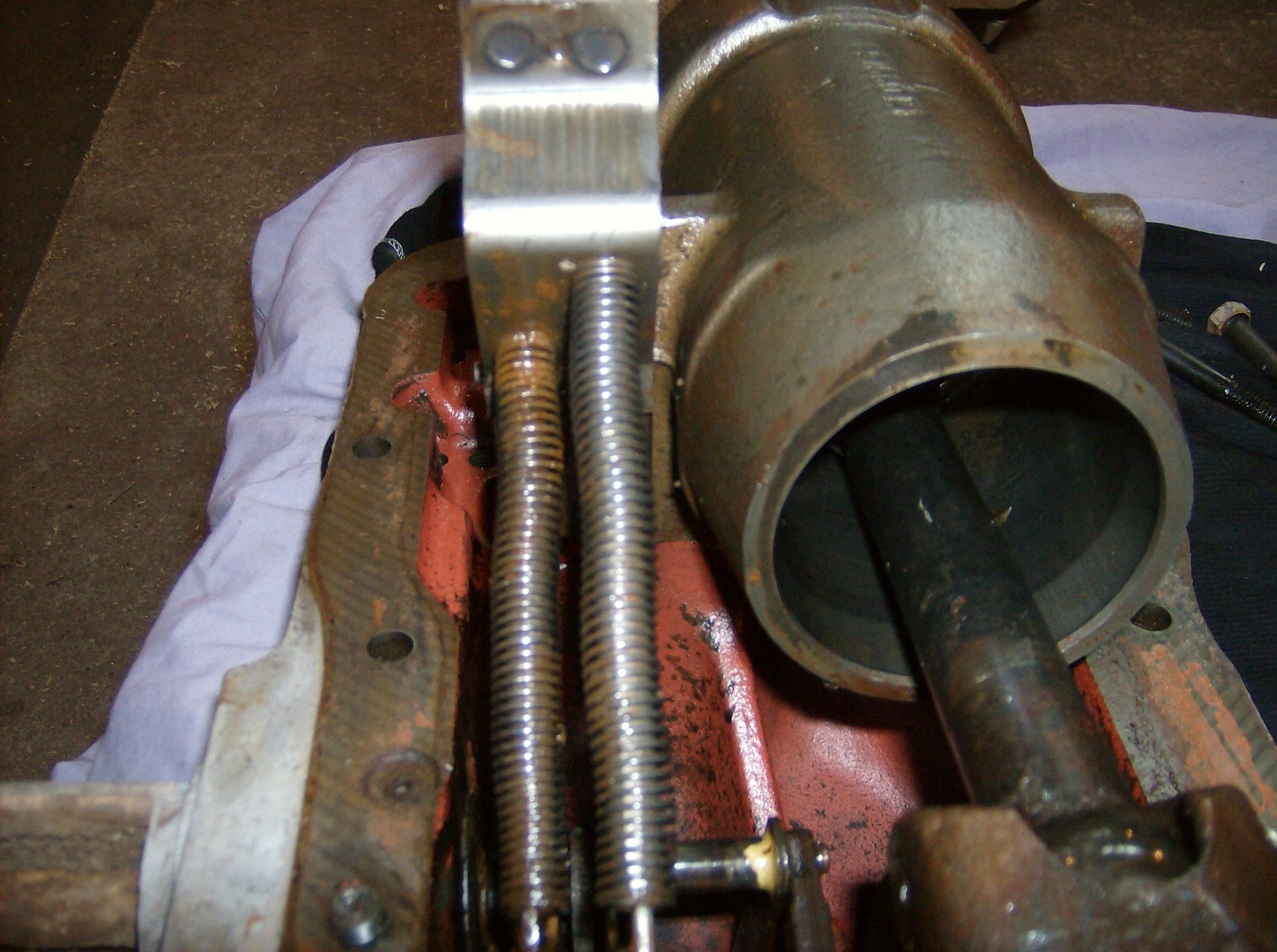

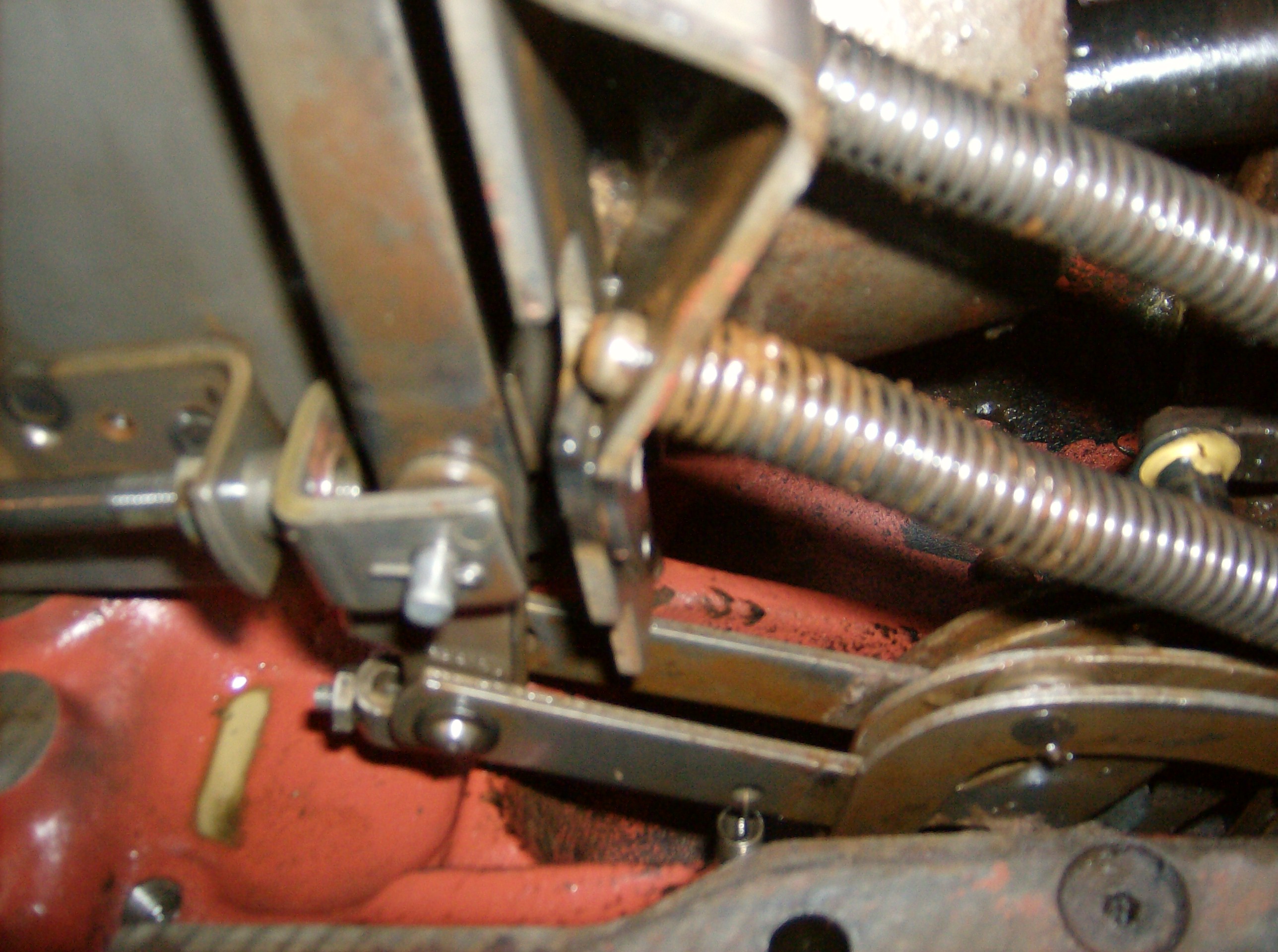

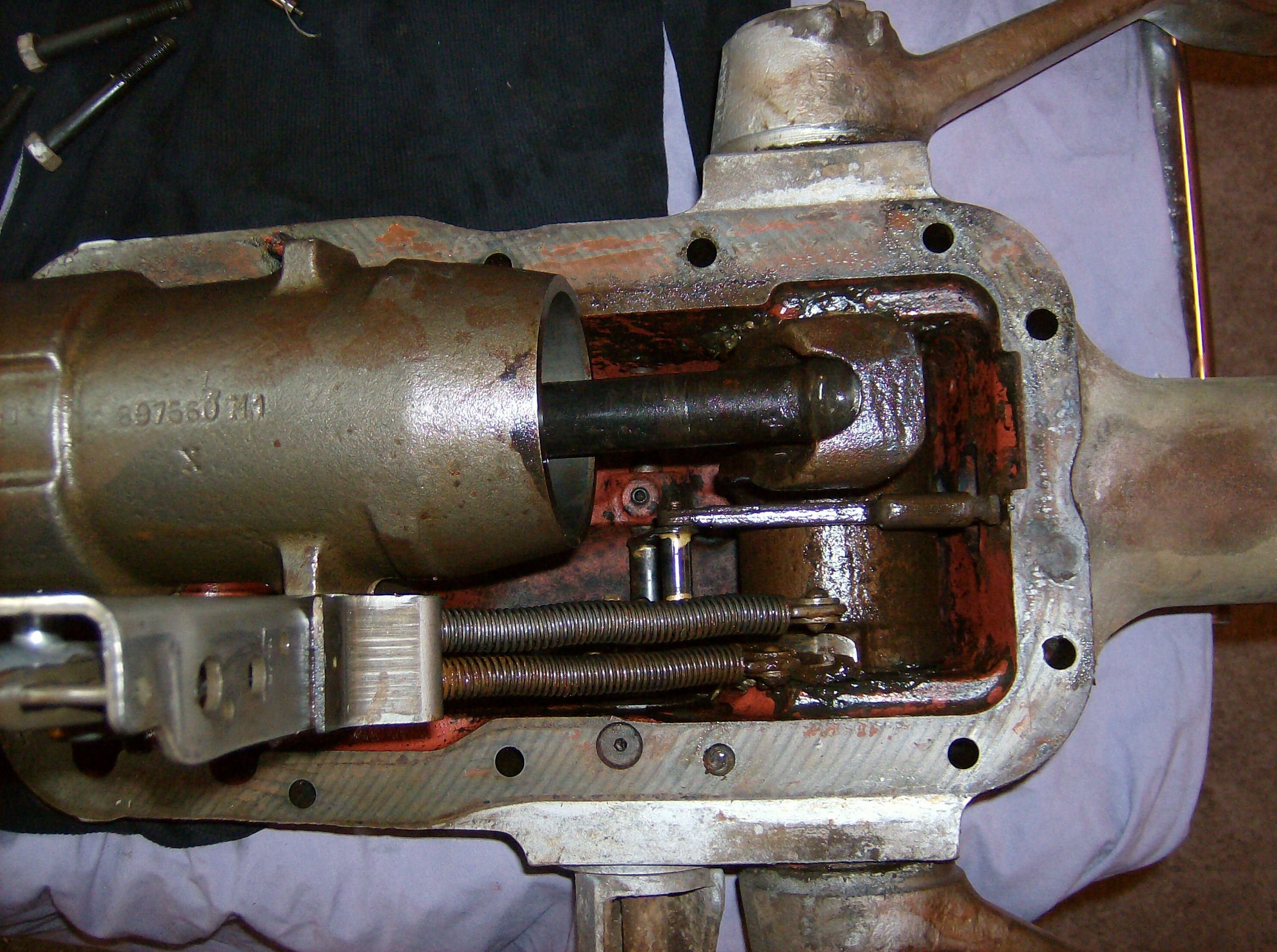

I have a 1970ish MF135. The 3point lifting arm will not come up. I removed the hyd head and drained the oil to change the filter. I found a spring in the bottom of the sump. It is 5 inches long, 3/4 inch di and light gage. Anyone know where it come from? I can not find it in any book that I have.
   / Found a spring in the sump #2
Here are some pics of when I had mine torn apart. The two springs in the images are the only two I remember seeing, but that was a little while ago and my memory isn't great.
Hope this helps.

Thanks for that Mike. Those springs are still there. This one is of lighter Gage and a little wider. If I can not fine what it is I will just leave it out and see what happens LOL.
