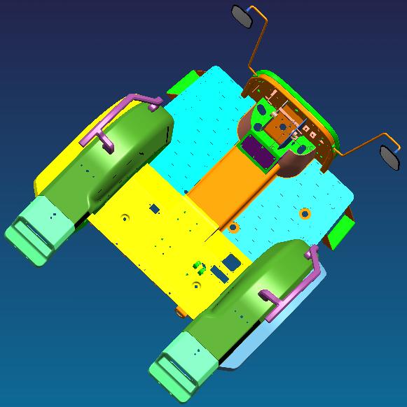

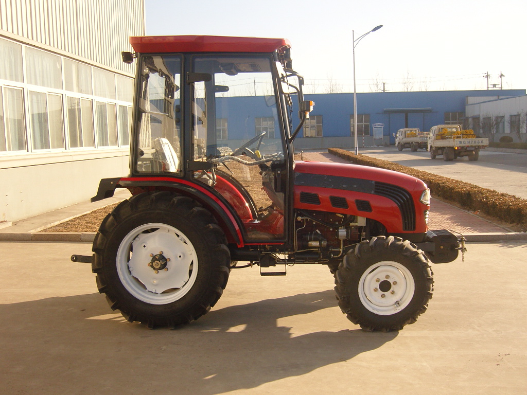

1、3 or 4 Cylinders Tire 4 engine

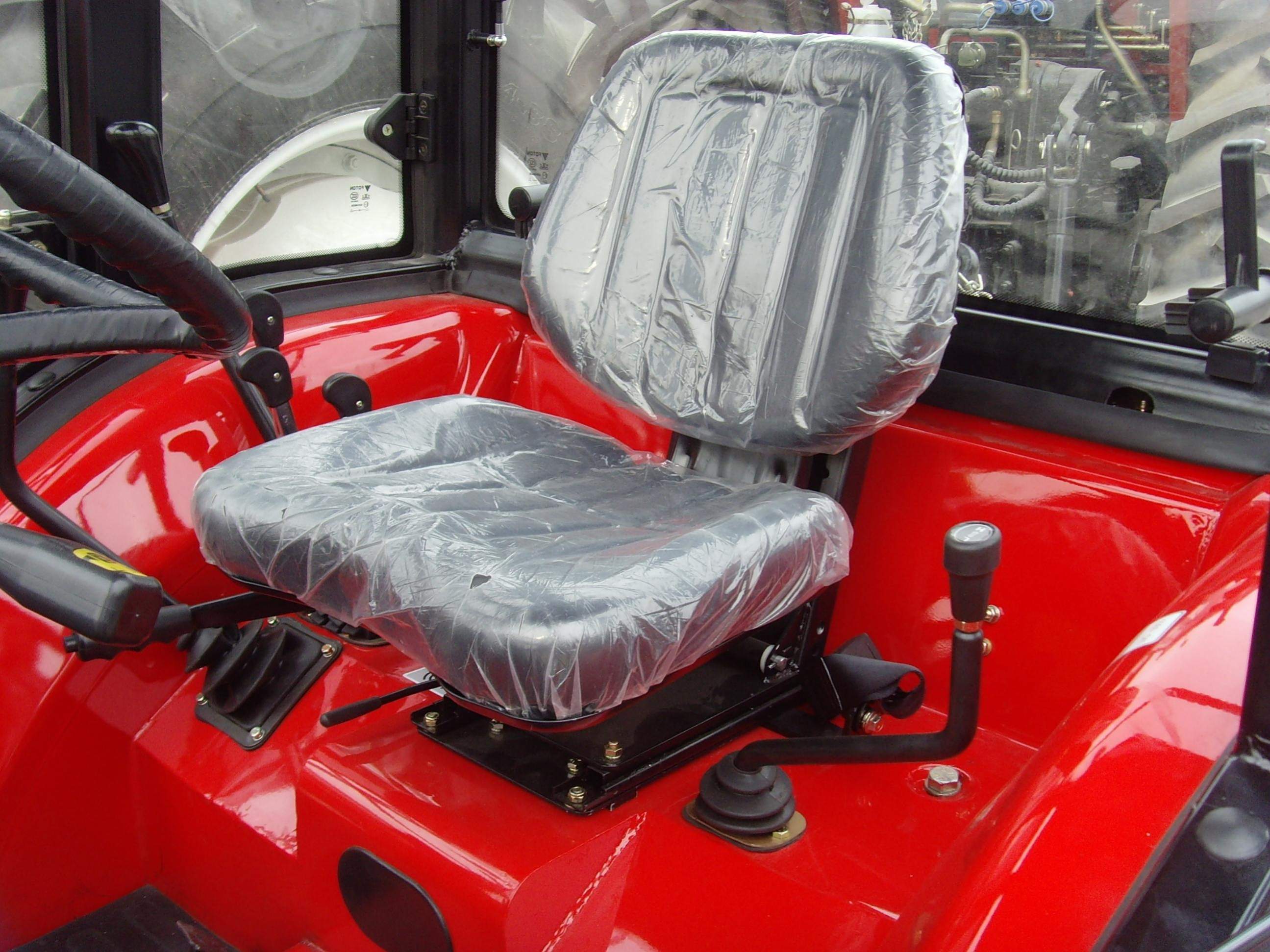

2、Semi-flat with more leg room and full sealed of deck and fender

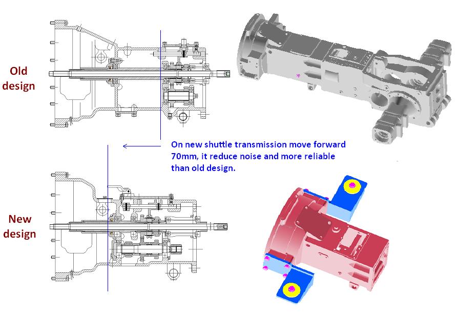

3、Update 8F+8R shuttle gear shift
4、Side shift & bigger seat

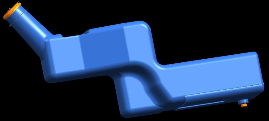

5、New fuel tank

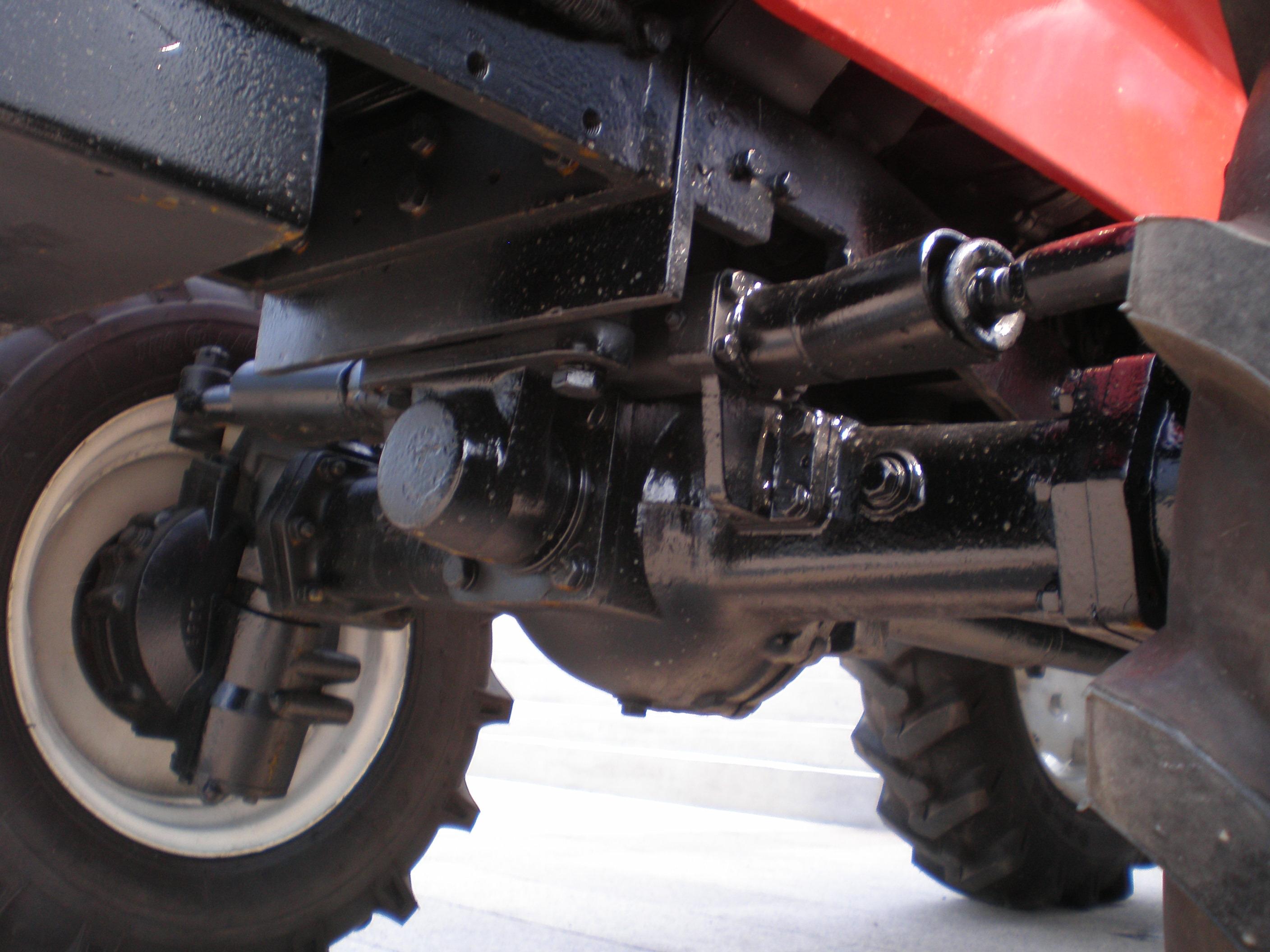

6、New central steering cylinder portal axle
7、Inner muffler and exhaust pipe
8、Auxiliary hydraulic oil tank、heater cab as option
/ FOTON NEW TE tractors #2

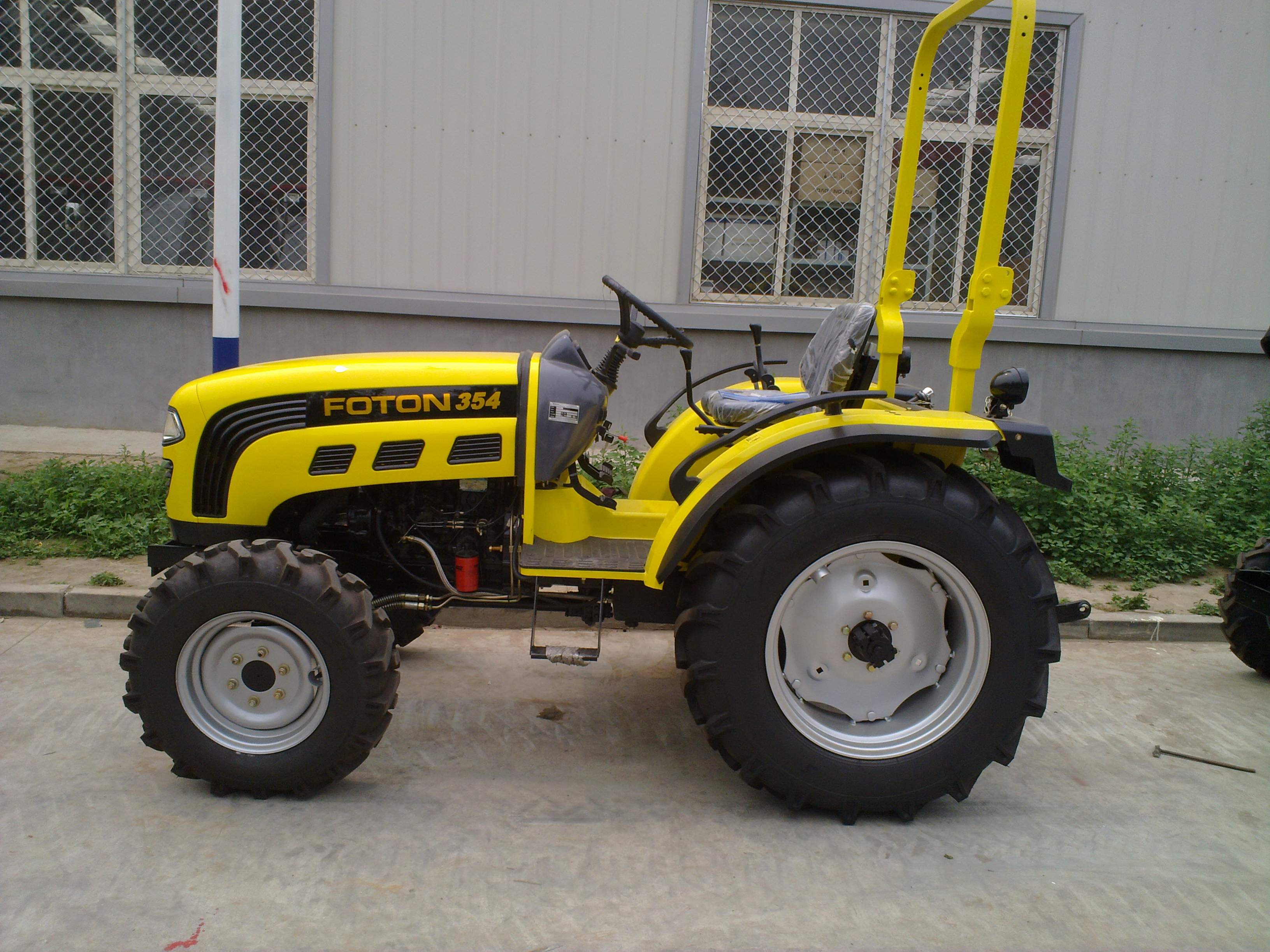

Good to see that Foton LOVOL are updating their tractor models.
This new TE354 looks slimmer and more ergonomic, thanks to the semi-flat floor deck, hanging pedals and all the gear sticks out of the way. The cab option seems spacy too.
I expect the shorter shuttle gear shift housing implies a lesser volume of gear oil is needed, which is a positive side effect, apart from the primarily mentioned reliability and noise reduction.
Are these images from a prototype product, or when can we expect to see this newer Foton TE series in Europe and US?
We are having the Foton FT404 (TB404-X161Y1C-QP) ourselves, bought last year. We hope that also some redesign attention has been paid to details, such as the most annoying problems we've yet had with our tractor after 210h work, namely we've broken both the hand accelerator wire and the hand brake wire. Both replaced on warranty of course.
