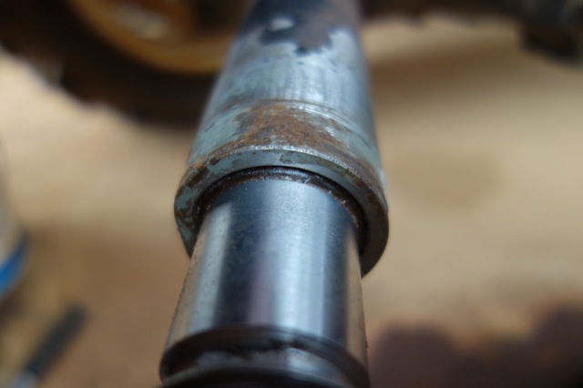

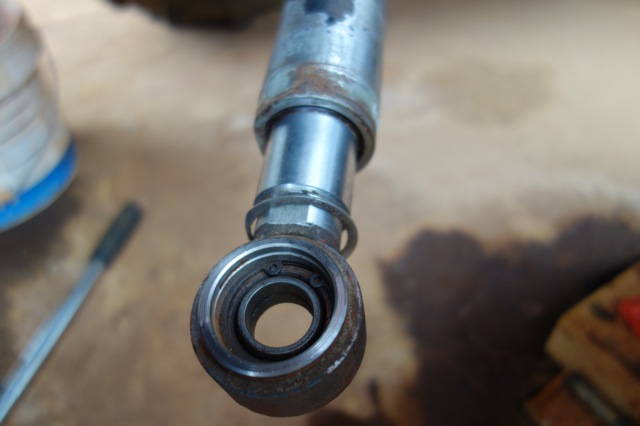

Apr 24, 2014 / Foton 404 Hydrolic steering seals - Replacing them #1 D djmcneill New member Joined Apr 24, 2014 Messages 2 Location Perth WA Tractor Foton 404 I have had a good look at the hydrolic ram and for the life of me I can't see how to remove shaft in order to get at the seals. Has anyone any clue on this? Don.

Apr 24, 2014 / Foton 404 Hydrolic steering seals - Replacing them #2 G Goaliedavid Member Joined Apr 2, 2014 Messages 44 Location Yale Michigan Tractor Jd 410 Could you take a couple of pics of the cylinder, everyone that builds cylinders seems to have a different idea on how to retain that packing gland

Apr 24, 2014 / Foton 404 Hydrolic steering seals - Replacing them Thread Starter #3 OP D djmcneill New member Joined Apr 24, 2014 Messages 2 Location Perth WA Tractor Foton 404 Thanks for your reply. Here are a couple of photos.
Apr 24, 2014 / Foton 404 Hydrolic steering seals - Replacing them #4 Winmac Gold Member Joined Dec 31, 2011 Messages 366 Tractor Landini 6860 Pictures of the complete cyl may be needed to confirm but I suspect it's a welded assembly. Often times they can be cut open and repaired.
