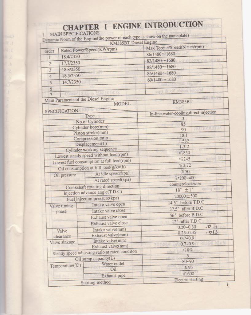

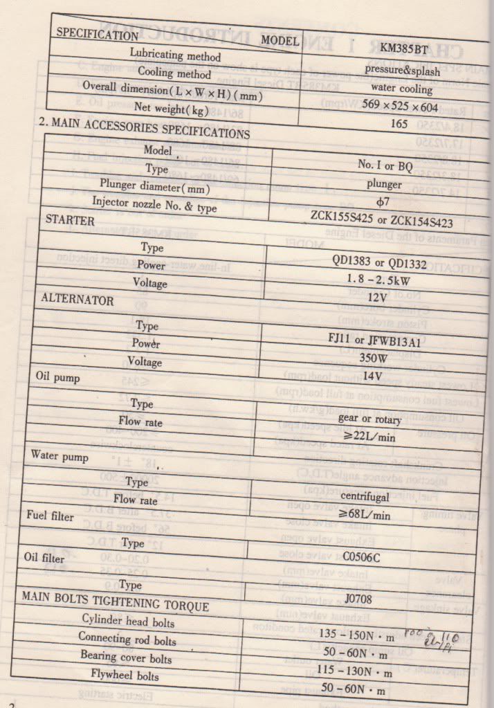

I've got a KM385 (EPA) The engine has about 300hrs on it and the heads have never been torqued nor has the valve lash been checked. I took the valve cover off and measured the valve clearance and found 5 of measuring between 0.020" to 0.024" but one exhaust valve had 0.028". From what I read its supposed to be 0.011" for the intakes and 0.013" for the exhausts. Before I start setting the valves I need the cylinder bolt torque specs to re-torque the heads first.

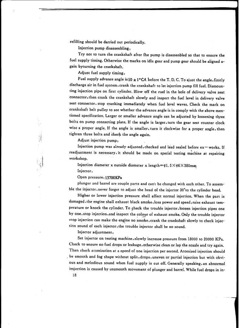

I also want to check the fuel pump timing. I am referring to this post for the method but if someone has a better method I would be open to doing it another way.

The timing should be set at 18° +- 1° BTC as what I see on the KM 385 specs. It has to be check by the spill check method.

The timing should be set at 18ー +- 1ー BTC as what I see on the KM 385 specs. It has to be check by the spill check method.
Is this the same method described in post #11 in this thread? Also I can you confirm that the timing is adjusted by turning the pump via the nuts in my second image above?

I only have the service manual for the tractor and the engine section isn't in it but I will try to get one. Thanks for photocopy of your manual. Do you have the torque specs for the cylinder heads and the rocker assembly nuts?

   / Foton 254: timing and valve clearance specs #4
Yes, the nuts holding the barrel and plungers.
Yes, timing is acheve by rotating the entire pump.

Thanks for replying. When you get more time could you check for the torque of the rocker shaft nuts. No rush.
   / Foton 254: timing and valve clearance specs #6
Hello Dotcom,
There is nothing about rocker arm torq in the manual.
For the rocker arm torq, you can use a standard bolt torq chart that can be found on the net. Or just use your common sense and it will be very good also.
Jacques :)

The previous owner worked on the injection pump high pressure piping to fix a leak. I just wanted to verify it to make sure it was within spec. Also I want to verify the spray pattern and popping pressure of my injectors. I have everything apart and I'm going through it with a fine tooth comb while I have the time. The tractor just needs to be ready for November for snow plowing so I am taking my time and learning as I go. :)
I did re-torque the head bolts to 125ft/lbs and torqued the rocker bolts wrist tight and adjusted the valves. My valves were out quite a bit I'm sure I'll notice a difference. :)

This is what is in the manual about timing.
They talk about a 10° and on the other page of specs. they say 18°. :confused3:
I realy don't know what the 10° is.
Now, while rotating the engine CW from front the lower mark will reach the white arrow first then the second one and the last (on top of the photo) must be TDC.
My guess of the lower mark: is timing with full advance of the gear in timing cover.
Then the second mark: is the 18° timing setting.
If someone have a better understanding, just feel free to say it. I prefer the truth than a false guess.
One thing I note is the relation of distance of mark VS the diameter of where they are on, it match.
Jacques :)
