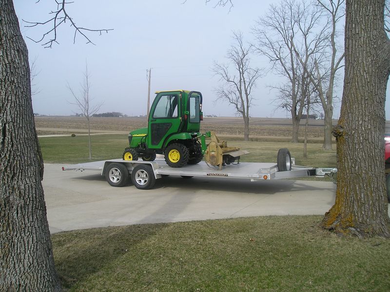

I like backing on. I have a cab and I think the rear window would be easier and cheaper to replace if hit by a rock at 50 MPH.
