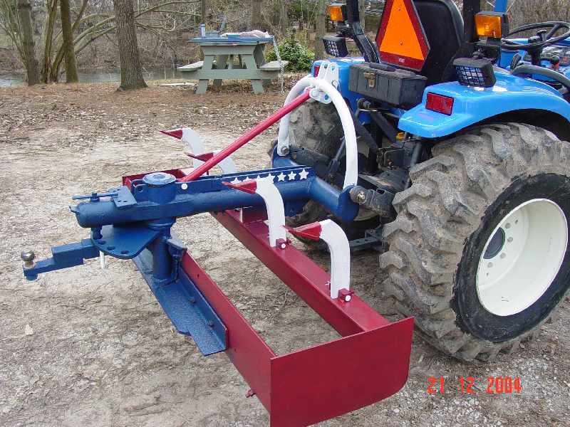

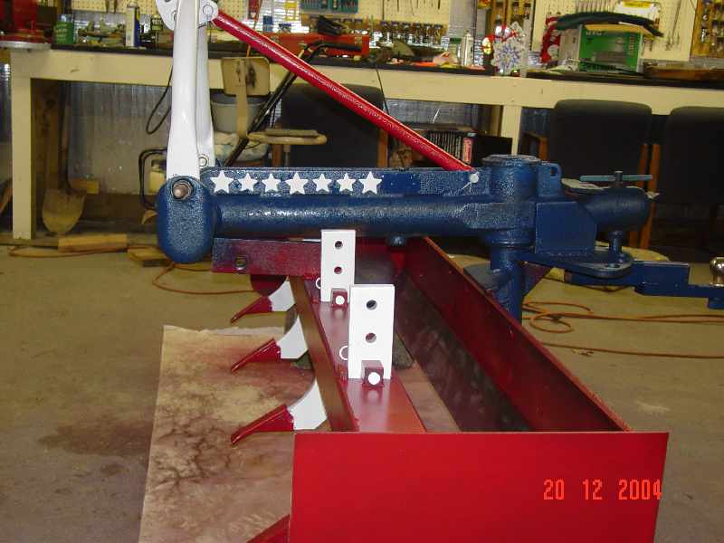

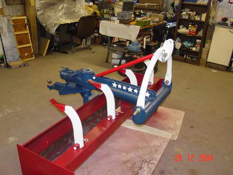

I took and old Danuser Blade, Says it was made in Fulton Mo. I welded !/4" plate to the sides, cut rectangular holes in a 4" square tube and welded it to the side plates. I purchased the scarifying blades from TSC. I turned down some 3/4" steel to 5/8" and drilled the pin holes in the ends for the clips. Added some holders for the pins to slip into and reinforced the top and bottom where the blades are. I made a 2" receiver with ball and welded it on for towing.
Painted it up for the good ol US of A and here it is ready to dig.

Here it is with the blades up for gravel and dirt spreading

I think that is the first box blade I have seen that pivots like a rear blade. /forums/images/graemlins/shocked.gif
Nice paint too... /forums/images/graemlins/smile.gif Almost too pretty to want to use.

Do you keep your digicam in the Pelican case on the bench to protect it while in the shop? The blade looks good! I wonder why no box blades come with tilt built in?
   / Forth Project ( USA box Blade) #6
wow nice job, how did ya cut the holes plasma cutter or mill them with an endmill?

Well done. Good lookin' blade. It does, however, appear that the teeth on the scarifiers are upside down.....BobG in VA

Here it is hooked on and ready to go, I Saluted it, hopped on and bladed the driveway! /forums/images/graemlins/grin.gif It worked very well for Goverment Issue /forums/images/graemlins/smile.gif
