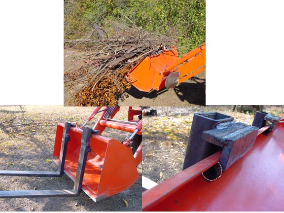

Here is a pic of my forks. I have been using (and abusing :( ) them for a couple of years. On level ground I can set the forks flat on the ground and "uncurl" the FEL and then (if I don't knock forks over) ease back into place and curl the FEL and have the forks ready to go.

Nice setup. That looks like it puts a lot of stress on that bucket lip. Have you thought of beefing it up any? Here is a simple mod you can make to keep forks from falling over.
  • Fork modification.pdf
