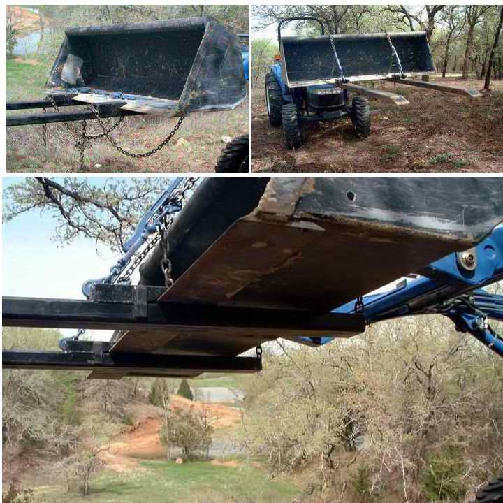

My forks aren't perfect, but they sure are easy to install and they hold more than my loader can lift. (see attachment) I think I paid about $270 with the chain binders.
   / Forks that clamp on the bottom lip of a FEL #7
Interesting setup. What actually carries the weight, the chain or the lip of the bucket or both?

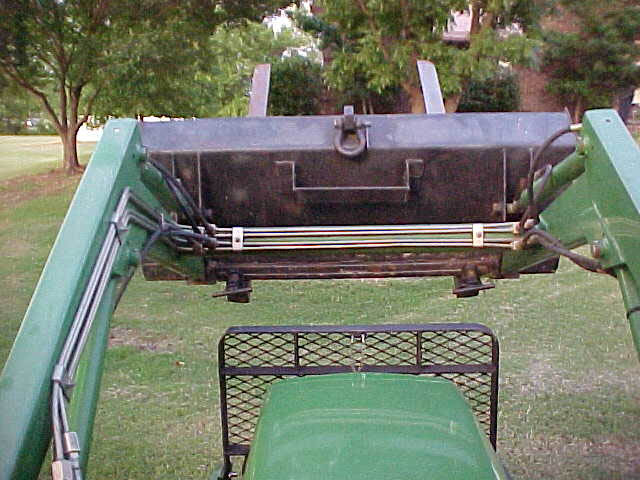

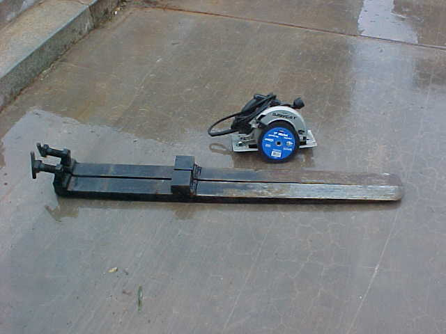

Here's a pic of my forks. A bevel on the front blocks catches the bucket lip. The bolts in back are tightened by hand, then snugged with a hammer. They don't pivot. I don't know if it's worth trying to modify your forks to catch the backside of your bucket, but it's a possible solution to unwanted pivoting.

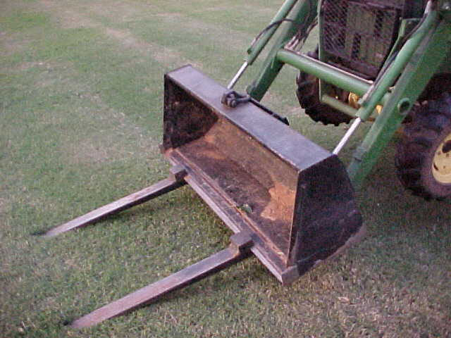

Here's a shot with bucket forks attached. I welded a thin strip of metal along the bottom of the back of the bucket to catch the fork bolts and keep them from slipping off.
OkieG

Whether you're adjusting a log pile or compacting brush, exerting down pressure with the forks is very handy. Bolting to the back of the bucket allows that. Here's a pic of the forks holding the front of the tractor off the ground.
All that said, I would like one of my next projects to be building a dedicated fork frame for use on both the 3PH and loader frame.
