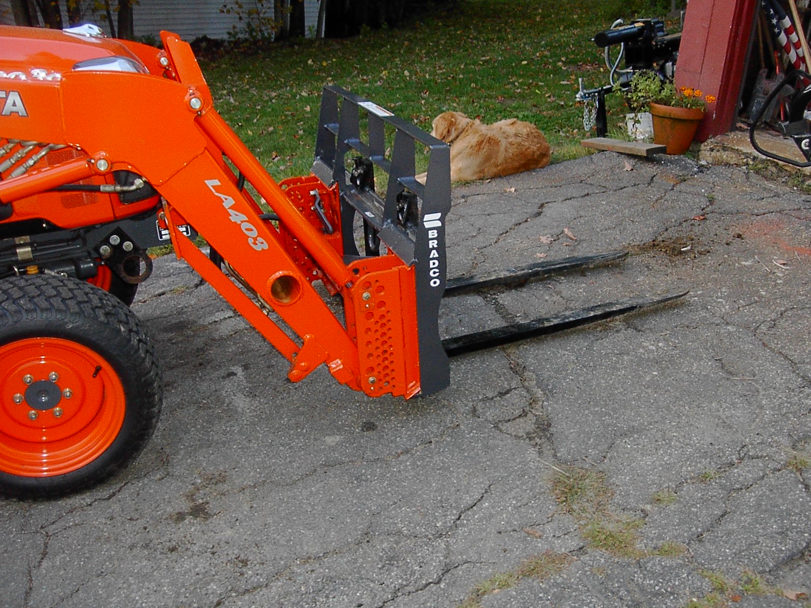

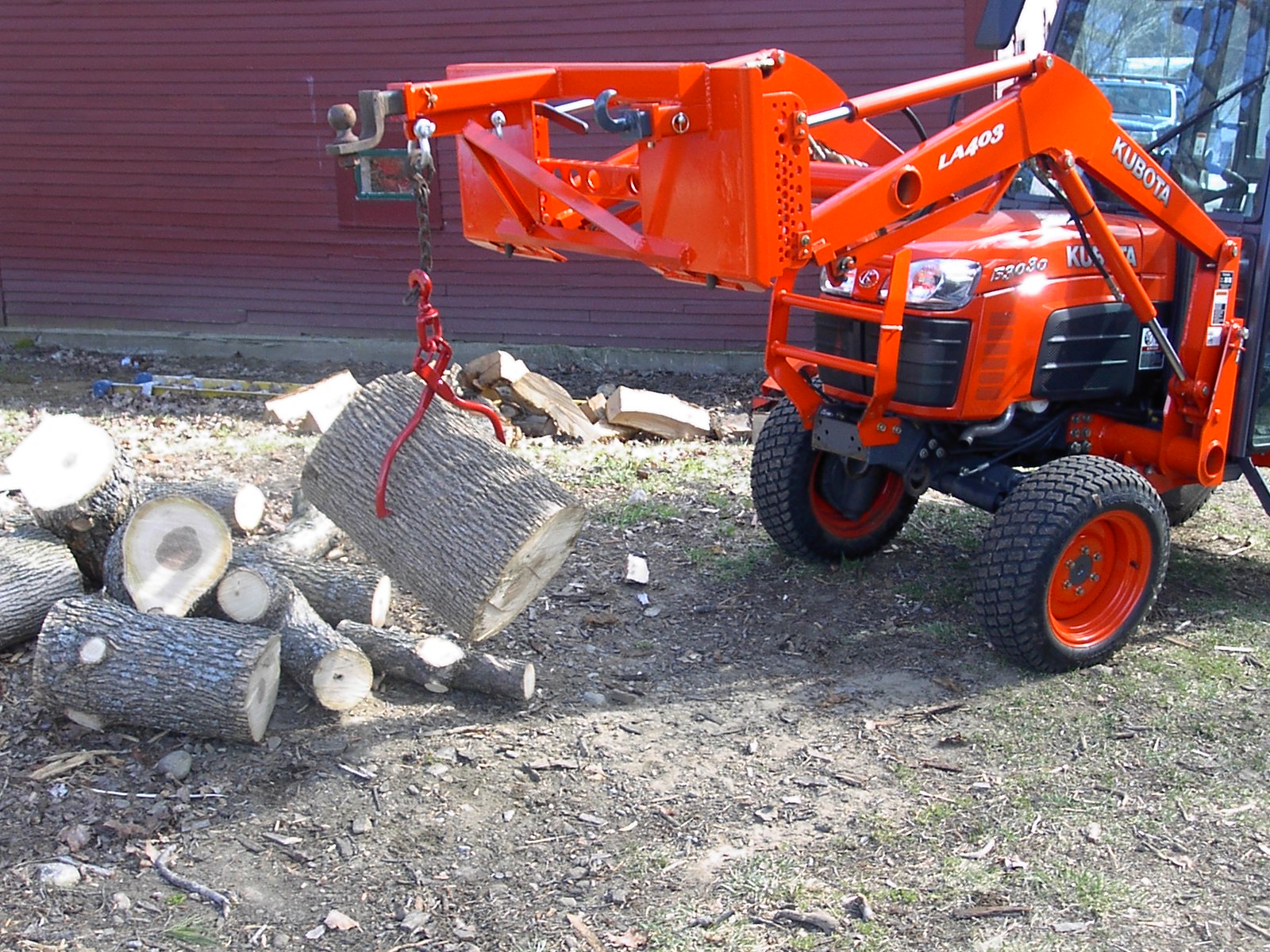

For the tractor side of the SSQA, try your local Kubota dealer. Some of the factory Kubota units are priced affordably. When I added a SS style QA to my tractor, I added the QA plate to the back of bucket myself...... and bought a light duty set of forks from Bradco. I have said over and over....... changing my loader over to a SSQA was the single best thing I ever did to my tractor. I even welded up a simple attachment for lifting things and moving my trailers around the yard. Next will be a bucket with teeth and a SSQA to three point attachment, so i can use my york rake on the loader.
