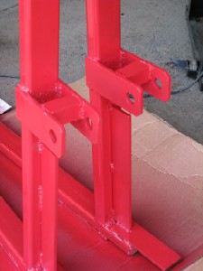

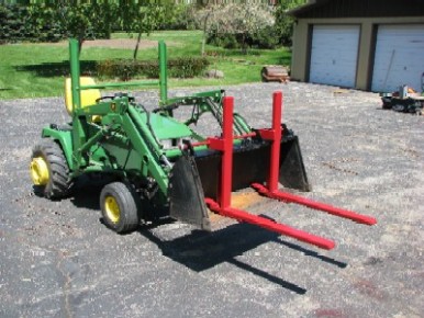

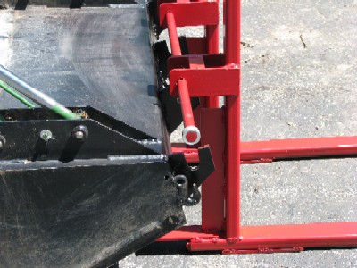

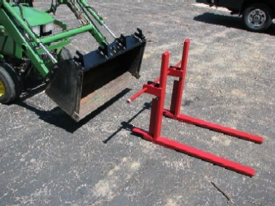

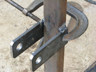

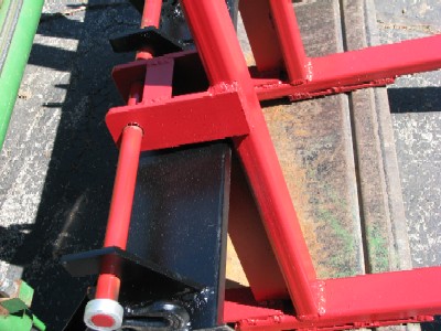

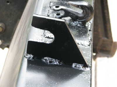

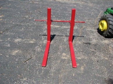

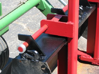

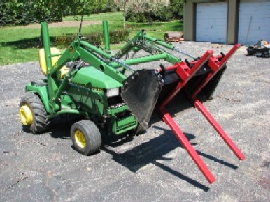

I welded up a set of forks for moving logs, brush, etc. It is quick attach and detach.
Drive up to the fork, roll the bucket forward, drive under the forks, roll the bucket back to hook up the forks, and go to work.

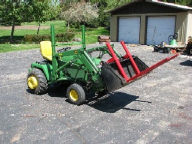

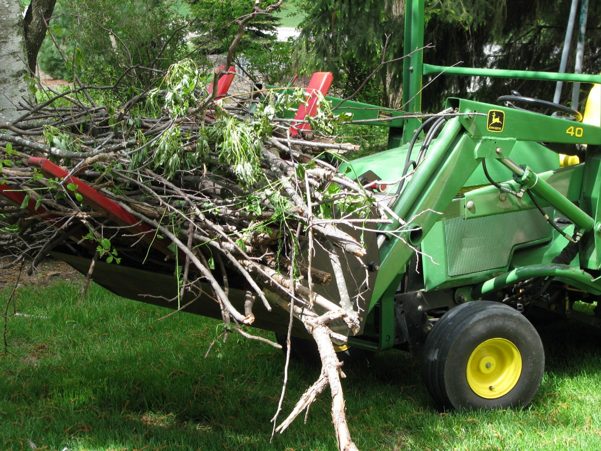

Forks at work - yard clean-up J
