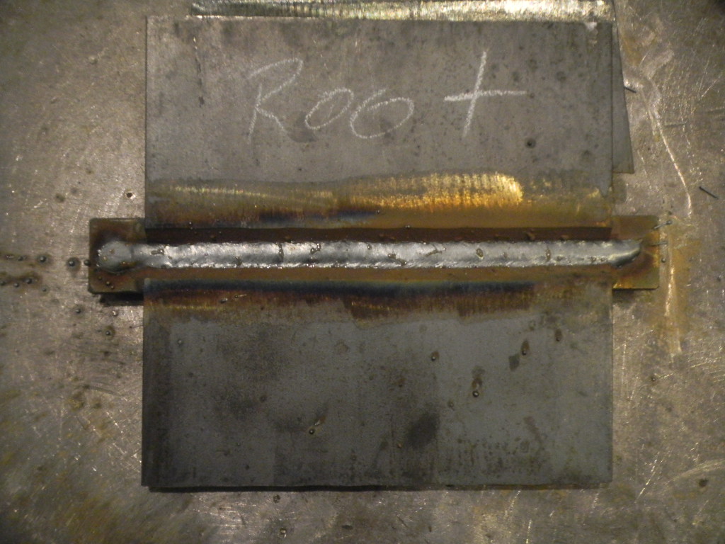

Hard to believe anybody would build an AC Mig machine. Never heard of such nonsense!:confused:
I got to play with member here roadhunter's Everlast i-MIG 140E. With Lincoln's .030" L-56 Mig wire it has a real sweet arc.:cool:
Power i-MIG 140E - MIG Welders | Everlast Generators
