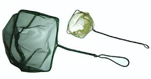

Get one of those long handled dipper screens that people use with their fish tanks, bend the wire around the net so it'll fit into the neck of the tank the tank and go fishin'!
