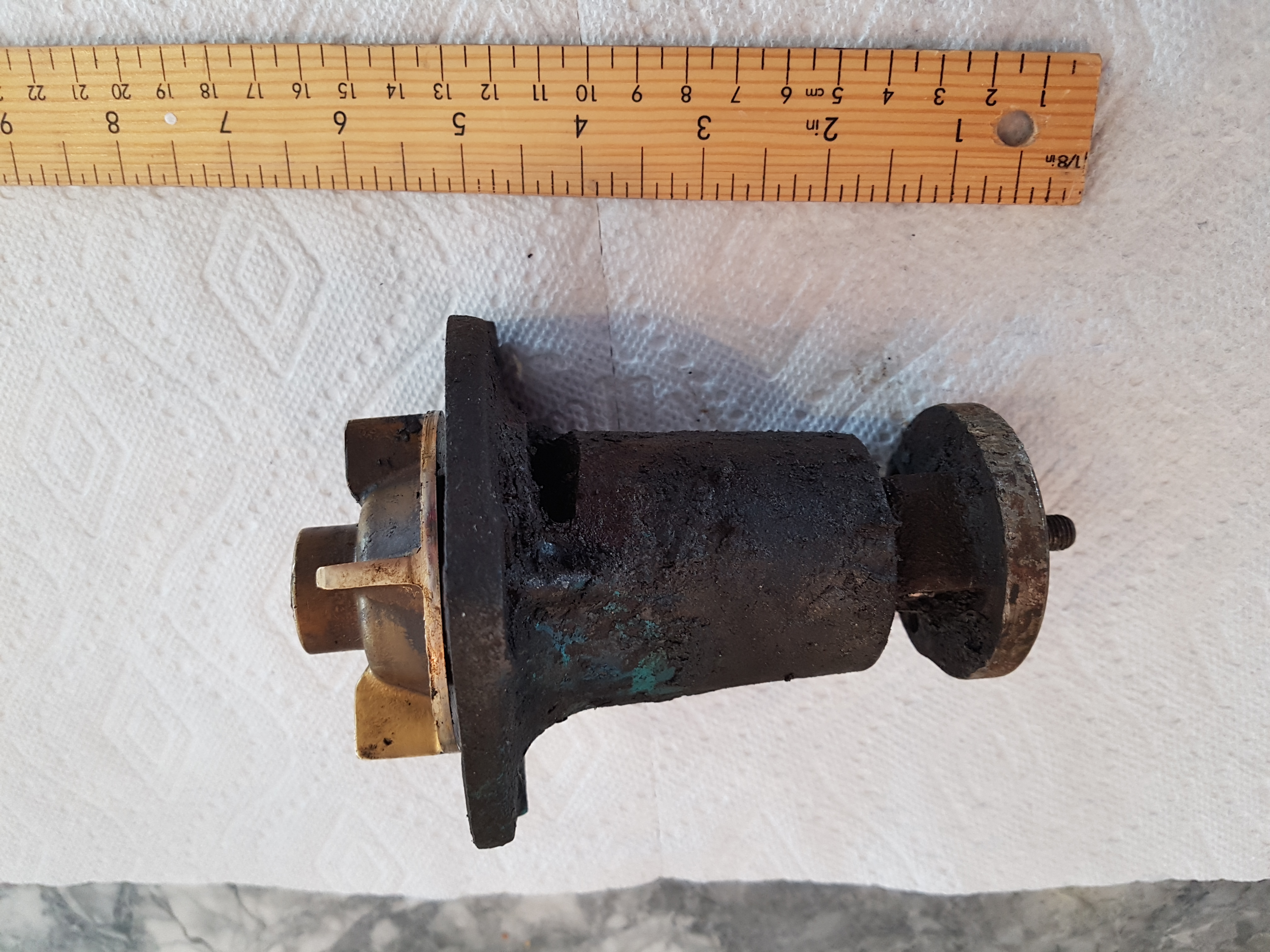

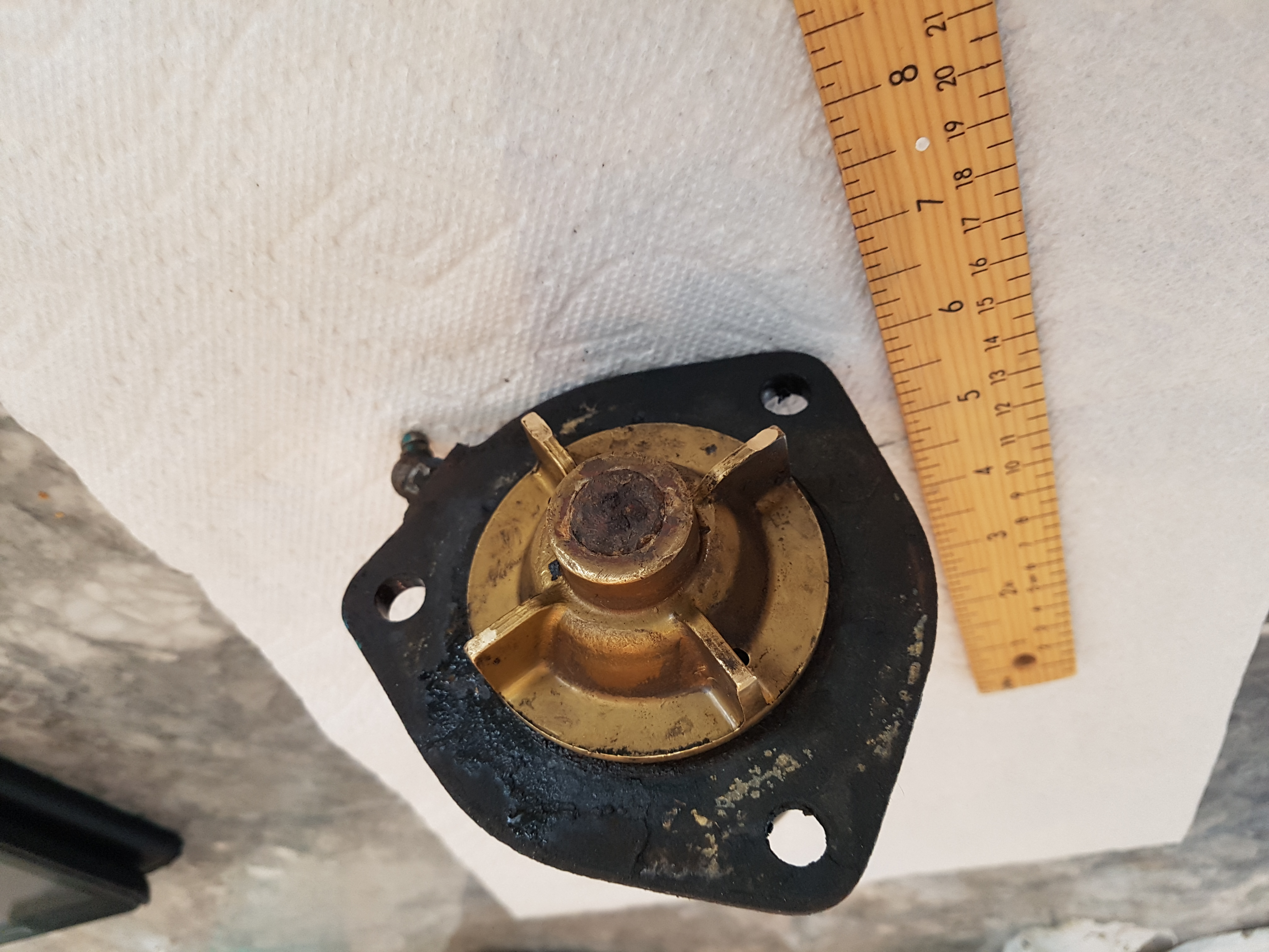

Fordson Dexta 1961 gas engine
Looking for part number for water pump or water pump repair kit and or store URL for ordering
Included pictures of water pump
Thank you very much

I tried contacting the OP to see how he got on with his repair, but did not get a reply. For the sake of others, this is what I came up with in 2022 for replacing water pump on my 1962 petrol Dexta.
Overall Pump Length Including Impeller: 160mm shaft length
Pump Body Length: 80mm
Impeller Diameter:- 69
The Standard Vanguard water pumps interchange with Ferguson TE and Triumph cars.
Massey Ferguson (TE20, 35) 1885489M92 is listed for Standard engine, with aftermarket casting number DA10779, (Bare Co B4845 confirms this fitment to Dexta.)
Sparex 40034 is referenced in their catalogs, but hard to find as a part.
Triumph TR2, TR3, TS, TSF, TCF, TR4, TR4A water pump part numbers: GWP202 CPA29 106969
(I bought pump 1885489M92 from Cross Creek Tractor. The body casting has boss for grease fitting, but not drilled since it uses modern sealed bearings. It also has a cast iron impeller. Same construction that seems to work fine on several ol my cars. On the other hand, I did find a Triumph water pump from an English supplier that looked like the original, with grease fitting. It was three times the price (with overseas shipping). Tempting to do a proper repair, but just couldn't justify for a working-tractor renovation. )
As a caution about Application vs Part Number, I also found listings for (Massey Ferguson 1810369M91, 1881807M1, Sparex S.43576 ) in some catalogs under the same MF tractor models. This pump has Overall Pump Length Including Impeller: 150mm Impeller Diameter: 60mm. Not the one we want, I think it is for Continental engine.
Very frustrating that descriptions for tractor parts tend to be by major application only and provide no supporting details!
