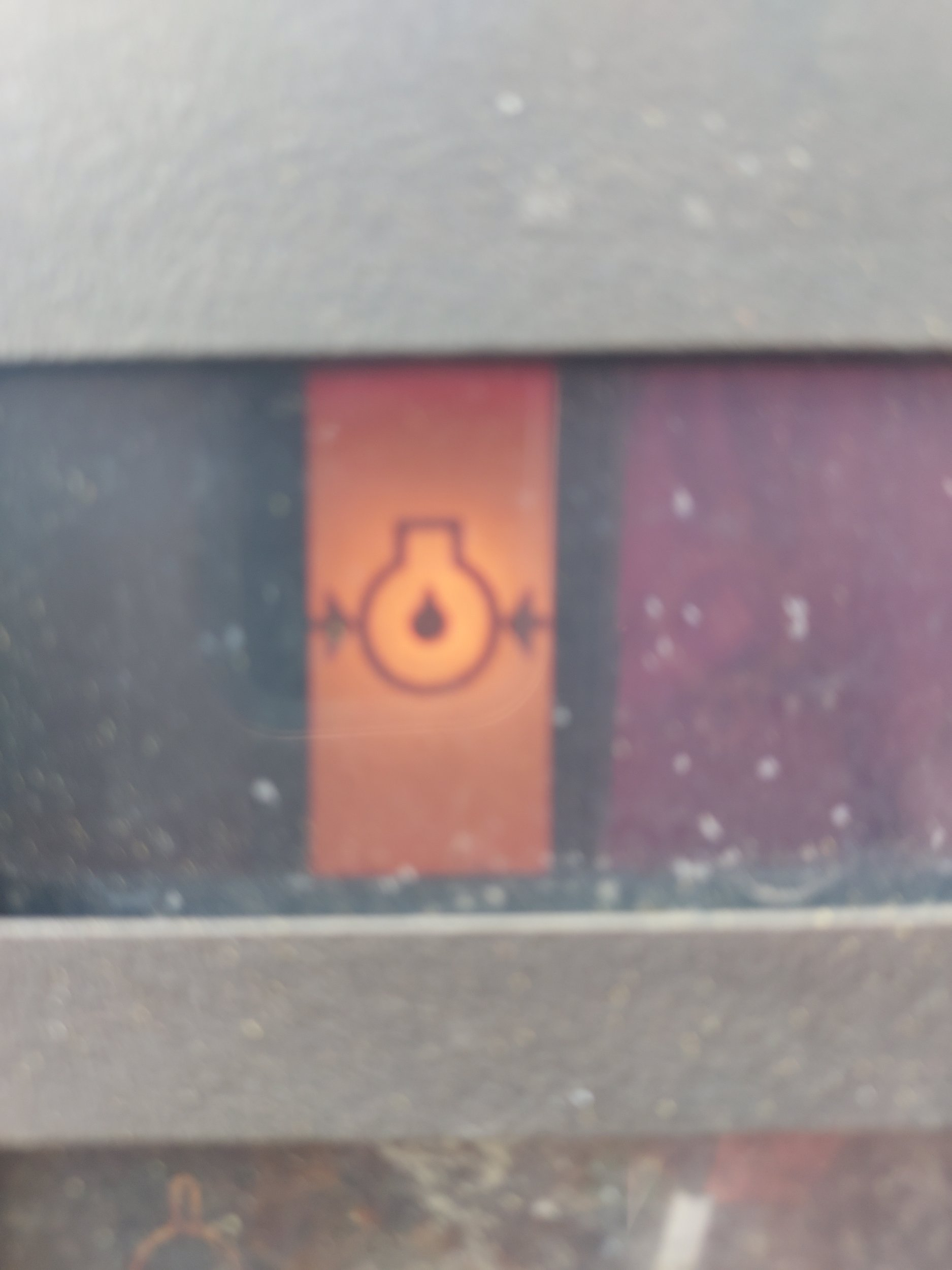

My backhoe has been running fine until today, I switched it off, then it would not crank, this symbol is on the dash. Can someone tell me what the problem may be?

Low or no engine oil pressure. It will always come on when the key is turned on, before starting engine. Not the reason for not turning over. Make sure the F-R lever is in neutral.
