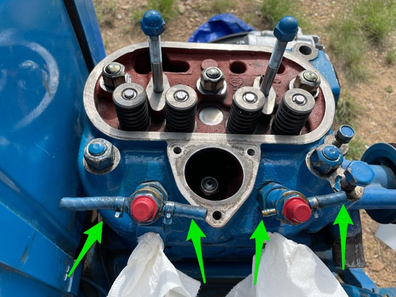

Can someone please show how these lines are connected (please see photo) Thank you for your help :)

they connect together and drain fuel back to the fuel tank. There should be a tube on the bottom of your fuel tank that they connect to.

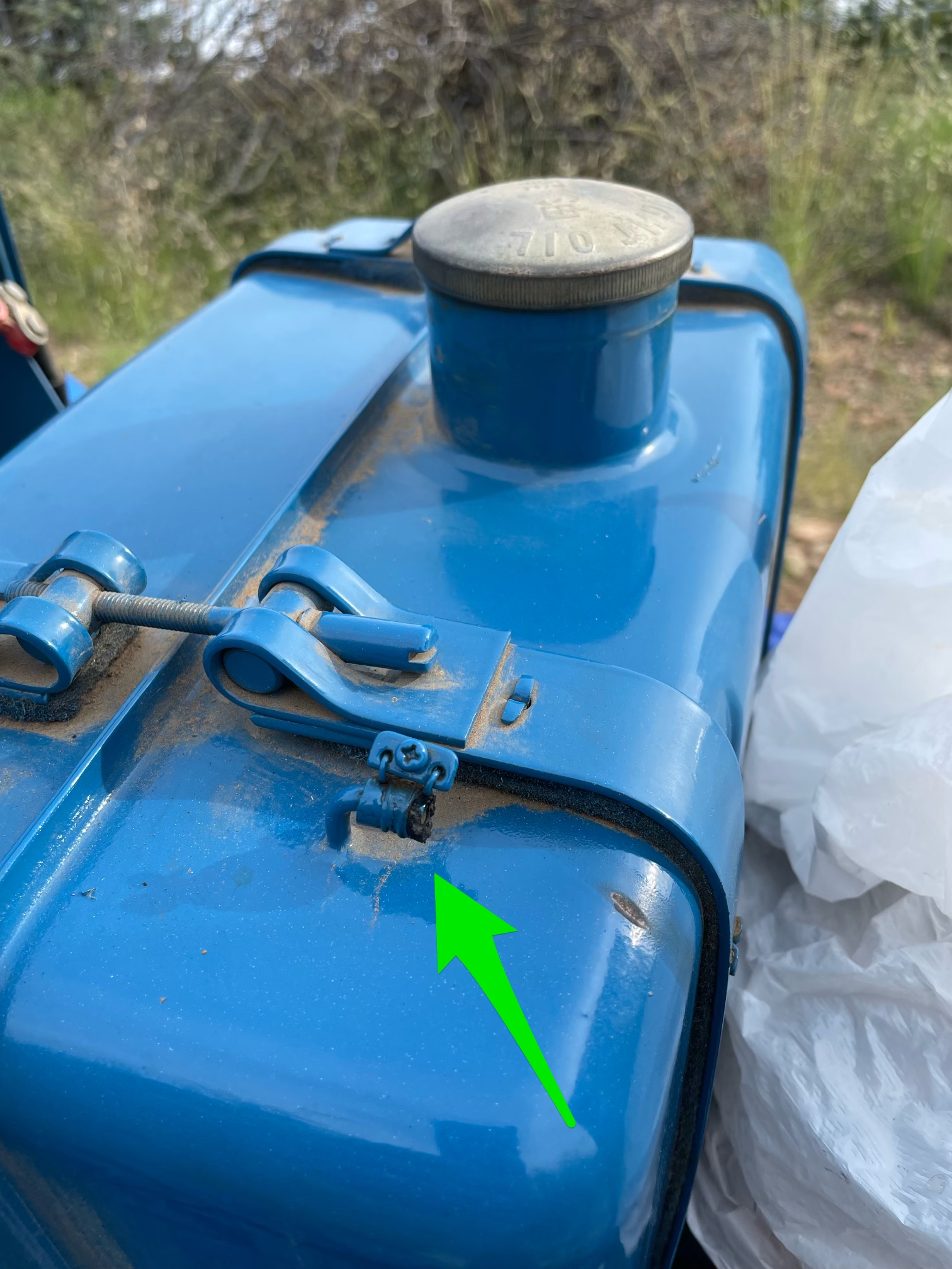

Awesome, thanks for the info. Is it possible it connects to the top of the tank not the bottom ..... I see a little fitting that looks like the same size tube etc... see attached pic

No that is where your vent line connects, at least it did on mine. There was another fitting just like that one in your picture on the bottom behind the petcock on my Ford 1110.

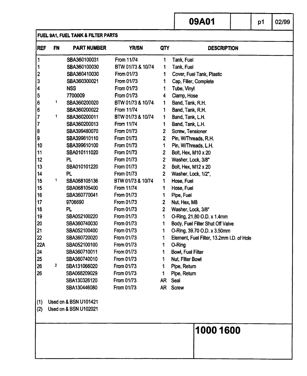

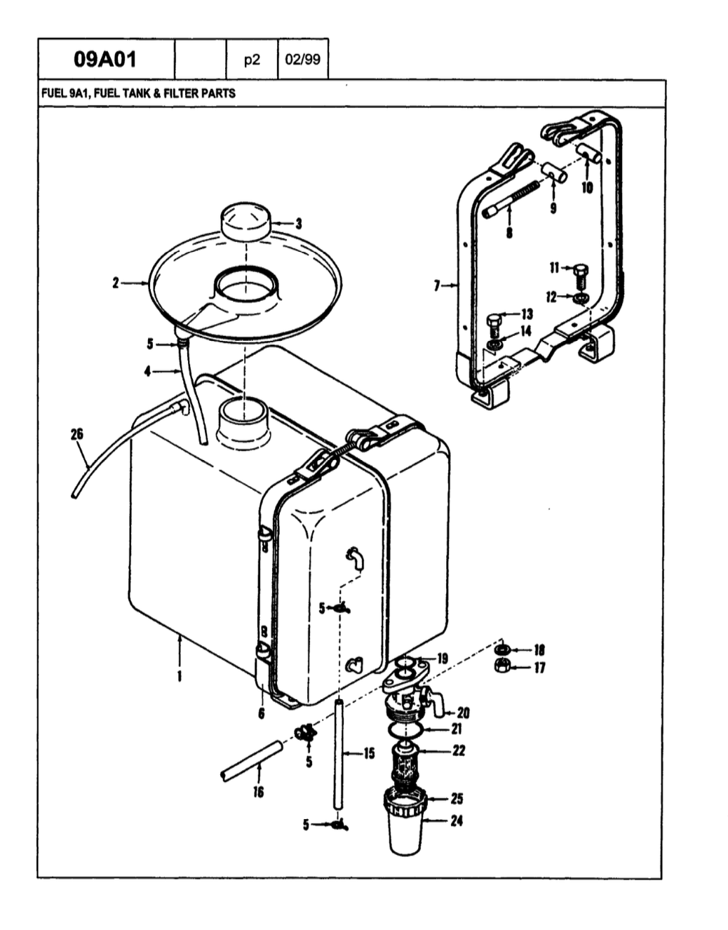

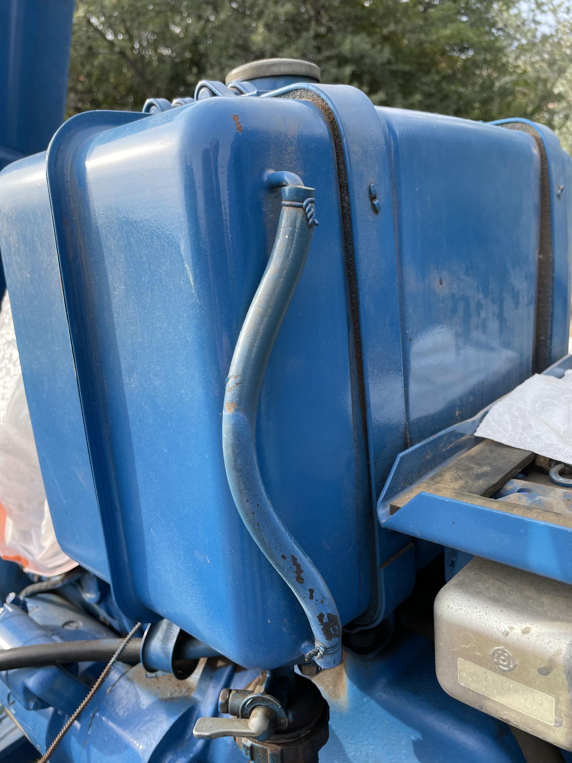

Hmm.... interesting ~ the tank on this tractor looks just like the attached pict from the manual. And it doesn't say where line 26 goes, it just calls it a pipe, return. Hmm return from what ? maybe the injectors ? And I attached another pict of the tank with the hoses on the back like the manual show ..... not sure its function ...

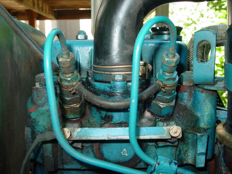

Just a typical one on my 1700. It combines all over flow from each injector and theb to the tank.
   / Ford1000 injector connectors
JC-jetro, yes that looks just like the 1000. Does it connect back up to the top of the tank like in the photo I posted above where the tube is broken off ?
I think that's where the fuel return line from the injectors should connect to:
And I think there should be a clear fuel resistant tube here which will act as a fuel level gauge:

   / Ford1000 injector connectors #10
Yes It does.
