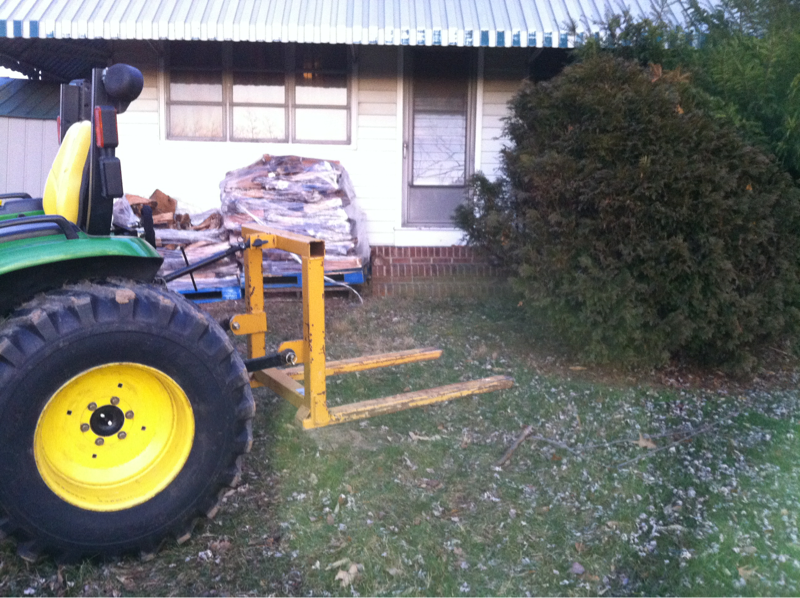

The front end problems on the 790 were caused by reversing with a loaded bucket and no ballast weight. No doubt the 790 is a tough machine. I traded mine because I wanted hydro and more lifting power. Also a little more weight. Check the specs to see if it will be strong enough for you. I shimmed the relief on mine and it still wouldn't do what I wanted as far as wood moving. I have a pallet mover on the 3 point. I can't comment on the ford.
