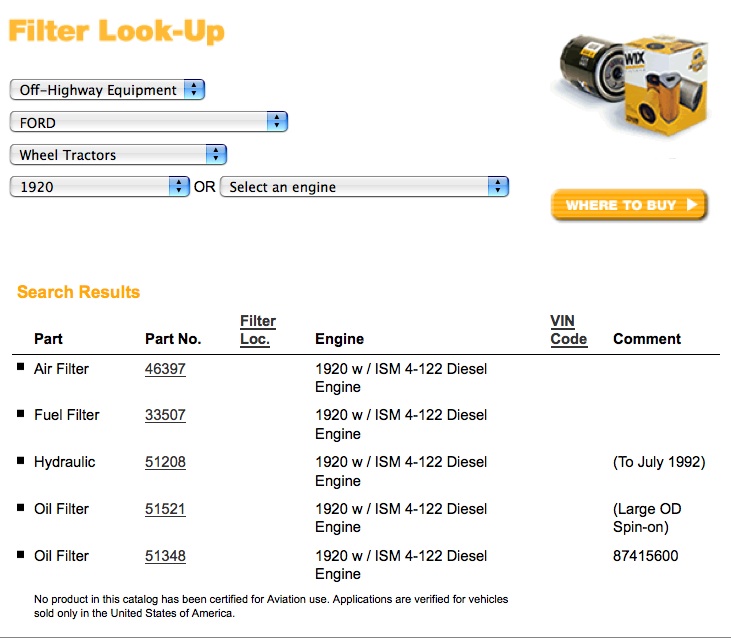

Wix Filters & NapaGold Filters: FleetFilter Secure Online Store
I found this website listed on TBn and I used it to buy my hydraulic filter for my ford 1920. Click on the WIX logo to the right and under off road vehicles you will find ford and New Holland filters.
By the way this website beat my NAPA dealers price by a lot.
