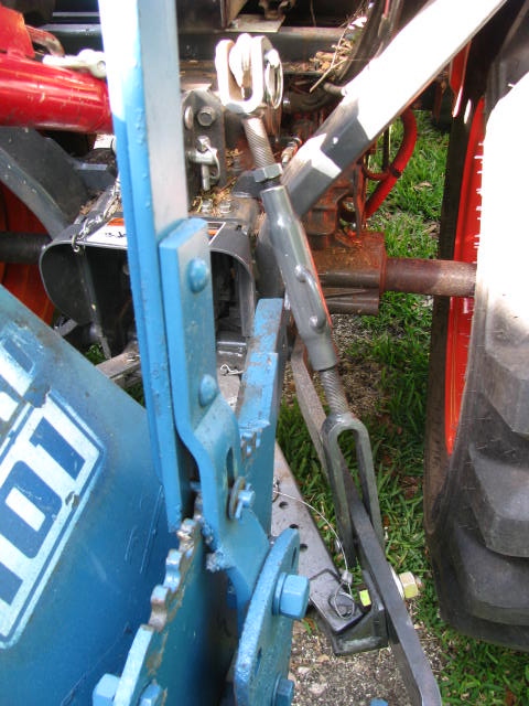

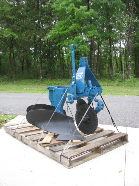

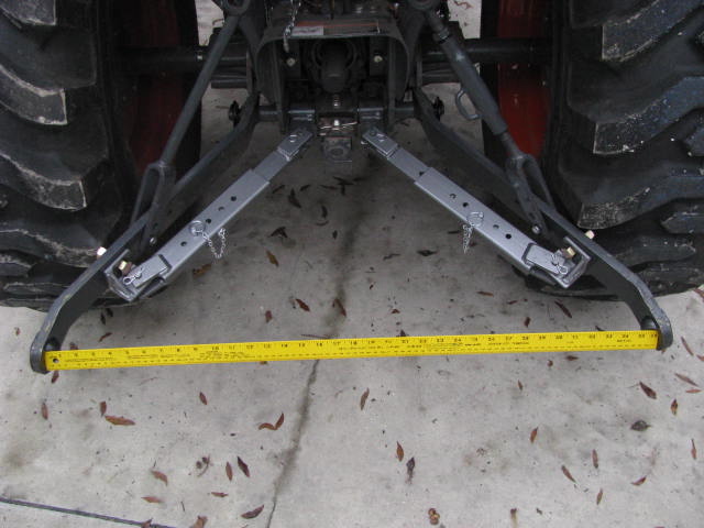

Common Carrier delivered this Ford Series 101, 2-12 Turning Plow yesterday, purchased from excellent Sweet Tractors.
I got plow off the pallet yesterday evening. This morning I am adjusting plow to my Kubota B3300SU / 33-hp / 1,900 pounds / 4-WD.
Harry Ferguson and Henry Ford worked on the Ford 3-Pt. design and implements together. I though this plow would go right on the Kubota 3-Point. But there is an issue with the massive First Beam on the plow interfering with the right (turnbuckle) lifting rod.
When the Landing Lever is all the way to the rear, the first beam rubs the barrel of the adjusting rod.
When the Landing Lever is in center position there is 7/8" clearance. Not enough clearance when plow and tractor are moving semi-independently.
When the Landing Lever is forward there is 1-3/4" clearance.
(Stabilwork's pin adjustable stabilizers are pinned to hold plow just to left of center between tires.)
When I get the plow working in the field any obstruction in the ground will make the First Beam smack into the lifting rod with 650+ pounds of inertia, likely ruining the lifting rod.
The plow cross shaft is in its "normal" position, one hole showing on the right.
I will be plowing on flat ground, sandy-loam soil, minimal rocks and those soft limerick.
WHAT AM I MISSING? i know there is a secret.....
One solution would be to take the First Beam to the welding shop and have them bandsaw off 6" but I am reluctant to cut this completely stock "classic" plow.
Surely there must be some adjustment, or combination of adjustments, I am missing.....
I have never owned a plow, I have never adjusted a plow, I have never plowed. [ Wish I could post this line in LATIN but I got kicked out of Latin class after three days. She said I would be sorry. ]

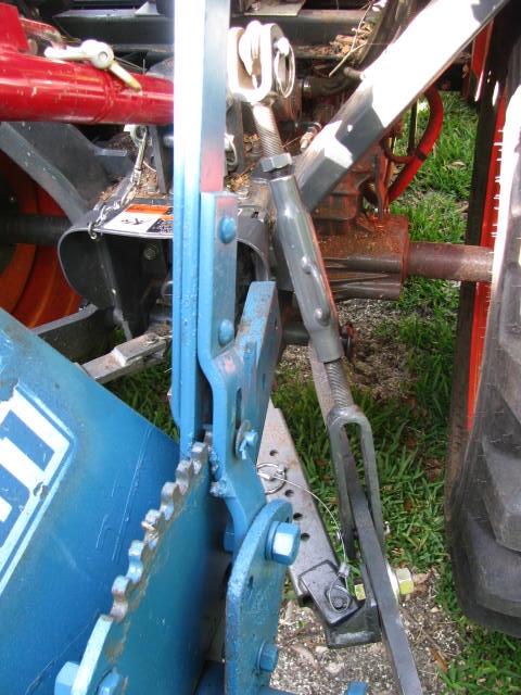

Photo #2 Landing Lever to rear; First Beam interferes with right lifting rod.
Photo #3 + #4 Landing Lever in center; some clearance.
Photo #4 Landing Lever forward; 1-3/4" clearance.
Minutia: Why are there both HEX and SQUARE head bolts on this plow? Is there an advantage to square head bolts in some applications?

How about a set of draft arm extensions..?? I have a set for my old Super C Farmall, that go one the ends of the fast hitch conversion tongs, to keep my finish mower back away from the rear tires. I tried to find a set, to show you an example, but can't seem to find them. It would cut down on your lift capacity some, but not sure it would be a problem with the plow. The old Farmall has no problem lifting a 6' finish mower, and the hydraulics on it aren't near, what's on your 'Bota.
It looks like the rockshaft arms are pretty close together, and the lift links are at more of an angle than on my Ford 2000. As nice as that plow is, it's be a shame to cut it off.
Ken (Sweet) may have some of the extensions, or give you an idea of what to do.

It appears that the entire three-point mounting apparatus can and should be moved forward to the existing forward holes in the beam. If this is possible then that would solve the interference issues because the beam and plow would effectively be moved rearward since you would have moved the mounting points closer to the tractor.

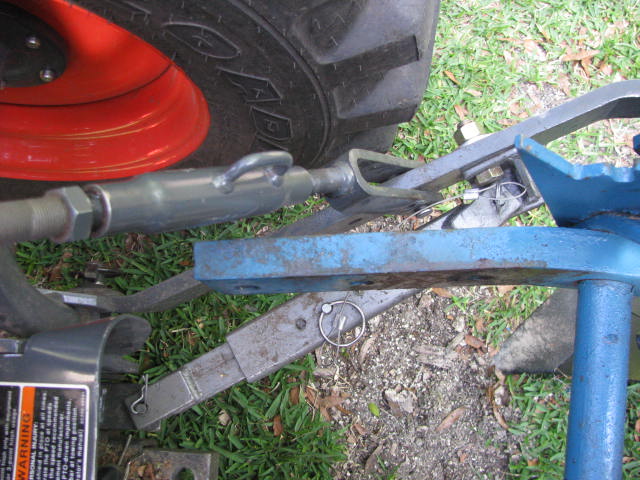

The easiest solution would be to cut part of that bar off- perhaps the plow was made to mount to a larger tractor with longer lift arms and a wider inner lift arm attachment point. But I don't even see the purpose of the bar- unless these two bottoms plow were part of a larger (4-6 bottom) plow that was reconfigured (the 3 point hitch was attached to the rear 2 bottoms).
On the other hand, this looks like a good "excuse" to get a Pat's EZ change hitch. It will move the plow back about 4". I got mine last fall and it makes hitching/unhitching much easier.

It is a Ford plow. It is probable it was designed to pull behind a Ford 8N or its successors, generally 23-hp / 3,000 pounds and physically larger than my Kubota B3300SU. {Hey, I see you have a 1963 Ford 4000.}
That said, it is a later Ford Series 101 (blue rather than red paint) and the three points specs should have been standardized within the Ford tractor line years earlier, so I assumed it would fit fine on the B3300SU.
The bar, Ford nomenclature First Beam, carries the front coulter, which I removed for photo clarity. There is a coulter stem interference issue too, but I am pretty certain I can eliminate stem interference by mounting the First Beam Clamp (coulter clamp) on opposite side of First Beam, if coulters are necessary to plow under Bahia pasture grass. In manual it appears the First Beam was the same for 2-3-4 bottom plows.
This plow has massive components; it overawes the light Kubota but the Kubota lifts plow's 650 pounds no sweat.
Ford Series 101 plows shipped in parts, crated, to the farmer. The farmer assembled the plow with directions contained in "FORD Series 101 Operators Manual". Manual does not picture single bottom plows. But 2-3-4 bottom plows are picutred and were assembled by adding beams, etc.
Cutting that beam is the last resort.

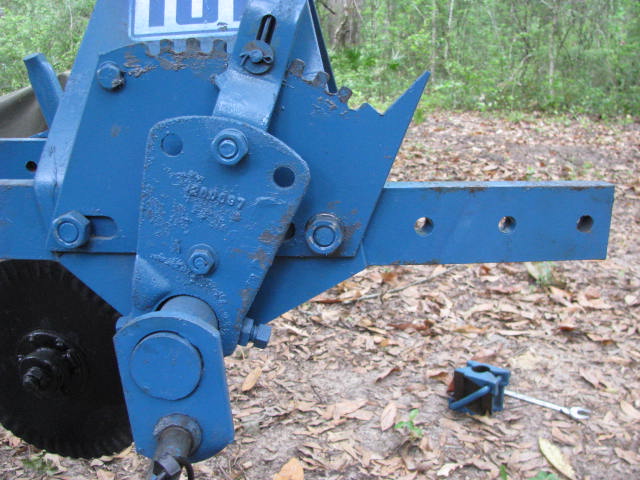

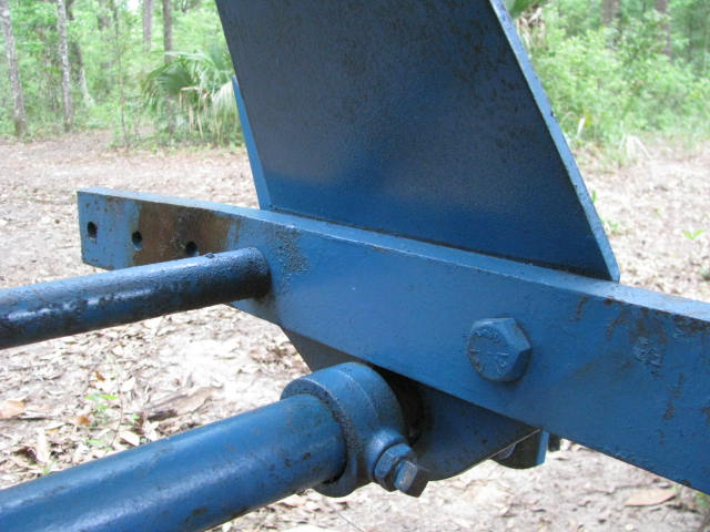

Unfortunately, there is only one set of holes through the First Beam. No adjustment available. Photo #2 is backside of beam in Photo #1.
The holes further forward on the beam are smaller and likely for U-bolt installation for coulter stem mounts, not applicable to the particular Series 101 plow. {See DJ54's helpful New Holland parts post, parts #12 + #13 Ford nomenclature: coulter stem seat.}
THANK YOU, DJ54.
Good suggestion. I am seeking suggestions.

I'll second the motion on the Pat's Easy Change. It will move your atttachment point back four inches, but it will make hookup of your three-point implements much simpler as well.

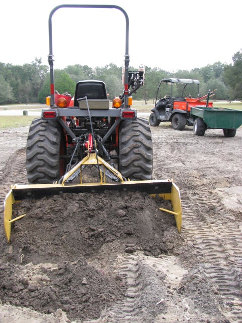

Good suggestion but no banana. I have a set of Pat's EC boxed in the garage. I decided on the Stabilworks pin adjustable stabilizers rather than Pat's because the Stabilwork's mech reinforces the lower links when pushing in reverse. I have a 650 pound Bush Hog (brand) Rollover Box Blade. The first time I PUSHED dirt with it I bent the Kubota turnbuckle check chains, which weigh 4 pounds +/-. The Stabilworks mechs weight 14+ pounds and support both lower links in reverse, not just one. In REVERSE I figure six times more supportive of lower links than Kubota check chains.
Also useful reinforcement when ramming a rotary cutter into the jungle tail wheel first, with tractor in reverse.
VIDEO:
Kubota tractor stabilizers Kubota [url]www.stabilworks.com - YouTube[/url]
I always envied the pin stabilizers on the Kubota "Grand L" series. When someone posted info on Stabilworks I bought and have been happy, especially in reverse.

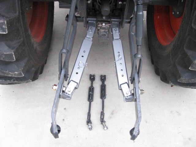

   / Ford Series 101 Plow, 2-12 / Interference Issue With Right Lifting Road / 3-Pt. #10
Do the Stabilworks links interfere with mounting the Pats Easy Change? I wouldn't think so, since the standard PEC attaches to the hitch balls, IIRC.
