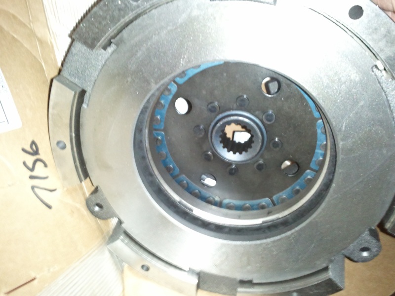

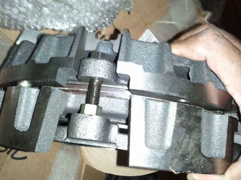

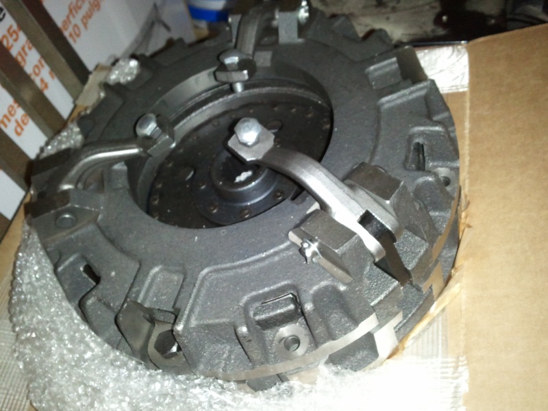

   / Ford/NH 1920 clutch replacement time
The clutch got here along with the throughout bearing. All the rebuilders I called wanted to order parts or take a week to do it.
Got it from Tractorclutchzone.com (and fast too).
Looks like what the book says.
Here goes nothing.

Good information and thanks for sharing:) the disk housing appears to be of some cast material. is it cast Iron by any chance? how is the fit and finish? is there any core charge for your old housing? Do you know if the new housing you have a reman/ cleaned up old one. If you end up splinting the old clutch for a look inside then I'd appreciate if you share some pics. I'm interested in separation of 1st and second clutch disk and common mechanism that engages the clutch and adjustment on it.
