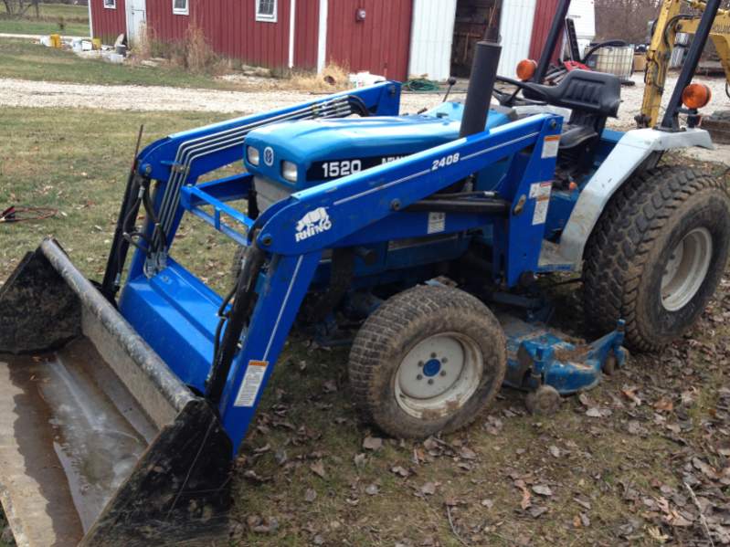

Well, I will be the proud owner of a shiny new (to me) blue tractor on Monday. It has a 60" mid mount mower and a Rhino 2408 loader with it. I am a little worried that the loader is a little big for the tractor though. The factory loader has almost half the capacity this one does. Anybody have any experience with a larger loader on this size tractor? What are your thoughts, should it be ok, or is it pushing it too far? The lift capacity of the loader is 1300 to full height and 2200 breakout.

Front tires come to mind, I have a 1520/7108 loader with all 4 tires loaded and when I move big rocks and am maneuvering my front tires look like they're going to roll right off the rim sometimes in a tight turn. Go slow and keep an eye out
   / Ford/NH 1520 HST/4x4 #4
If your Rhino loader also has a subframe, I would not be worried about stressing the tractor running gear. If it does not have a subframe, your concerns may be valid. Is your tractor the older 1520 or the newer T1520 tractor? The lift capacity for that 2408 loader is around 1300 lb at the pins, but New Holland always rates loaders at 19" forward to more closely represent a loader bucket attached. With that measurement the 2408 has a lift capacity of a bit over 1000 lb, so it is not excessively more than the 7308 in my opinion. It's always good to take it easy with maximum loading, but I would not be terribly worried. I think you've bought a tractor with nice loader and one you will enjoy.

The fact that you are concerned and asked the question means you are on top of this issue. I'm afraid I'm a guy who says if your loader won't lift the load, don't get a bigger loader, but rather get a bigger tractor. I think the Rhino loader is at the top of the capabilities for your tractor. My TC45D with 16LA loader has a subframe mount and only lifts about 1600 lb at the very most. That's a 45 hp tractor that weighs 3500 lb. Lifting a ton or more with an Ag loader takes a very big tractor. Many manufacturers publish numbers at the loader arm pins, and those numbers are just not realistic in the "real world.":)

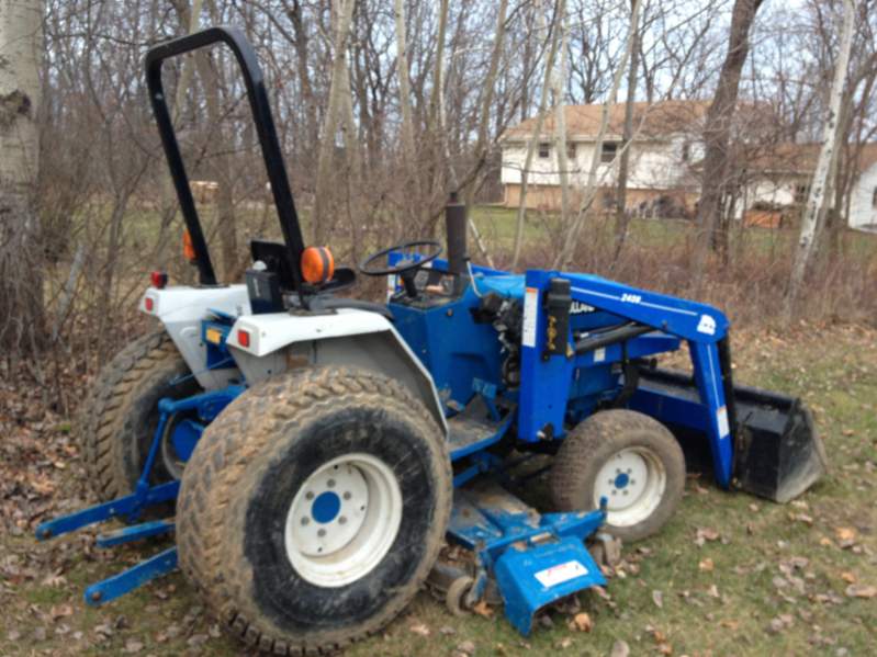

Well, I didn't have enough daylight and forethought to get the serial, but I did drive it around some and used it to grade the drive way with a 7ft rear blade I have for my old Allis WD. Wow was it nice. The Kubota could do it and make it easy on me, but it is hard on the tractor. The Allis can do it just fine, but it doesn't have a real 3pt, so it wanders and doesn't do a good job. This Ford was just right. Pulled it easily, even in 'M', and with the position control it was even easier than the Kubota. Here is a picture I was able to get before loosing light. Maybe I will go out and get it later.

Beautiful tractor!! Check ALL loader mounting bolts by what Ford recommends.
Did you get a manual for it??
