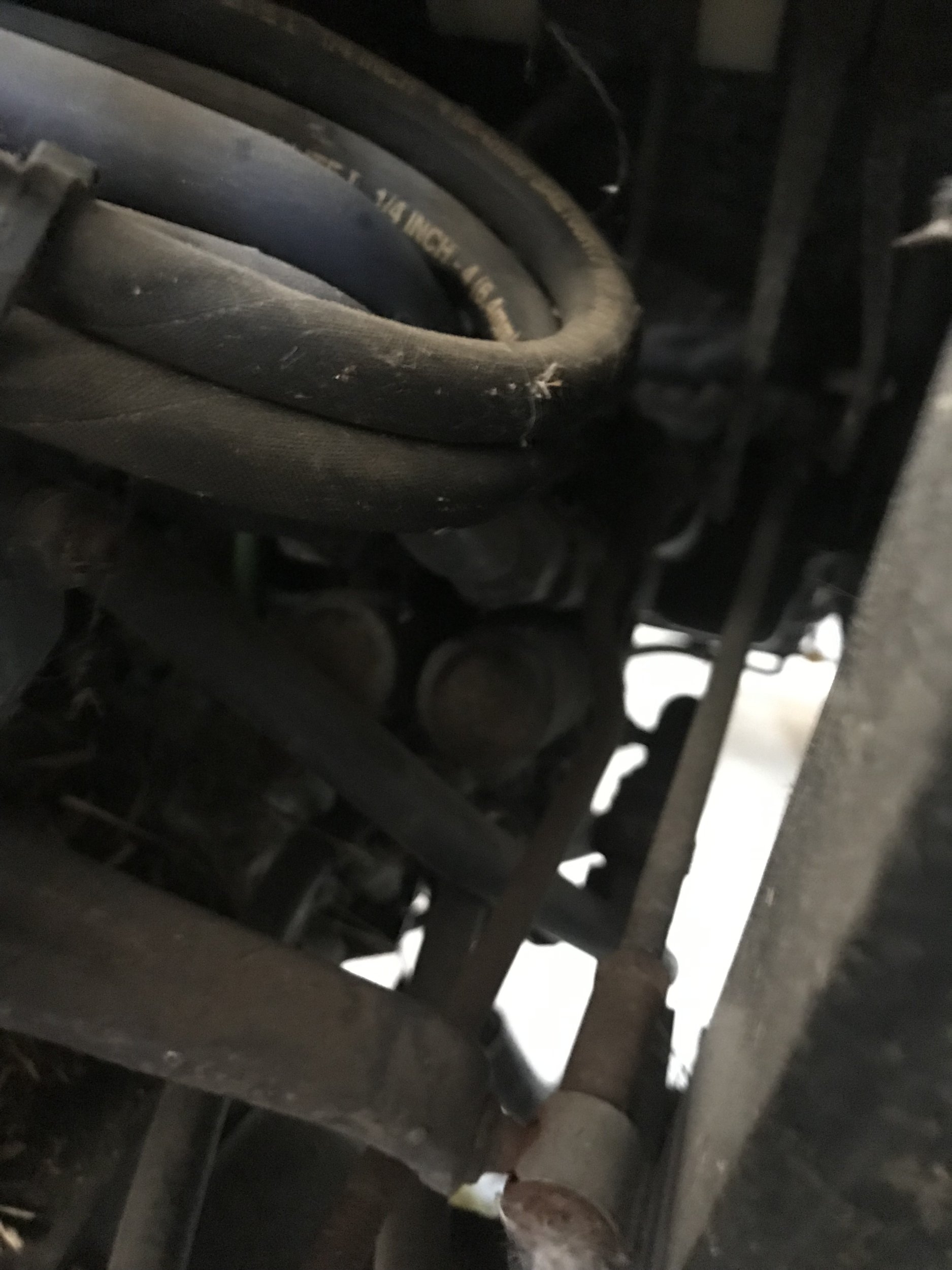

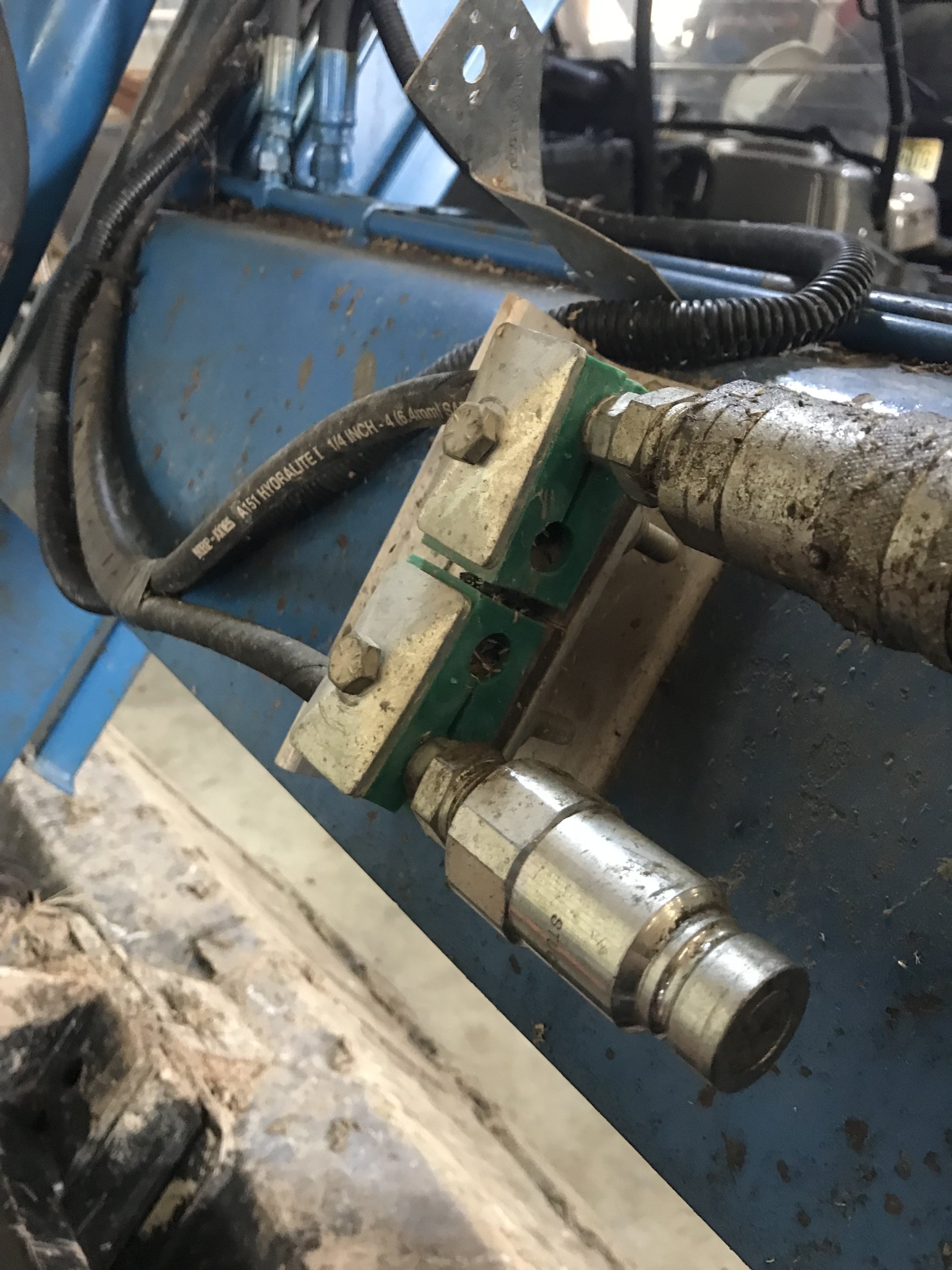

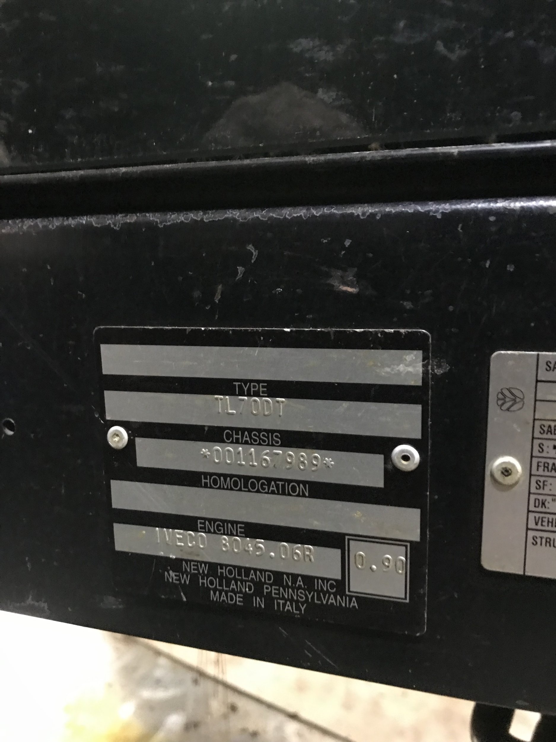

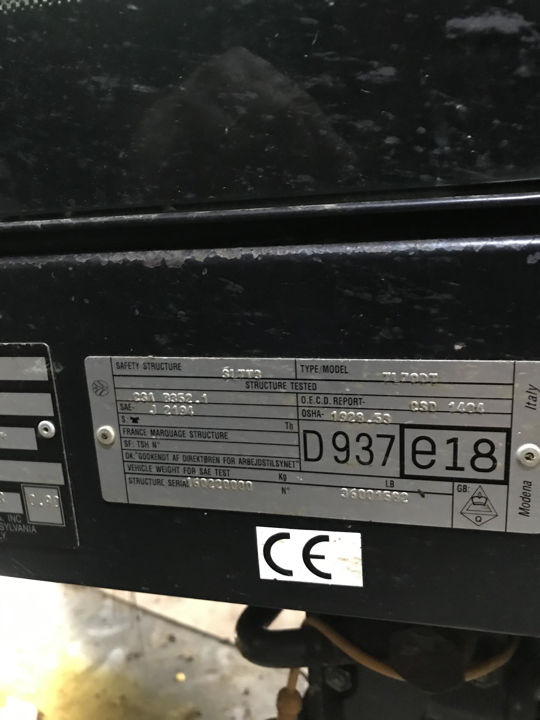

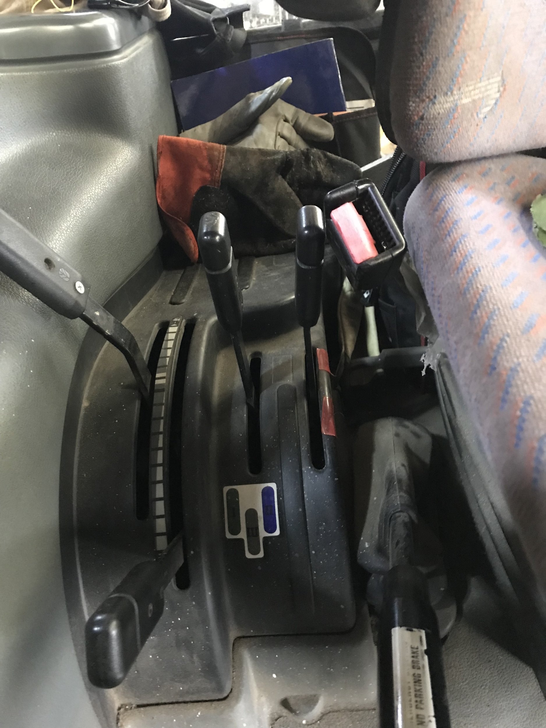

I had this 2000 tractor for 15 years. I use it mainly with a brush hog. Had 1000 hours on it, with a front end loader, but was used hard and needed to sand and repaint hood. It also had engine problems. After sending injector pump out to rebuild, was told pump is good but system is full of algae. now tractor runs good for five years now. It has a factory cab and interior good. I bought a ten foot snow plow, but trouble with cylinders. They move ever so slow. I am not sure what to do because they are double acting cylinders. I read instructions about turning screws, in or out. I am not sure I found them, but are rusty and will not move. Instructions sound so simple they barly metion it. The three point hitch is powerful and so is the loader. I must not know what I am doing. I am attaching some picks. I read the specifications and said you could have one of four different hydraulic pumps. How do I know what I got ? It also has a skid steer quick connect bucket. The plow has two small cylinders. The line is 1/4 inch. I have to hold the remote leave about one minute for any movement. A full stroke is over three minutes. They must be set for single acting, or something else is wrong. I have the loader valve set to max on the valve adjustment. I don't know if that is on the same pump as the remotes ? On of the remote cable adjusters is frozen and was broke. Not sure what position its in. But I am connected to the one that is adjustable. It is as shown in the pic. I turned the other way no different. Thank you for looking. Fred

I don't deal in snow plows so I wouldn't know where to start, other than this one possibility. You say it has small cylinders and small hoses. I'm thinking it may be designed to operate slowly. Possibly has restrictor orifices or fittings designed to reduce oil flow to a minimum just for that purpose. I would strip the hoses and fittings from some of those cylinders and examine all of them looking for that.

What I need is a explanition of how to change between a single acting cylinder to a double acting cylinder. I would also like to know what pump my tractor has. In terms of gallons per minute of flow. The valve itself, is in a difficult spot. I don't know where the pump is. They have so many versions of this tractor, the parts diagrams are endless. That is why I posted the name plate. Maybe someone here knows how to read it .

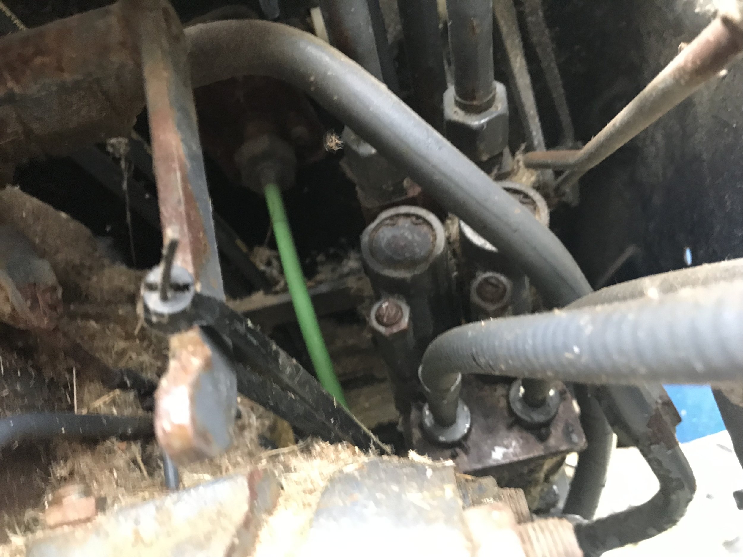

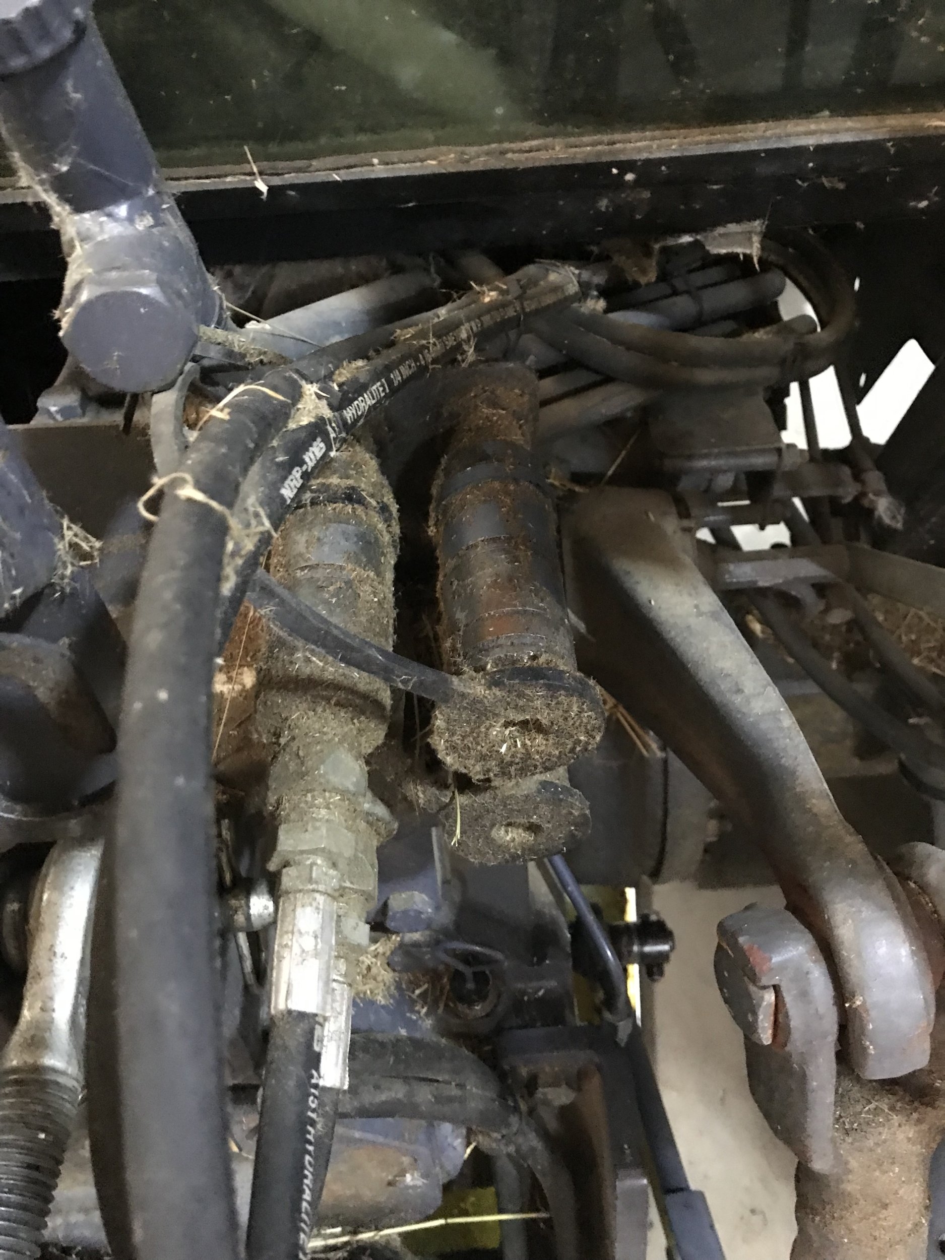

The owners manual reads they are adjustable. It has a very poor illustration showing the location, that I can not make out. Than to top it off it mentions a screw adjustment for a detent setting "end of travel". It is metioned so briefly, like everyone should be familiar with it. Every since I owned the tractor, it's been keep indoors. But it was outside for many years prior. I found the adjuster screws (for end of travel) on the remote valve, but they will not turn in or out. I used liquid wrench no dice. They have a nut around them, maybe a lock nut. I have a plow for my truck, but would be nice to get the one on the tractor to work. Thank you.

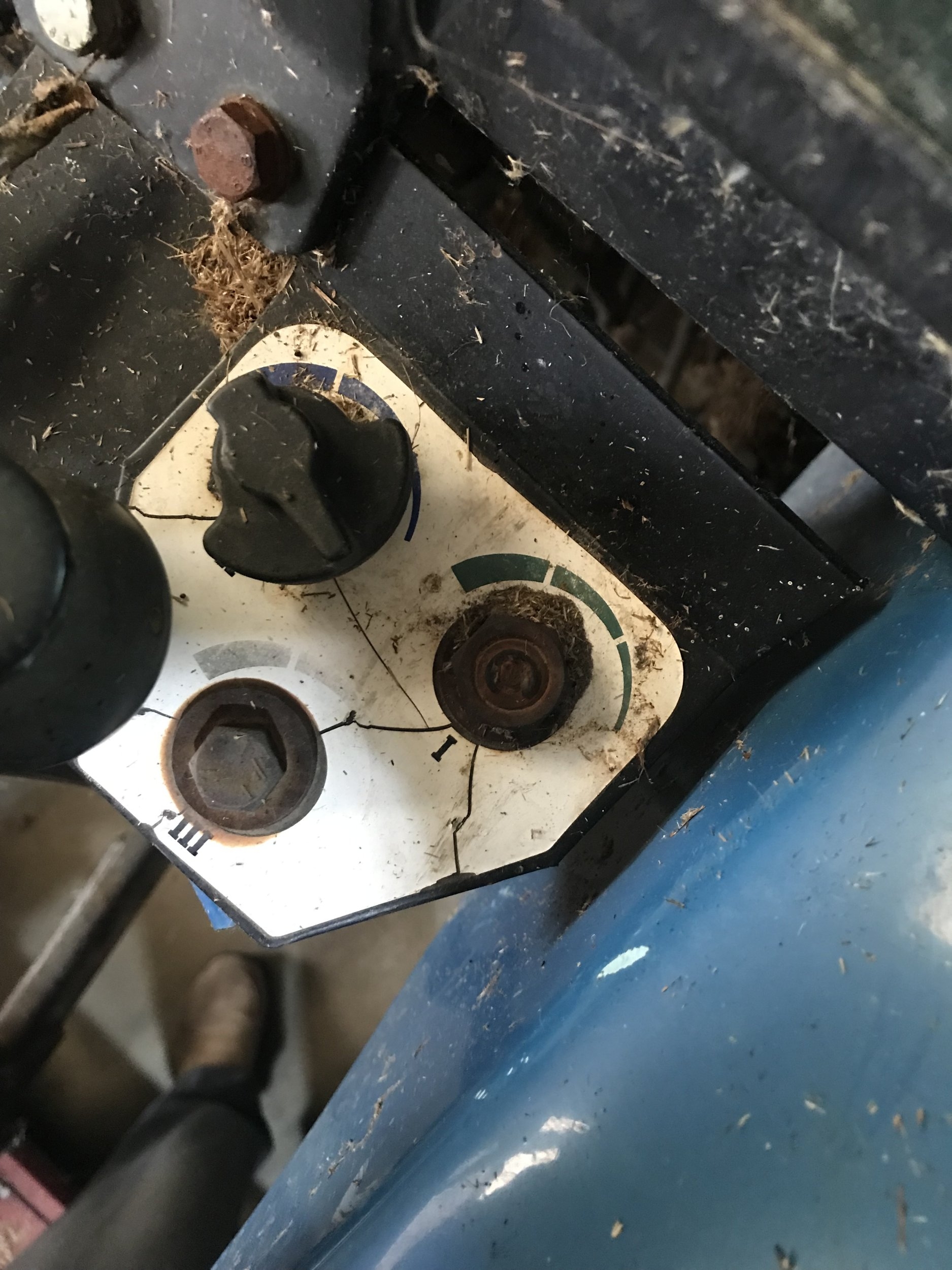

I took several more pictures of the back of the valves. Maybe the nut around the screw turns. However in the book it says the screw is for "end of travel". They are in a bad spot. I tried a 3-foot long flat screw driver nothing moved. I could get a socket on the nut, but have no idea what I am doing.
