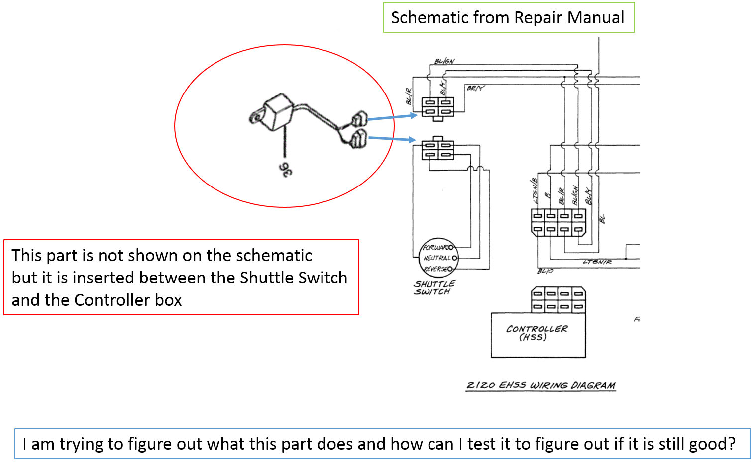

I have a 2001 Ford/New Holland 2120 with EHSS that is giving me intermittent neutral problems.
I have traced all the wiring and came across a mysterious small black plastic box that is in between the shuttle shifting switch and the EHSS controller box.
I can not find this box on any schematic that I have but I did find it on the parts diagram.
It is part number 36 on this diagram: New Holland 212 - 4 CYL COMPACT TRACTOR 2 SERIES(1/87 - 12/2) Parts Diagrams
A search of the web says that it is an "Amperage Controller".
The part number is 47837495 and the original part number is SBA385870820.
Does anyone know what this box does and how to test it to see if it is still good?
   / Ford/New Holland 2120 w/EHSS. Does anyone know what the Amperage Controller box does?
#2

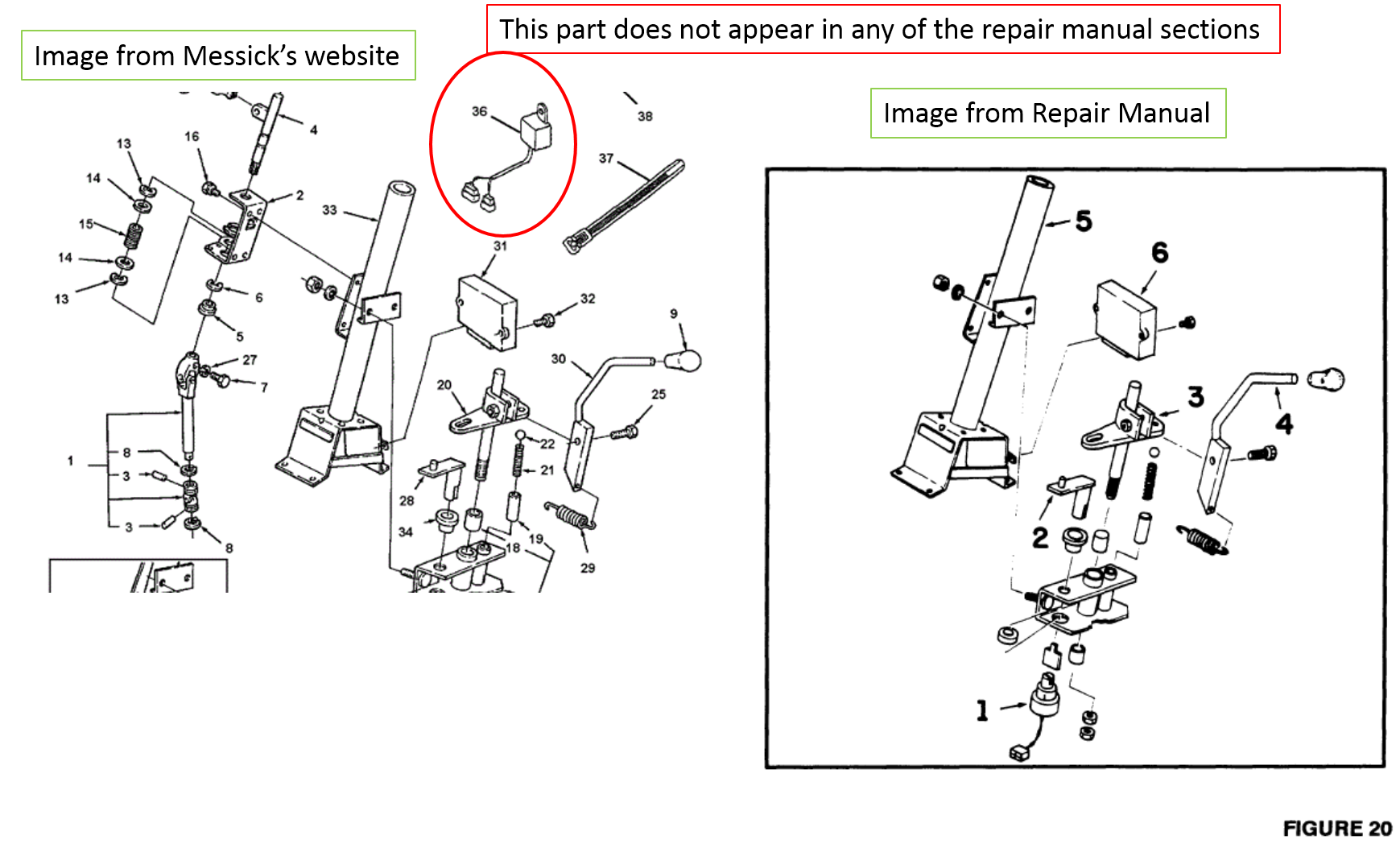

I put together a few figures that illustrate the part physical location and it's location on the schematic if it helps anyone to identify it's function and figure out how to test it.
NH 2120 Amperage Controller location.pngNH 2120 Amperage Controller on schematic.png
Thanks in advance.

Even factory manuals of different years printed may not show updates 100% or may not edit details completely between part # lists, text, & pics when revised. (I have such, all NH Shibaura) I & T FO-46 only shows schematic for 2120 gear vs shuttle, so no help there. :(
Second pic seems to show the piece bridging vs replacing a 4-prong connection or bit of wire, say as if added later in response to switch failure in early models. I suspect a current limiting diode might be an update that just isn't represented where we seek it. Connecting wouldn't match the pics.
Got a pic of the placement and where it connects? Diodes are typically tested with a VOM for current flow. (HFT <$10, etc.) Function may be as simple but form-factor may disguise more than a single component within, but the test should be valid either way. There rare exceptions to that but moot if the part tests ok.
It's on a common line thru' the switch and going to the shift control valve. It could be there so soften inrush current for its sake when switching modes. btw a zener diode might be used to limit voltage but amperage was mentioned. That and using a diode to limit current is just new to me. :rolleyes:

A local New Holland dealer helped me obtain the tech sheet on this part. It appears to be a pair of 240 Ohm resistors to ground from the Forward and Reverse signal wires.
For reference, and in case it helps someone else, I have put together this tech sheet and the pictures in this attachment.
View attachment Amperage Controller.pdf
