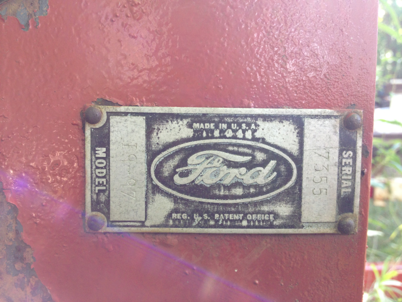

Hello I have been in the market for a Ford Loader to mount on my 68' 2000. I found one but not sure if it will fit. The model number on the tag says I9-97 and the serial number is 7355 I think it might be a 703 Loader. The tractor this is mounted on is a 50"s ford 861 power master, I believe. The question I have is, will this mount on my 2000?

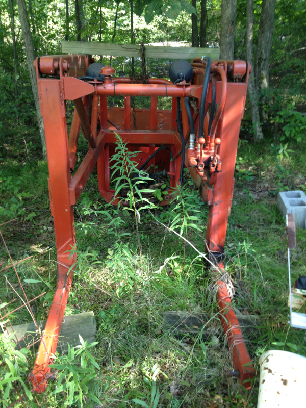

Here is the actual Loader

yes it will fit
but you might have to get a different pump drive shaft i cant remeber

I'm not questioning your knowledge, but how do you know it will fit? Do you have a loader like this mounted, or have seen one on a 2000? I know you can make anything work with torches and welder. I'm trying to get something that doesn't make me pull my hair out to install!!
   / Ford Loader #6
since that loader is for a 00 series machine.. the brackets will be different. he'll have to torch / weld to get it fit..
.. same loader as a 19-105 but with da cyls...
a 730 will be more geared for his 3 cyl....
