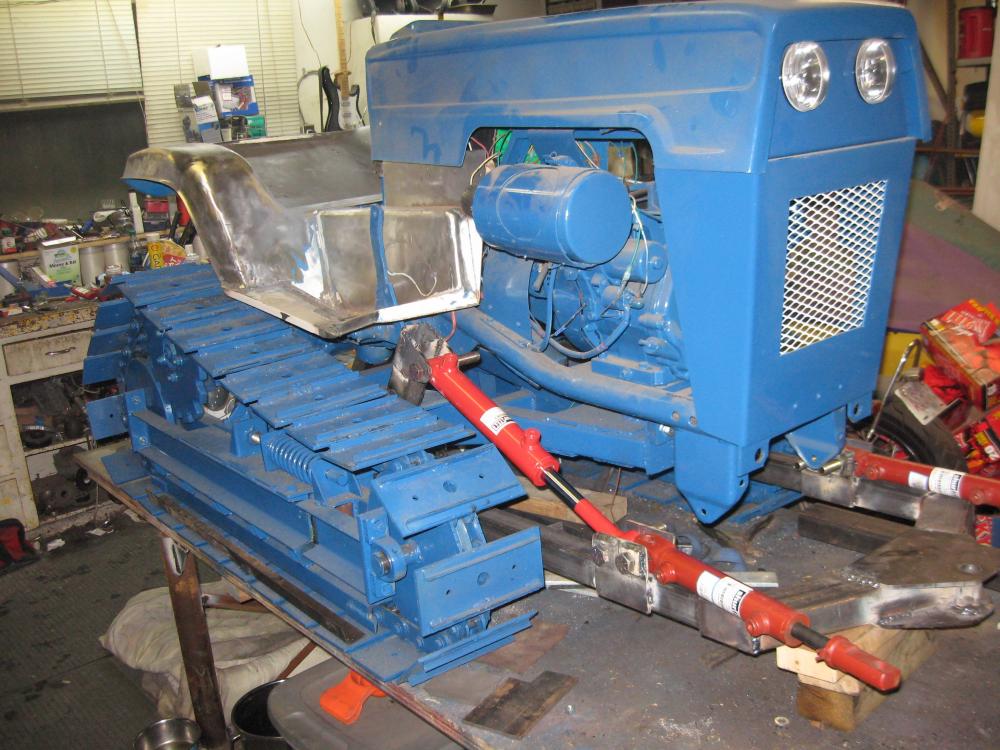

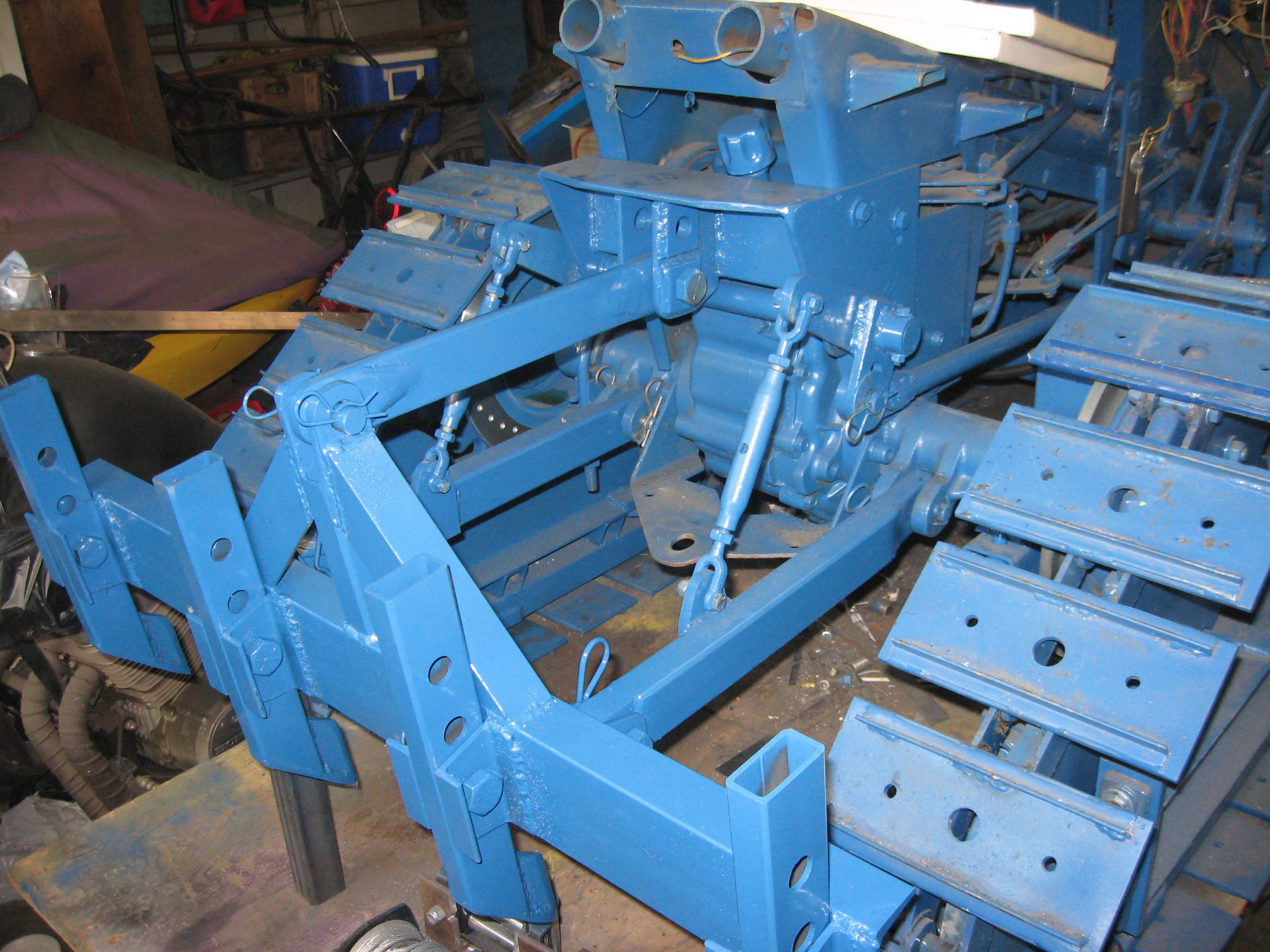

Down off the table. went down the ramps in a very controlled fashion. No scary moments. I regret not moving the brake pedal to the other side earlier, it's in an awkward spot. Moves Forward at a brisk pace. Reverse is harder because the linkage is still out of whack a bit. Haven't tried to push anything with it yet, That will take time, need to move everything (boat, tractor, dirt bike, dirt bike, tractor, tractor barbecue) to get it in the yard. Also I have to put my bike up on the table, I have a new seat coming and the clutch is stuck.
It howls while turning, more left than right. I know the transaxle needs work, I'm in the market for a Peerless 2500/Eaton 11 combo I can rebuild..
I need stronger brake levers. the 1/2" rods tend to bend too much. It turns fine, no indication of the tracks trying to jump off.
It has a nice controllable feel when it goes over center.
Once I remember how to get vids off of the camcorder, I'll upload the vid I did of it crawling down.
Small embareassment, apparently, I was too excited about hopping on and driving, I didn't notice the rippers had hooked the bottom of the ramp coming down. I dragged the ramps and table 6 feet out the door, I didn't even notice it pulling.

I picked up another transaxle and checked it out thoroughly. I had to replace two bearings and two seals on the axles. Everything in it looks good.
As soon as I can get some time, I'll swap out the transaxle and hydro pump

My original transaxle was in pretty rough shape. The left side gears in the differential are piled up and it needs a lot of bearings and seals. It worked great as a wheeled tractor, but binds up on left turns

I've got the new transaxle in, and am getting the brakes set up. I still need to cope with the leaky fuel tank.

Summer was a panic of trying to get other things done. Unfortunately, due to circumstances, not everything got done.
However, I did get to run the dozer a bit.
It performed pretty well all things considered. A couple of things broke from vibration, but it showed good pushing power.
Turning still takes a lot of effort, so I'm thinking I'll have to get some master cylinders for it. I also need to fix the two headlight brackets and air filter and the rear lift cylinder still leaks. I ill also have to slow down the hydraulics, fine control is quite difficult.
