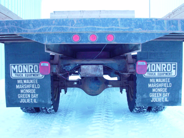

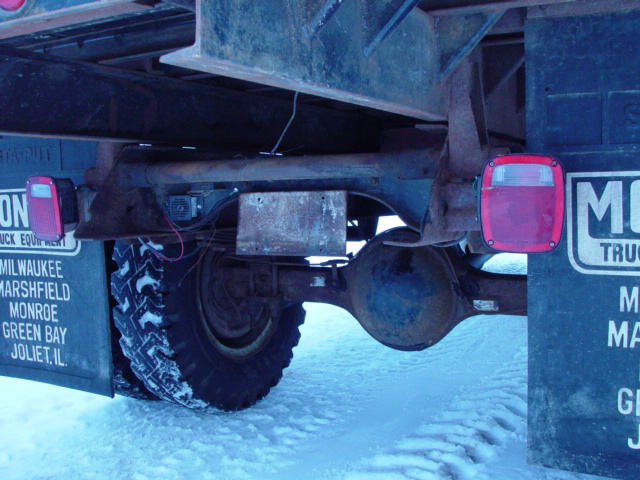

On the sticker by the door the GVR is listed at 16,500lbs with the front axle at 5500, and the rear axle at 11,000LBs. The engine is a 370HP 2V8 with hydraulic's for a plow up front and a hydraulic's RAM for the dump trailer under the bed that is at least 16K. It does not have any hitch on it but this is what I would like to add. If the load is under 26,000 LBs for a combined load I believe no CDL is necessary. I called the local FORD dealer and they could not enter the VIN number in their computer given the age and had no paper details for a 1983. Wasn't able to weigh it but it has to be at least 8,000 lbs or more so I am hoping it would be capable and able to pull a 16K trailer? I have attached two pictures of the back of the truck. Thoughts?

If it is for Commercial use that truck and trailer WILL require a CDL class A. The truck alone would not require anything more than a class D.
